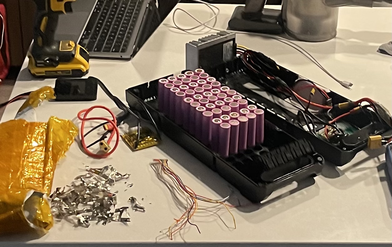

I returned from sea to find your ride and charge had expired. it’s last words were “17.4v”.
Likely Cause of death, smart switch failed on, resulting in slow drain by adjacent buck-converters and watt meter.
We can make arrangements to return the remains to Portland when you are done grieving.
lol, jkjk, I opened it up to steal a few cells to mutilate with the new kweld, then I’m going to bestbuy to recycle a few at a time, Shawshank Redemption style.

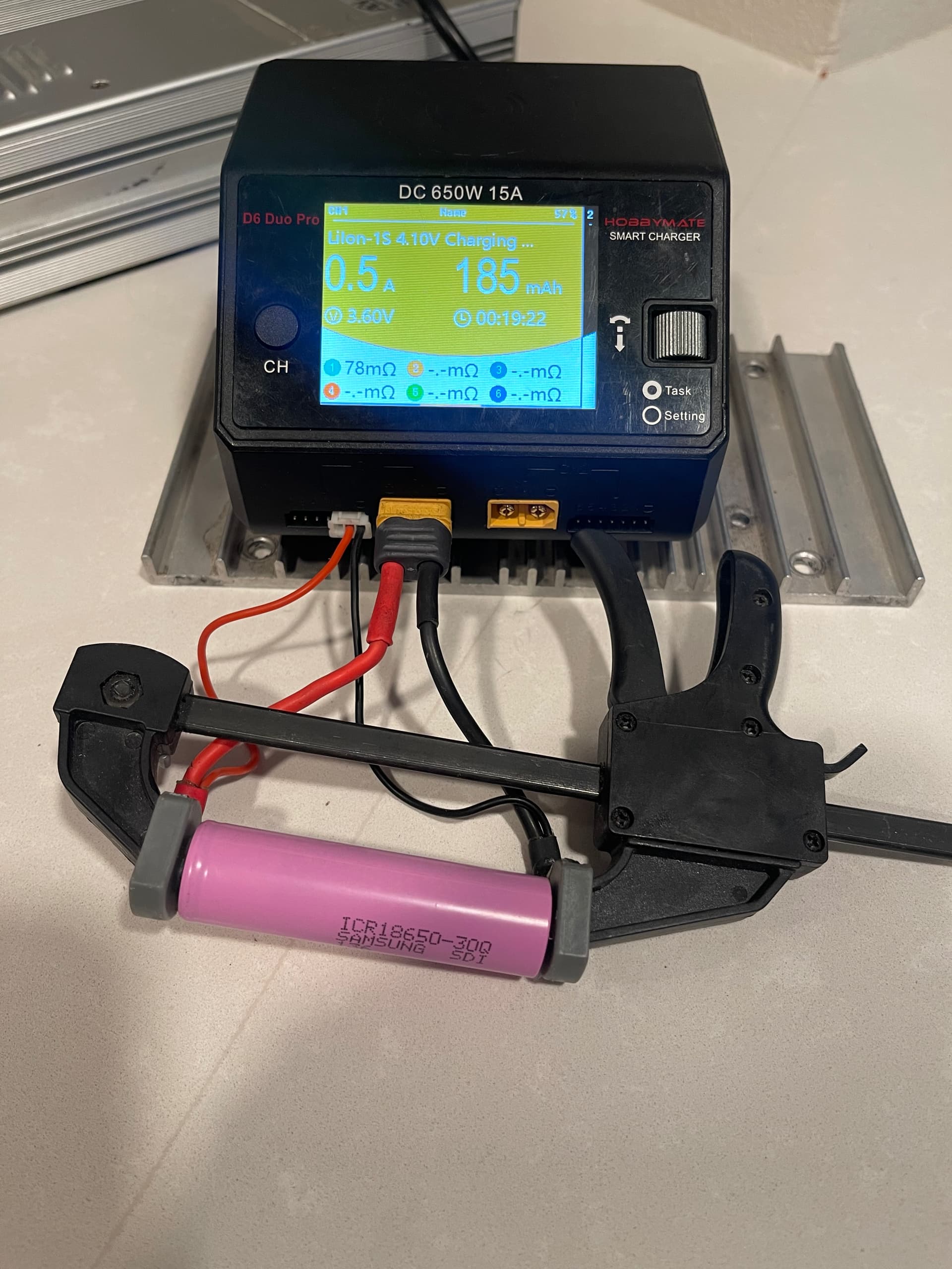

Well, 10 cells technically weren’t dead. All at 3.2v. I’ll make a 10s1p usb charger for shits and gigs. A “pocket bomb” if you will.
