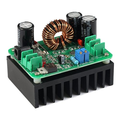

@DerelictRobot the solar charge controller PCB sleeps on in storage. For now, golf cart style 48v to 12v step downs does the conversion work to make a decent 12v output.
I assume that is a 7210A without the metal?
Thanks @Fosterqc i was already planning to convert my backpack into a mobile charge station and this thread was super helpful! Ill be going back here for more info many many times.
My plan is to have a dc-dc converter, or maybe a few if need be, with an xt90 input and several outputs at varying amps with all the common charge ports and maybe a usb and a type c output as well, built into one or more boxes spread around and sewed into my pack. Then, i can use most packs as a backpack range extension, plus charge other devices on the fly, or make adapters for any batteries i cant use… it just sounds great to have a mobile electron directing station. And when my mtb is done i can just detach its peli case and throw it in my bag to extend my street boards range. Theres no downside.
No idea, I bought it as 600W booster, almost like this one but not quite the same
US $11.59 40% Off | DC/DC Boost Converter 10-60V to 12-80V Step-up Voltage Regulator 600W Auto Power Supply Transformer Adjustable Output Volt Contr
