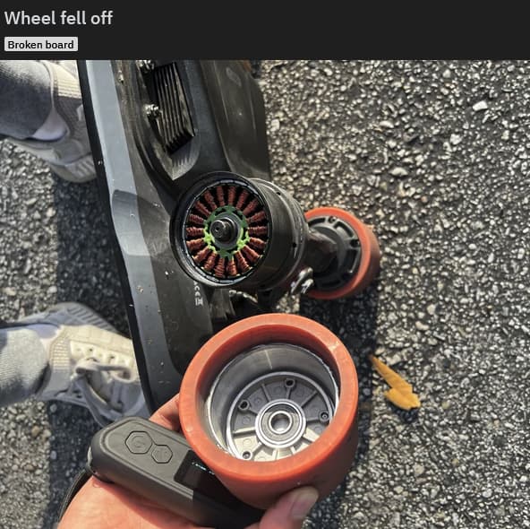

Saw this on Reddit about the Meepo v5 Motor sleeves falling off. There doesn’t seem to be any proper way the sleeves are attached to the Motor
More examples from other reddit posts
Timestamped
What in the actual fuck

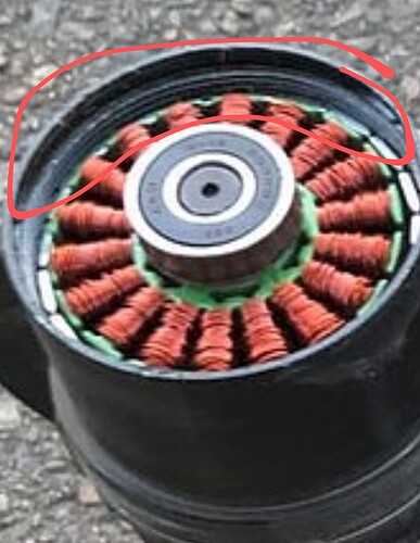

I’ve spent too long looking at this picture and not enough time looking at the product but are these threads?
And then this bit screws on to it?
Screenshot_20230515_130012
Someone else mentioned the sleeve threading on. There also appears to be Glue at play
grafik
Ahh that one fully separated from the sleeve core adapter part. Yikes

It is threads, yes.
This plate has threads
grafik
which threads onto this
like that
grafik
then the sleeve goes over top
grafik
grafik
and bolts onto the silver plate from before.
So nothing but threads holds the sleeve into place.
Accelerating loosens the sleeve and braking tightens the sleeve*
I think this is only on one side, it’s inverted on the other side. I think I saw that prerelease video on the Mini a while back and he said there was an absence of loctite but the orientation of the threads seems more likely
