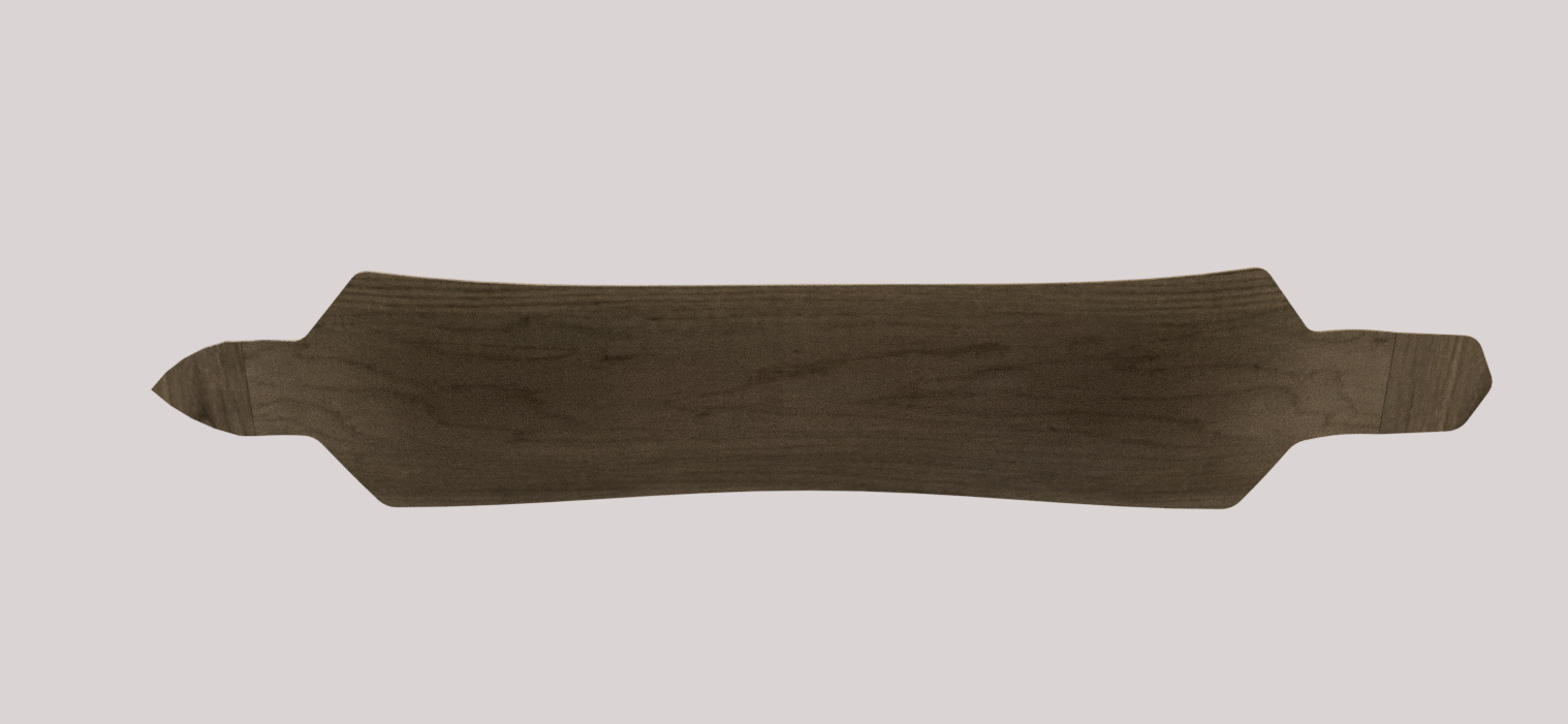

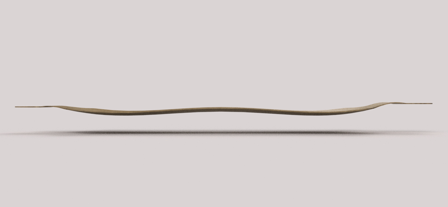

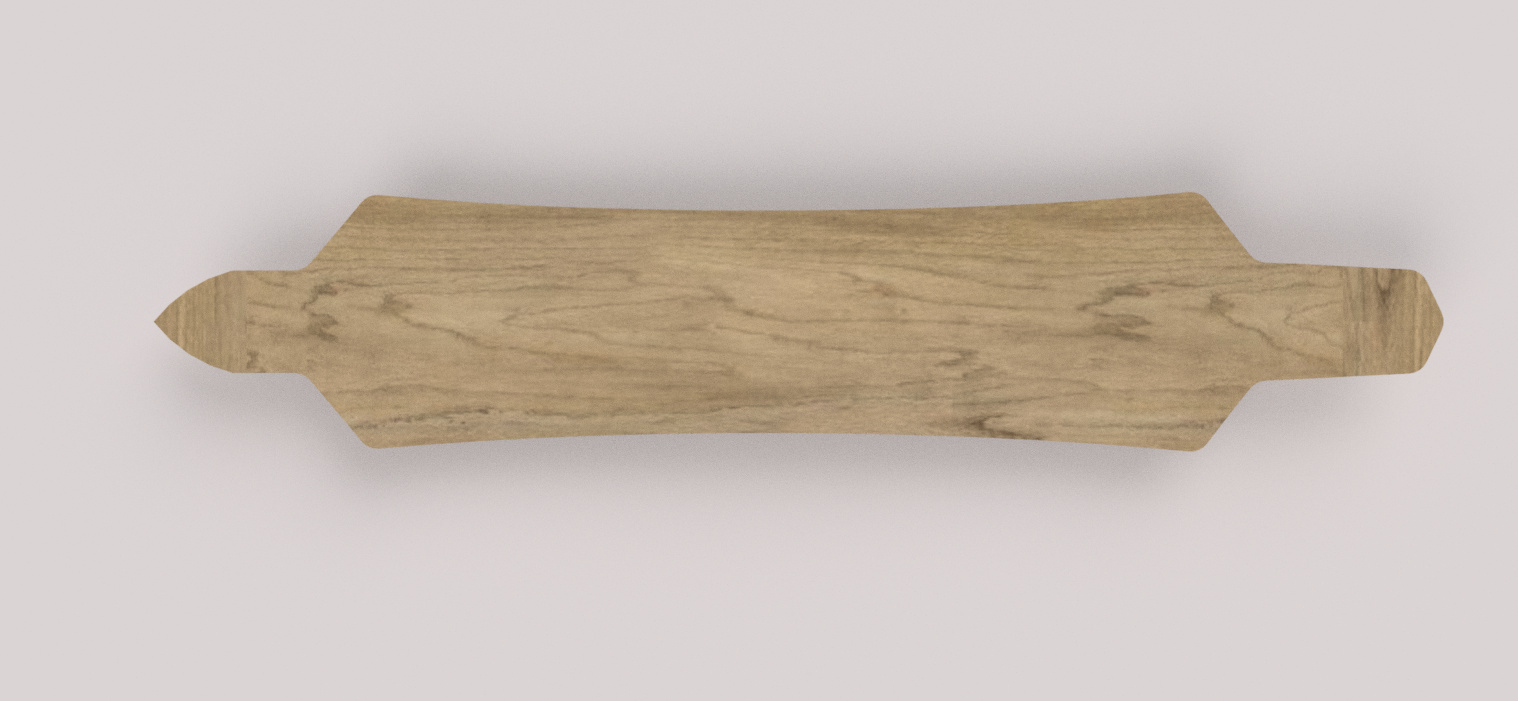

hey nacho, think about this… I need a mold CNC routed to press board decks against. The deck:
nominal dimensions for the mold 48" long 12" wide minimum 2" thick
If you’re interested in the project and can give me bro pricing sling me a PM I’ll probably be able to give you a complete CAD file at the end of the month…
what file format does your CNC router prefer?
Yeh I should be able to do it. New larger format CNC is almost done being built. Bro pricing as always .
File wise, a step file is the best

koolio… let me know when your router will be ready for prime time, and Show us an actual part your router can produce on complex shapes, especially surface quality!
This mold will be a One off part probably, but if I decide on producing this deck I’m going to need say 10x or more of the high-density foam core and stiffening spars…
Note: this is mostly for science, and not a money-making endeavor, so I’ll definitely need BRO pricing!!
Maybe we can work out a deal where if’n when I go into production you can get a percentage of the sale… you know entrepreneurship and all that!!
