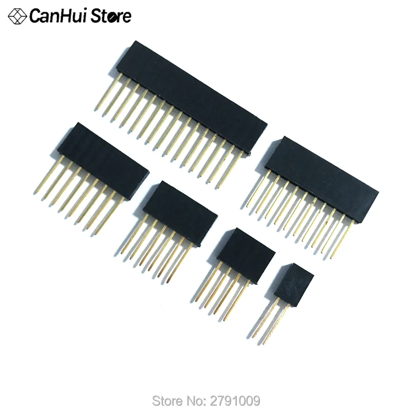

  • Some pins to stack under the interface module (2x 8p on each side). This makes the screen pop higher then the heat sink. Makes it easy to design an enclosure for it.
