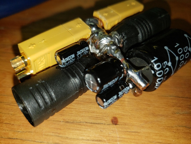

Anyone tried adding a capacitor bank between the ESC and the battery?
Seems like it would help with the “burst” requirements and can keep the battery under load.
Although it seemed to do absolutionly nothing for RC wonder if it would help with hard braking/acceleration for esk8

I use cap banks on everything. Seems to help with overcurrent faults when plagued with them :man_shrugging:t2:, but they aren’t a silver bullet… just nice to know the ESCs are probably getting cleaner power when running long battery wires.

2 out of 3 builds with ABS over current faults, disappeared completely with added caps. Came right back when caps were removed. :man_shrugging:t2: Bad or overloaded ESC caps is my guess?
Inductive currents from the creation and collapse of EM fields in the wires themselves as current constantly fluctuates when we accelerate/decelerate from what I understand ?
I am not an EE, but this is basically what I gather from my reading and found caps to help eliminate the problem in some cases. Best to keep your battery wires tight together to cancel out the EM fields that cause inductive current spikes, conventional wisdom… those 2 builds that had this issue, I had the main battery wires on the opposite sides of the enclosure, and each were like 3 feet long :man_facepalming:t2:

I am an ee though power is not my speciality. You’re not wrong about fluctuations but it’s not really the acceleration fluctuations that these caps are flattening. The scales are just too different. The capacitor isn’t going to make up for battery sag. No way , no how.
But I can definitely see how the caps can help against inductances. The inductance in those wires is maybe in the tens of nF range so that’s within reason for the caps to flatten.
Either way I’m not gonna argue with reality lol. If it works for you then good! I’d be curious to really learn why. My bet is the inductance thing.
