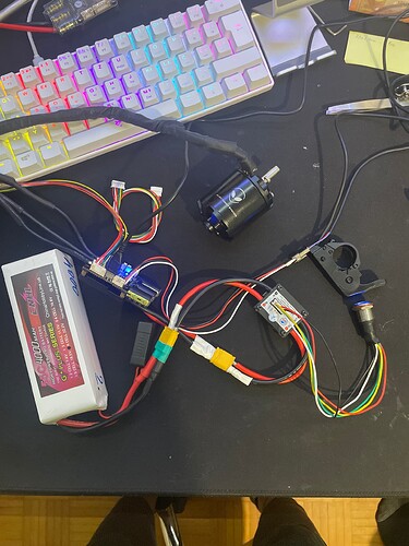

can’t setup the throttle input, vesc tool doesn’t reed the throttle
need a little help here,
i have a throttle and i want to control the vesc with it, when I want to setup the input in vesc tool, i chosed ADC input, and when I pressed the throttle the reedings were always the same, nothing changed, am I missing something here?
I have checked with volt meter and signal from the throttle is for min voltage 0,9V and for max 4,2V, but again in the vesc tool i just can’t get any signal readings.
It looks like you’re connected to the PWM input. Try connecting to the ADC1 input using a 7 pin JST PH connector. But before that, make sure the voltage coming from that throttle doesn’t exceed 3.3V with the throttle in any position. It should not be 5V, or you may need a resistor divider.
VESC mislabels PWM as “PPM”
