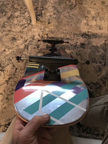

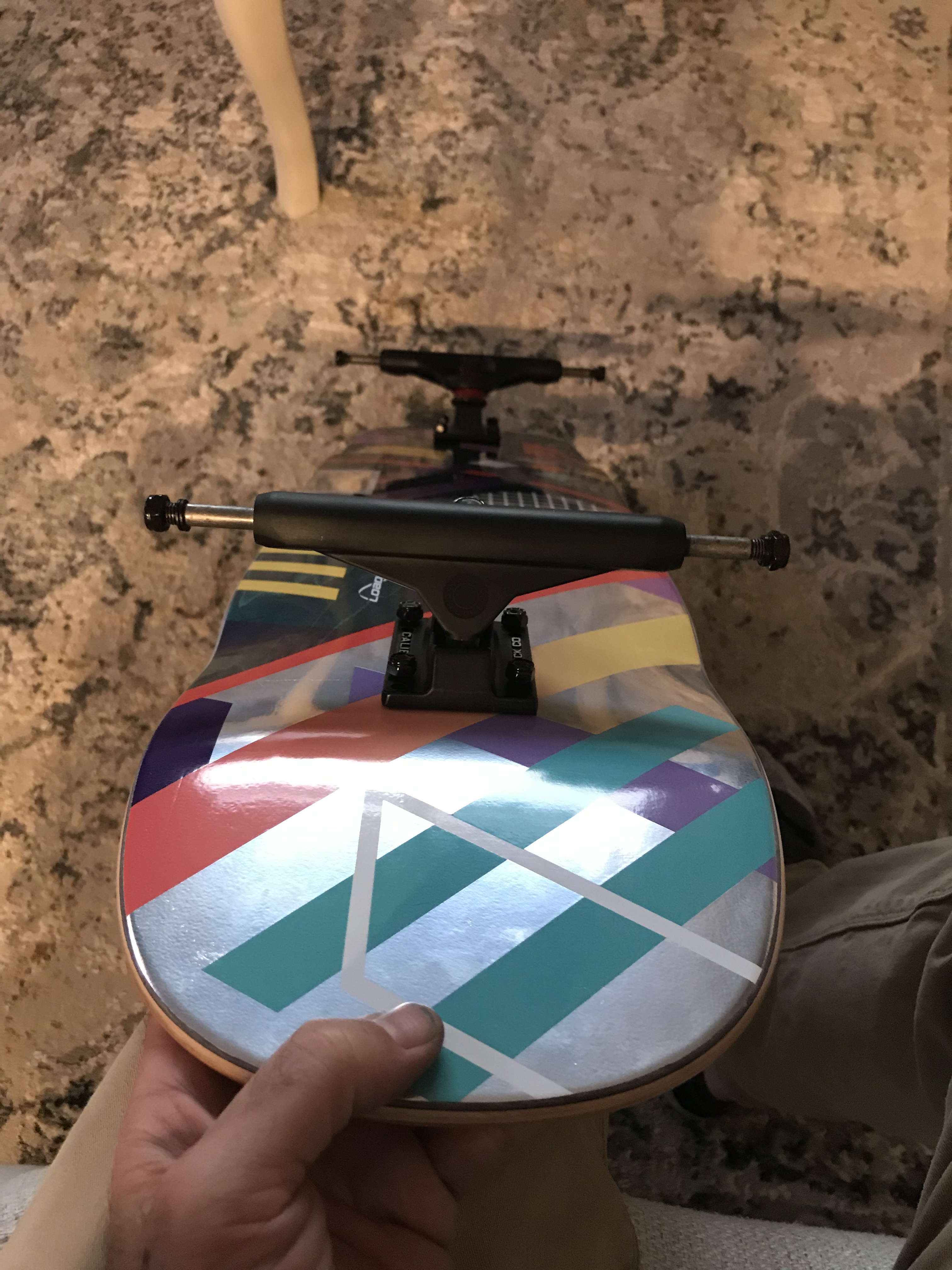

Do caliber ii mounts fit on gen 1 trucks?
Reason I ask is I would like 148mm (8.5”) trucks and can only seem to find gen 1 in that size. I was looking at SR tkp but I’m a cheap bastard and would like to spend 50 on trucks instead of 200.
Thinking about these
https://www.muirskate.com/longboard/trucks/70268/148mm-caliber-standard-blackout-8-5-axle-skateboard-truck
This is for my new coyote deck build single drive, trying to keep it compact

Caliber I and II have a similar profile shape. You can use Caliber II mounts on them
Is there any negatives about caliber 1 trucks? Keeping in mind I know they are tkp (I want this) and more narrow (less stable at speeds)
Ah apologies, the Caliber I I’m talking about is a RKP, almost similar to Caliber II, which was why I suggested that. If you are going for a TKP build, you will need a custom motor mount. Perhaps @Janux-esk8 can help with that. He has quite a line up of many different mounts for many trucks.
I think @b264 has a board with tkp caliber truck.

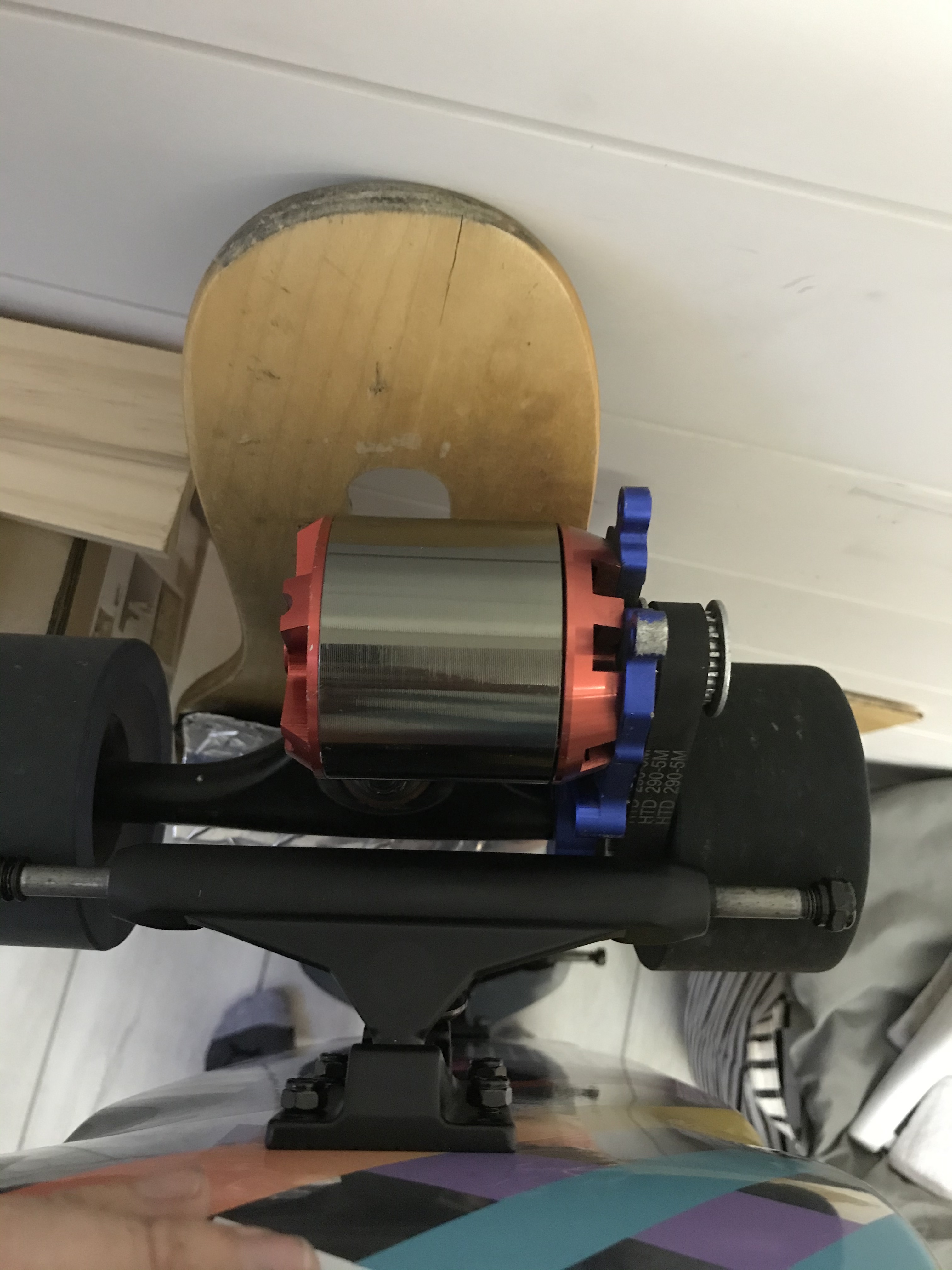

Decided to give them a shot, there will be some filing needed for sure to get clearance for the mount and pulley. I just hope there’s enough room for my maytech
Edit, shouldn’t be a problem
