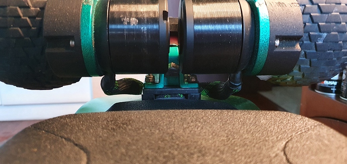

I was just wondering if I should get cable riser pads. They would make my build look cleaner however I don’t know if my wires would fit.
Their are 4 wires from a FS6354. I’m planning on shrink wrapping all of it together for water proofing and looks. Also, the motor wires aren’t long enough to make it all the way around to the esc. I’ll need to connect the phase wires (maybe the sensor) outside of the enclosure. Possibly in the riser.

If you’re using riptides one, it’ll fit. This one is using dual 6354s as well

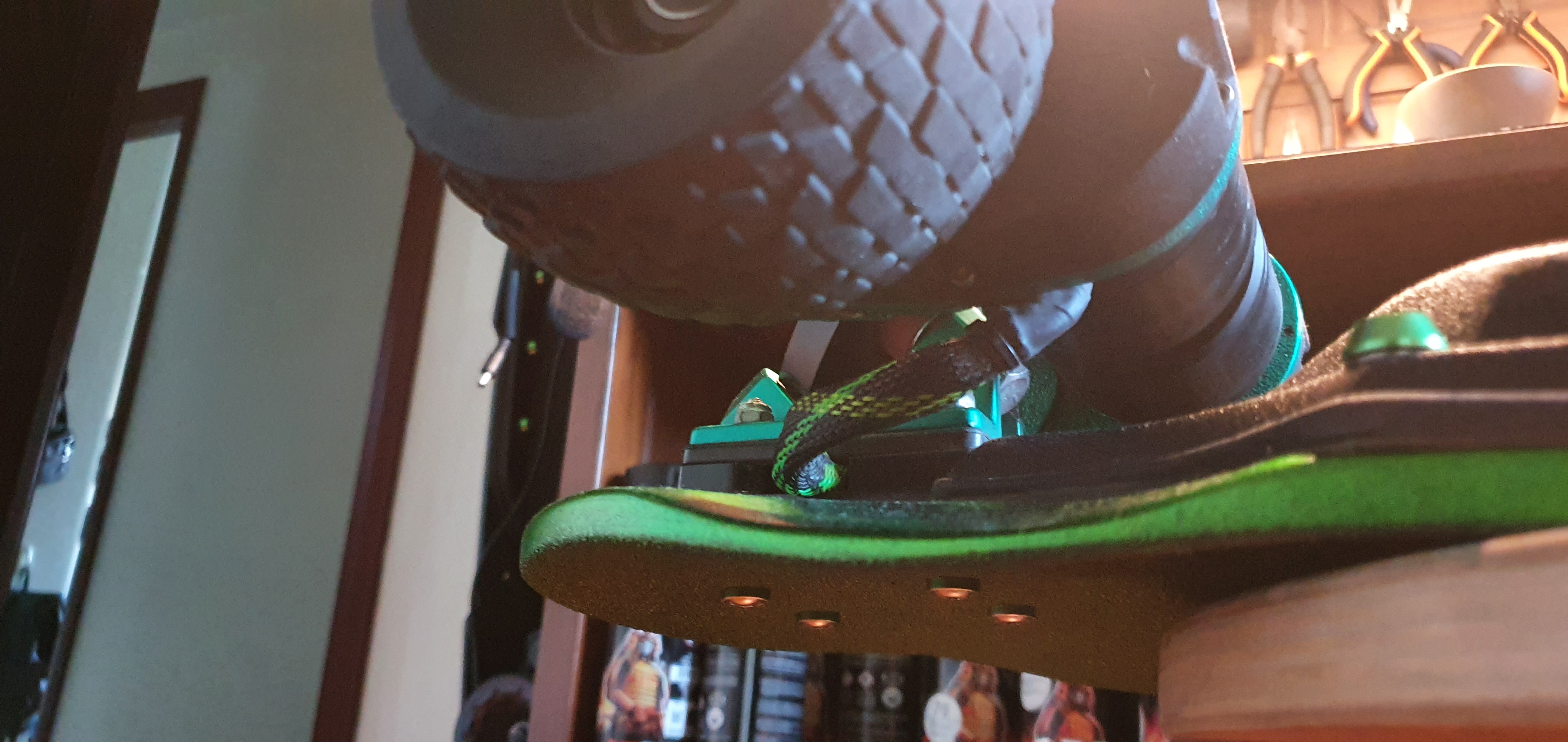

Can you take a pic of the other side
Ok thanks, are they worth it you think?
Definitely, it holds the wires in position and will have zero chance of motors rubbing on your wires, go for it. I have three builds using tunnel risers.
