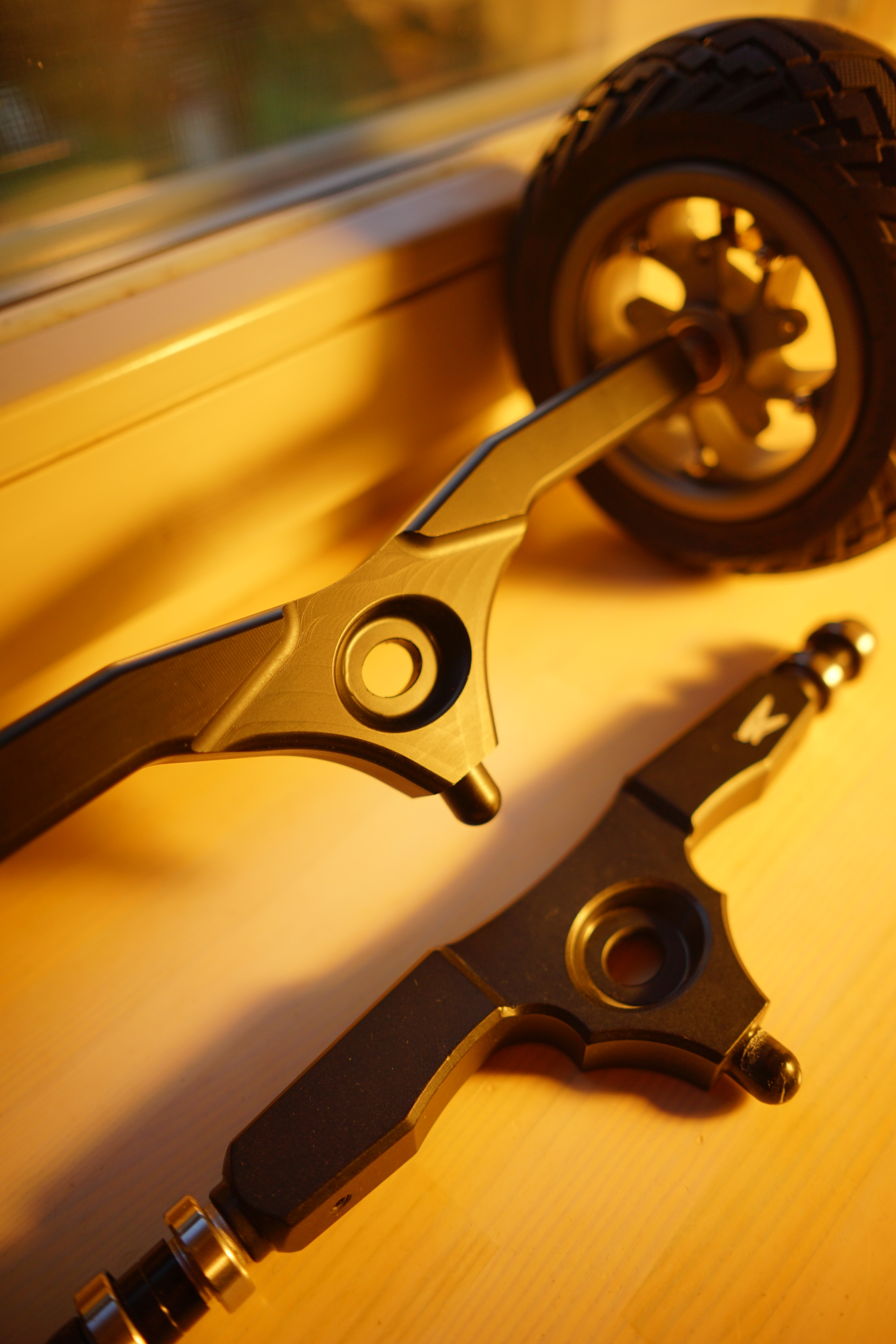

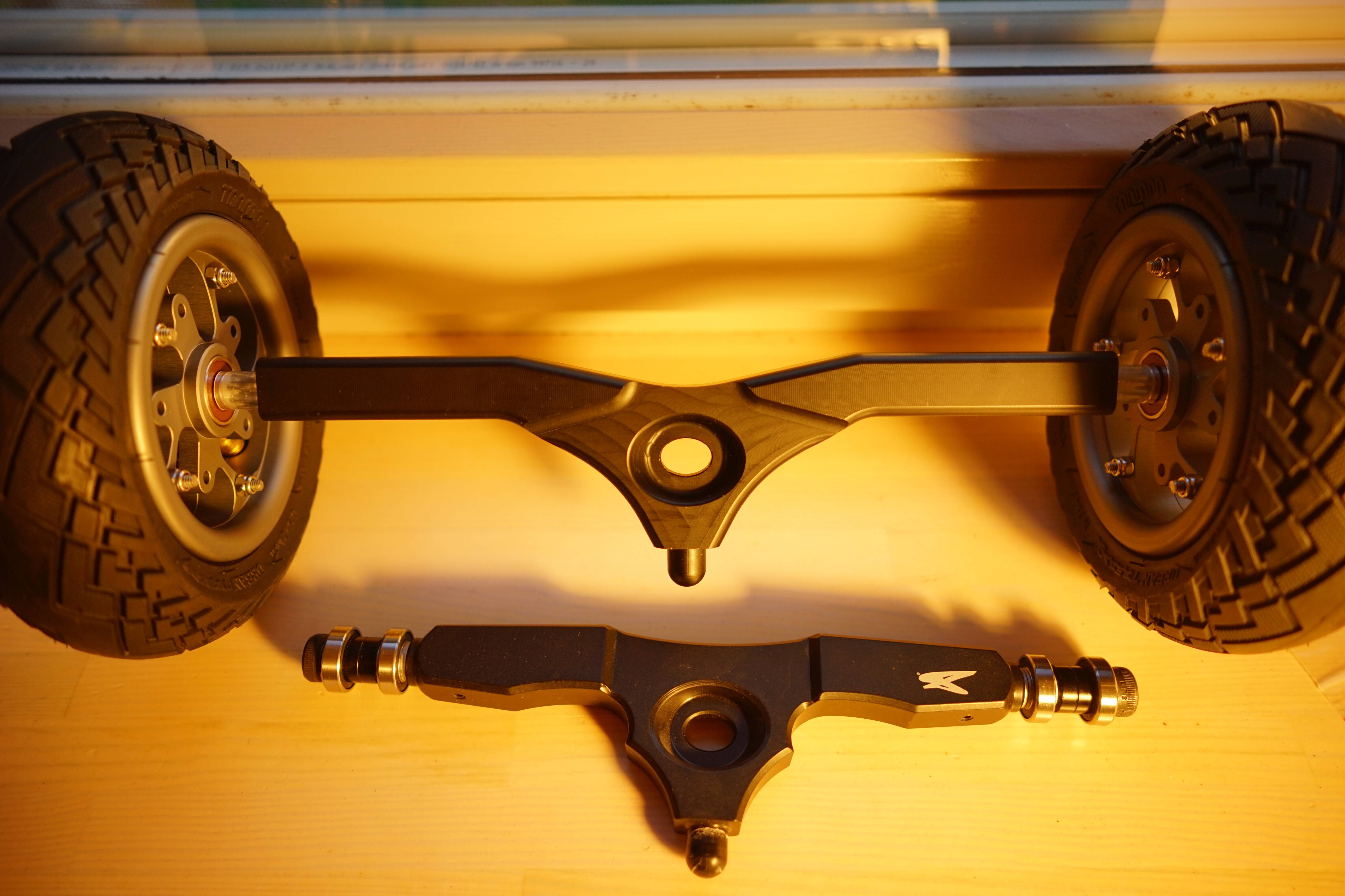

On my current setup with them I have a fatcone and barrel in the back which deal with the too-narrow opening fine because they’re cranked down quite a bit, but at the front I’m using double cones the wrong way round :cry:
I guess my options are repeating that setup, or grinding the hanger / cutting the bushings to fit, but I don’t know what would be the best tool / method of cutting bushings.

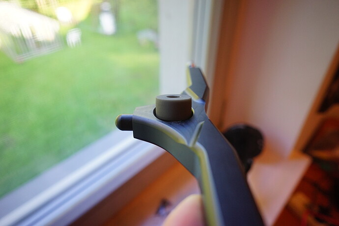

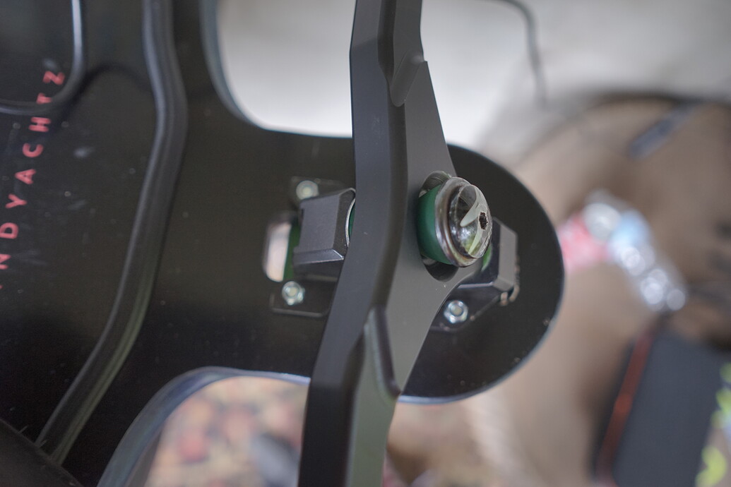

I really do not understand why you are using cones flipped upside down. Can you post a picture that will explain
Not at home right now but hopefully this picture explains it:
cone dont fit right

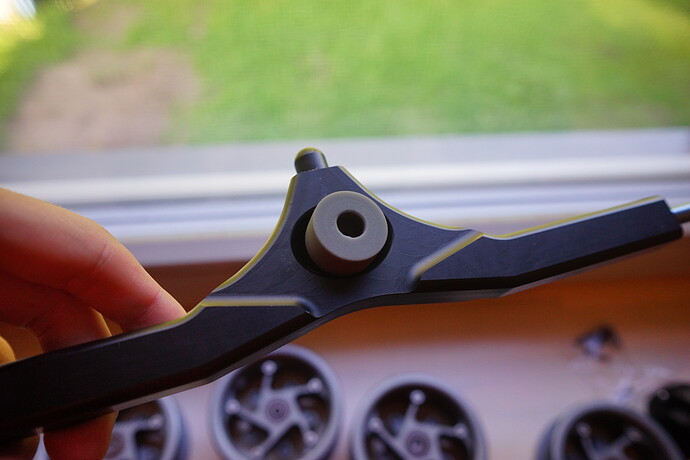

The opening for the bushing seat is slightly too small, so the bushing doesn’t make flat contact with the hanger. Instead it gets stuck and wobbles. Unless I crank it down super hard. That’s why I’m using cones (that have a narrow end) with the narrow end towards the hanger :disappointed:
Not-ideal pic but maybe helps:
Chop bushing, or chop hanger, that is the question.
Are you sure those are cones and not Our FatCones. FatCones are designed to run the smaller diameter towards the hanger
They’re small cones, I’m sure of it. I have a fatcone in the rear, which works because I have the rear cranked down quite hard. Although it’s probably not being squished evenly, so could better.
Looks like the hangers are not designed correctly or designed for some other purpose. When you get home, post a picture of the bushing seat as it does not show in the pictures above.
I measured with calipers, the issue lies within the fact that normal Surf Rodz RKP hangers have 25mm of vertical space in the bushing seat, but the Fat Boy version only has about 22mm of space. And the diameter of standard barrel bushings is 25mm of course.

Chop or replace the hangers so you will not continue to run into this issue with commonly available bushing shapes. I would really like to se firsthand what the issues are before you modify them. Care to send me one?

I think I’ll try cutting some cheap bushings I own to size first, and if that fails, just use the flipped cones like I am now. With Riptide urethane it’s not that terrible actually :grinning_face_with_smiling_eyes:
