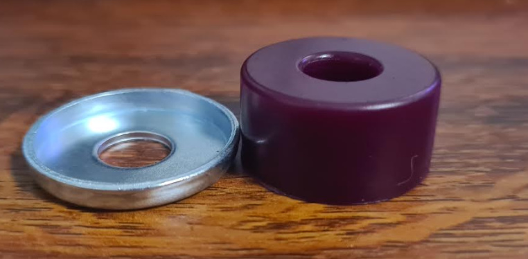

trying to figure out what bushings are good with my Torqueboards direct drive.
Looks like it came with 93a streetbarrels. I’m 130lbs. The bushing did come installed upside down?? (round edge touching the washer) Not sure if that makes a difference but i did flip them.
This is my first RKP since the old boosted days.
I am
No bushing expert… buttttt I can almost certainly say 93a too hard for 130lbs
I’d drop that down to highest 90a… maybe even lower. I’ll let @RipTideSports advise further :call_me_hand::call_me_hand:
I would like to see what is in them currently. Bushing shapes, placement durometer and washers. Pictures would help to determine a couple of things
Bushing orientation can make a difference, especially in open bushing seats but i suspect the DD’s are more restrictive. @torqueboards was going to send me a truck but I have not seen it yet. Can I see a couple of pictures of he assembled trucks?
@Edness Sharp edge should be inside the hanger which means round edge should be against the washer. You should be fine? I think?
@RipTideSports I didn’t send one out yet. May change them up or fix them up so wasn’t certain if I should send you one out just yet.
@Edness Correction :slight_smile: Sharp edge against the washer. I have it backwards. :sob:
