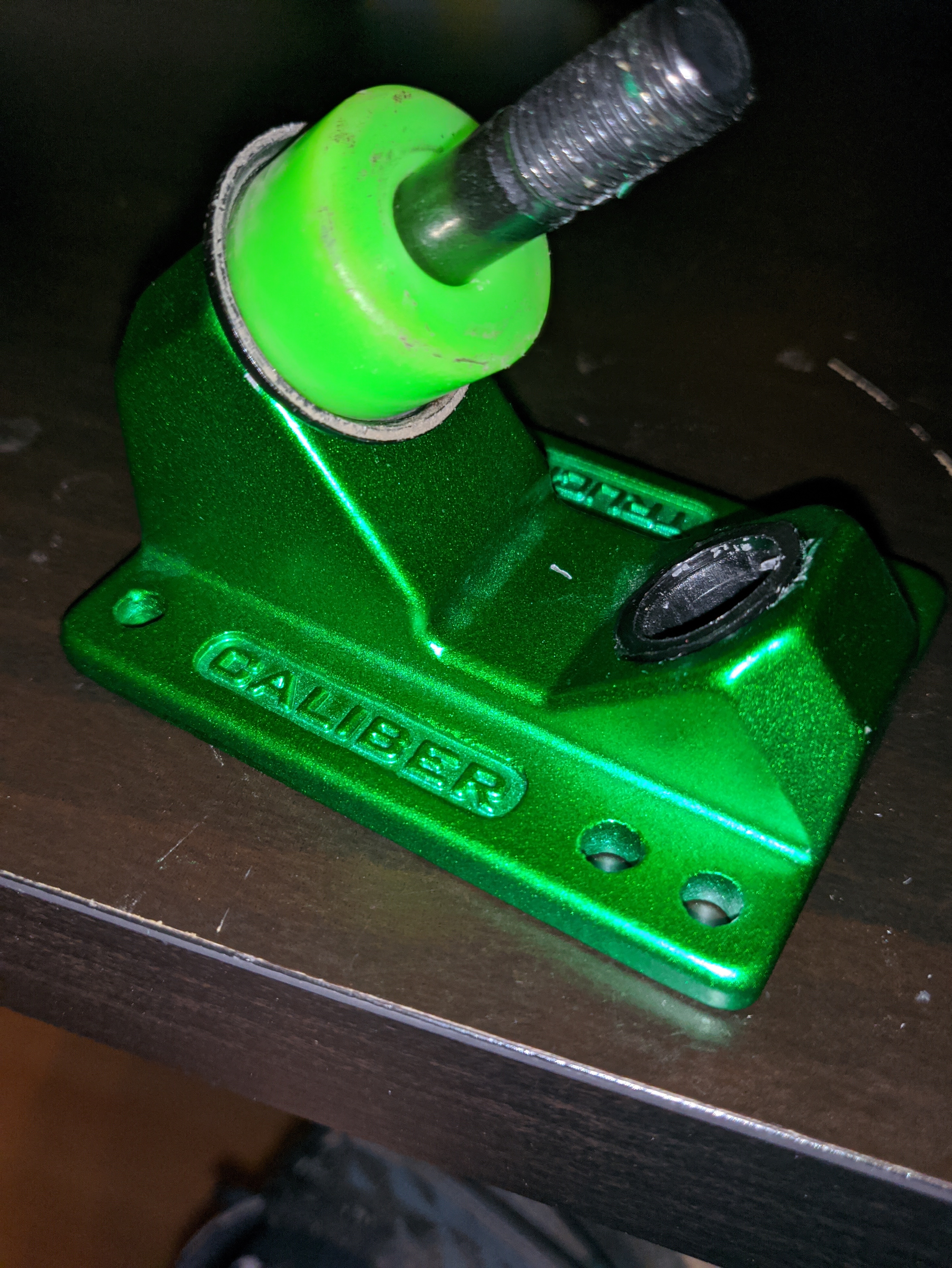

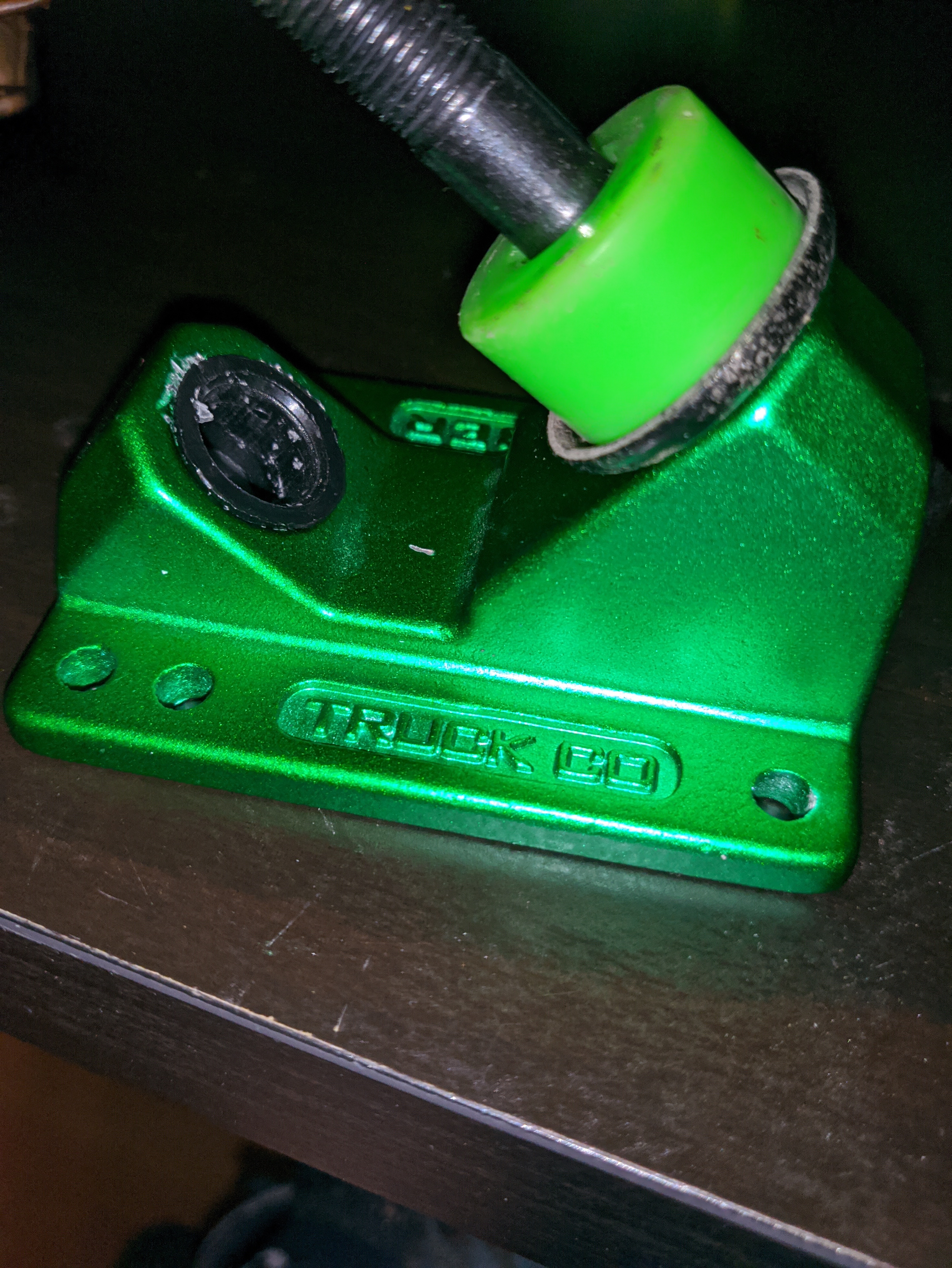

Will be used with a Caliber 2 baseplate and a Wowgo 2s truck

update: for these baseplates
Caliber 2 pivot for caliber 2 base plates, it’s kinda self explanatory xD
Are you trying to put a wowgo hanger into that baseplate?
Are you sure the wowgo pivot/geometry is caliber 2 compatible?
Caliber II will work in Caliber I but Caliber I will not work in Caliber II since the Caliber II is shorter.
Yes i am since some people did that upgrade too.
E: now i’m unsure since the wowgo truck is a paris clone…
if you know the different caliber trucks then yes.
@RipTideSports got it. Middle one is the way to go.
