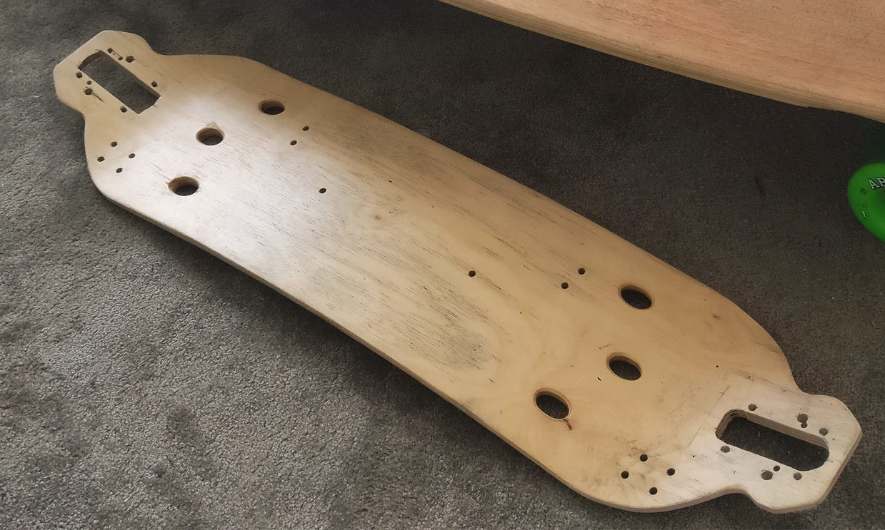

I got these patients x you, Brad.
  • SurfRodz RKP 200mm with 10mm axles and Adjustable Base Plates
  • Currently no Bushings in the Trucks
  • Want Stability
  • Cruising
  • for 34" Wooden -Trampa like- Deck and Drop-trough
  • 75 kgs (165 pounds)
Cheers Bro.

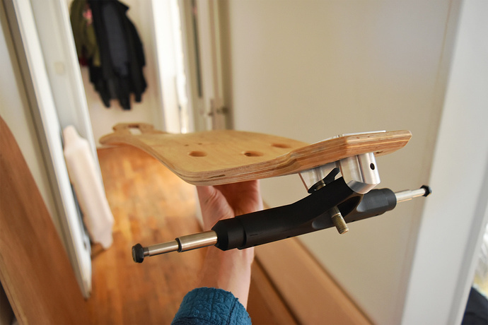

Thanks @pixelsilva, there a lot of holes in that deck. Are you top mounting it or drop through. Do you know the angle of the kicks and how much adjustability your base plates have? Checking out for the night so no rush on the answers
Tentatively Drop-trough. Got to fix both mount openings for the adjustable base plates. If too much trouble, then I will go Top mount. Don’t worry about the holes. This is a second hand deck. Previous user had bindings, that’s why so many holes. 0° - 60° degree adjustable base plates. As for the kicks angle°, don’t know? Perhaps 25° degrees? what do you think? … :point_down:
(never mind the PNL plate and Haggy hanger there)
you starting a new build?
OK, I would say 15 to 20, get an app for your smartphone like https://www.plaincode.com/products/clinometer/
Let’s assume it is 20 degree kicks.
So 0-60 plus 20 gives you effectively a 80 to 20 degree base plate range so you will need to adjust both the front and back to something more manageable. Your most practical setting will be a 50 to 60 degree front and a 30 to 40 degree rear if you want a split setup.
Being an older deck I would suggest using our aluminum backing frames to reinforce the cut out area to make the setup more stable. As for bushings, I would get a pair of KranK 90a Cones, two pair of KranK 90a Barrels and one pair of KranK 90a FatCones so you have various combinations to work with when determining the exact angles you want to rock! Our SZ 96a pivots will work great in them and the backing frame will tie it all together!

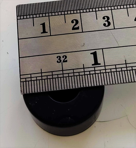

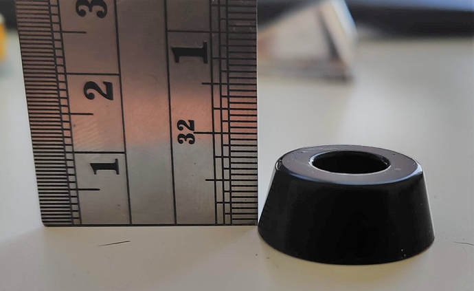

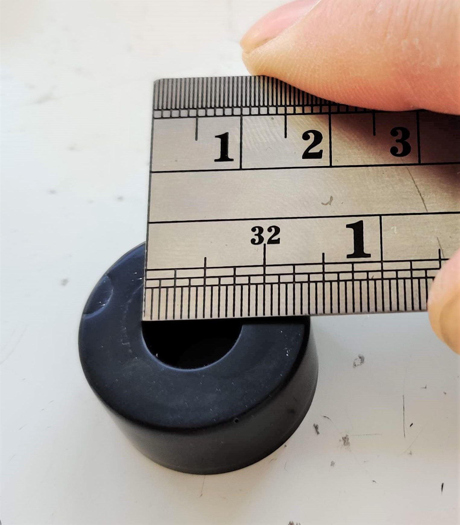

Boardside bushing
diameter - 1" - 25mm
height - 5/8" - 14mm
inner hole diameter - 3/8" - 10mm
Roadside bushing
height - 3/8" - 10mm

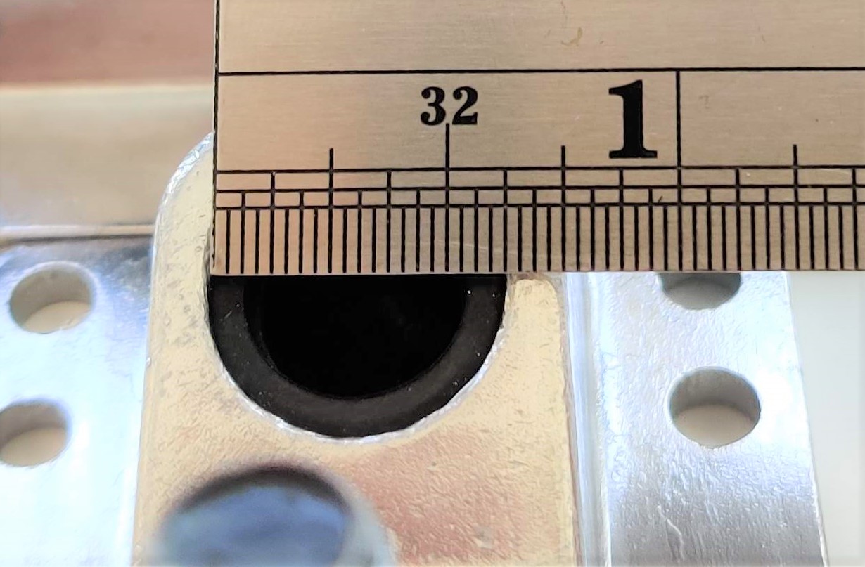

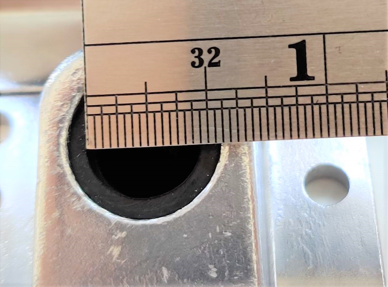

Pivot cup hole
diameter - 5/8" - 16mm
inner diameter - 7/16" - 12mm
@RipTideSports

Thanks for the measurements @thisguyhere. Might went to recheck the first one 1"=25.4mm. As for the other dimensions it looks like the ShortStreet height will work on top and the our longboard height will work for the bottom bushing and they appear to fit our Indy pivots. Have you put the board together yet to give us a base lint on what the trucks are doing?

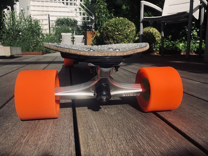

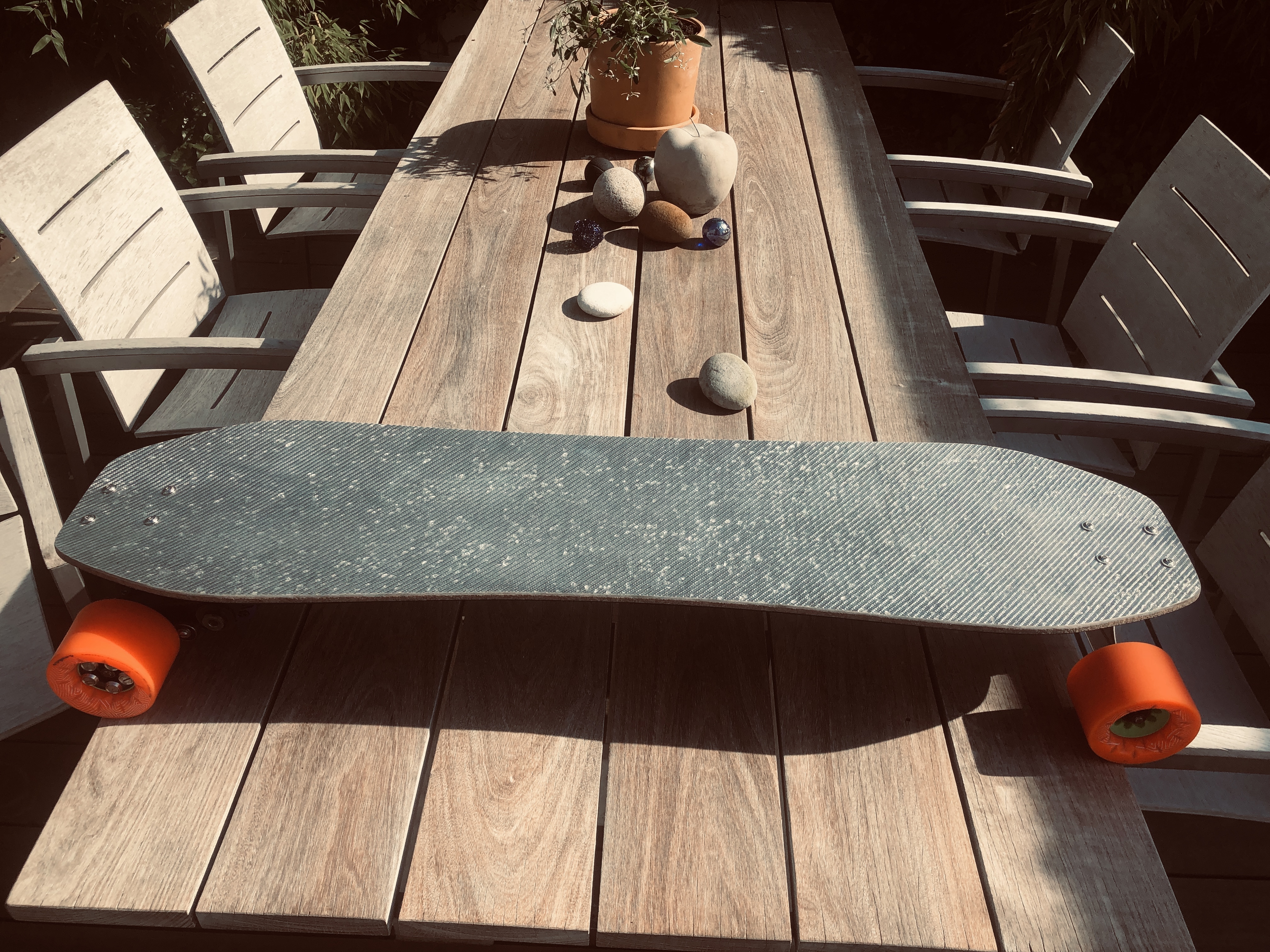

Okay so I have something little unusual:
Im running rogue cast trucks on the stock 48° plates and they are mounted to a speedy setup, it does about 60km/h (37mph). and im rocking a home-brew deck 94cm (37inch) long 22.5cm (8.85inch) wide with trucks. Mounted all the way to the end, the board has moderate camber and rocker with baby blue caguamas.
Now to the wired shit. the deck is mega flexy length wise like way softer than an old vanguard flex 4 of mine, but incredibly stiff in torsion. The idea is wide stance/ stand over trucks to simulate a stiffer board for going fast and to cope with aggressive acceleration and braking and a narrower stance for that good old carve.
right now (well for the past 4-5 months since I built the thing) I am running stock tall barrels bushings up front. and some 7 years old second hand riptide rock solid red tall barrels something something. Cupped washers and kingpin nut just snug enough so I can’t rotate the bushings by hand.
So yeah I need to step up my game…
The board is still dead stable at max speed and I can: yawn, listen to music, be hangover and snap with some friends at the same time without having to worry about twitchiness.
The turning radius is okay but can be better on the other hand.
Looking to mainly upgrade the urethane bits and bobs and maybe truck angles.

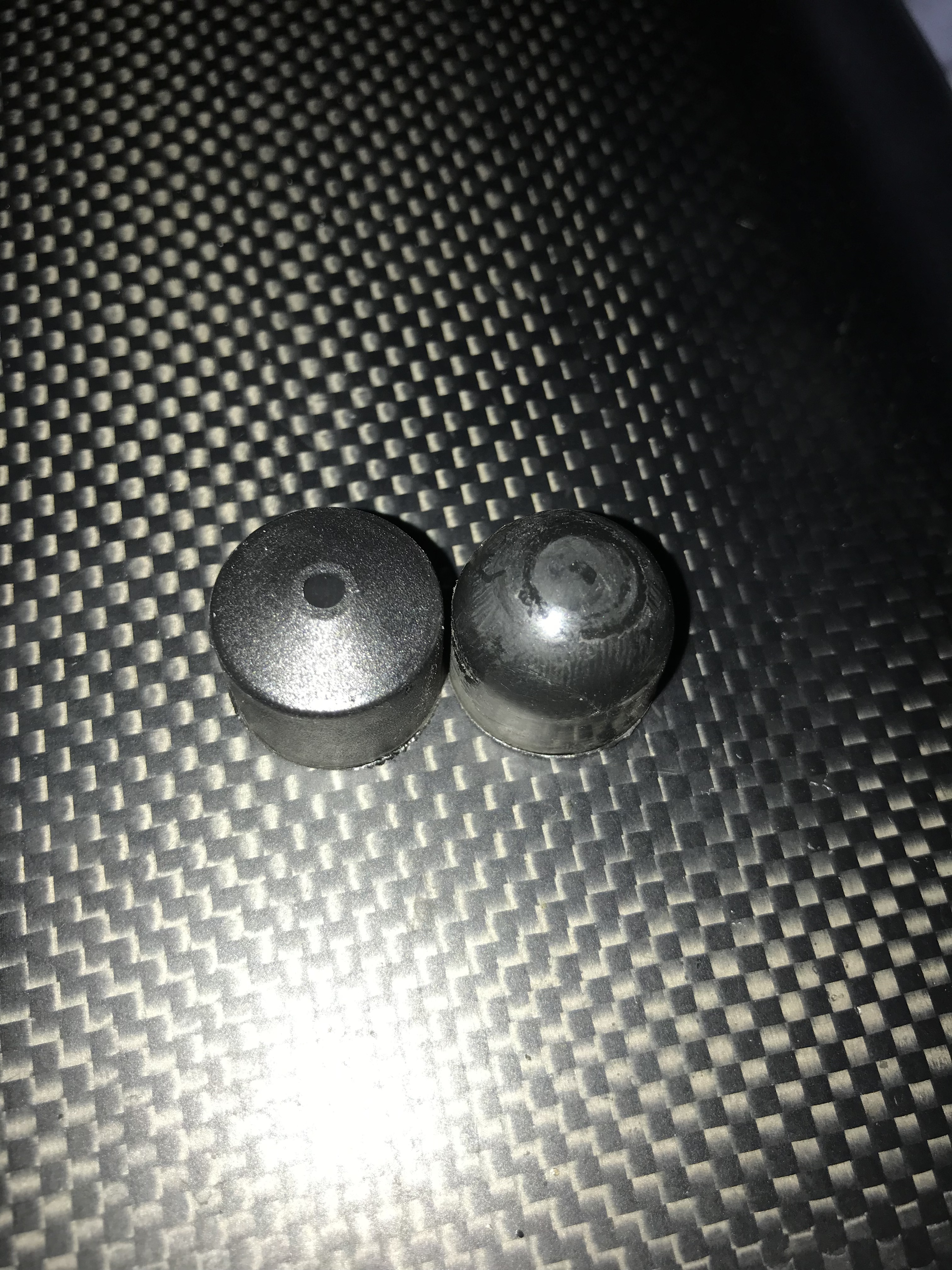

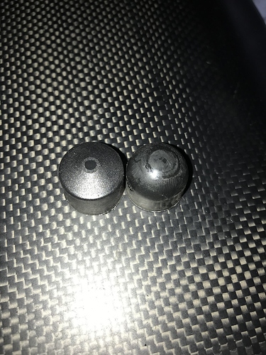

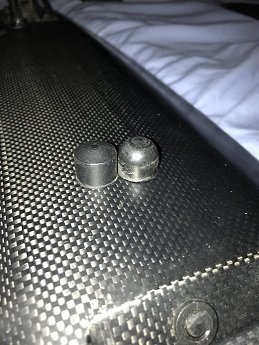

It’s the stock trucks that came with the Lou board. The picture below is a comparison to a pivot cup from a Paris truck. Paris truck pivot cup on the left and louboard on the right. They appear to be the same height but the Lou board is more rounded it seems.
Cool, I need Outside diameter, inside diameter, depth and overall length. A picture of the base plate hole the pivot fits into would also be useful so I can see if the hole is radius’d or a drill point shape. Have you tried putting the Paris pivots in the trucks? Can you also provide shape and dimensions of the Lou boards bushings?
