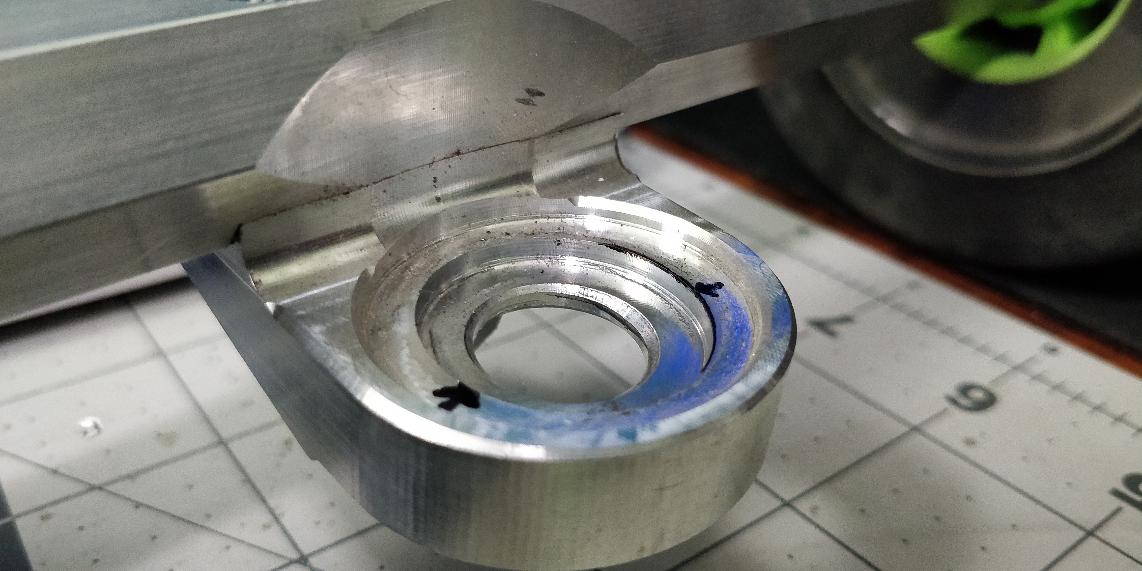

Is this normal? Running Psychotillers TKPs.
The bushing seat is a little sharp or if I’m over tightening it. Im about 180lbs and I do like a little bit of carve.
This is not good.
At least some finishing passes or a tumbling machine should have been used.
It looks like it wasnt finished properly, or they forgot to do the finishing touches.
It should have been smooth down
I am assuming those are Abec 11 lime 80a bushings? No that is not normal. The bushing seat of the truck is definitely too sharp and cutting into the bushing. Just break the edge of the seat with a cloth backed (so you don’t cut yourself) 80 or so grit sandpaper. @ChrisChaput and @Psychotiller have hopefully seen this.
Sliced bushings can be dangerous as once there is a cut, it can propagate a tear that can lead a bushing to split.
I heard they’re working on getting those who bought the trucks revised replacements. How do we get on that list?
Best to ditch them or turn a radius on them then flip them in the bushing seat (fix the seat first though)
