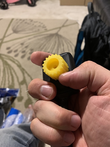

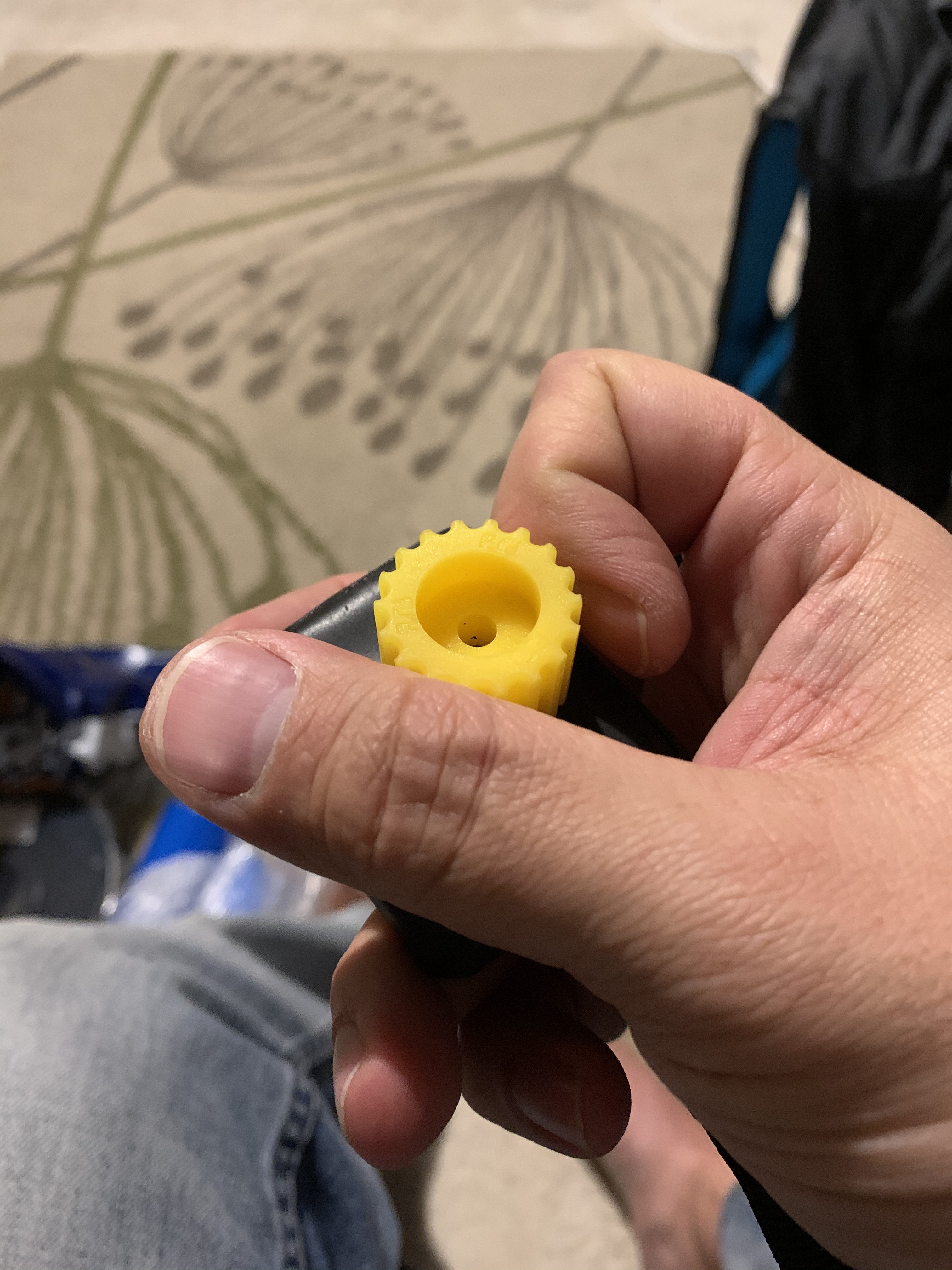

Hi everybody, I’m building a wired remote control to completely cut out external signal interference.
I’ve ordered a Turnigy Servo Tester and thinking of using my steering potentiometer that’s left over after modding my HK GT2B for throttle, since it returns to center like a throttle.
Anyone with experience building one of these please chime in, it’ll help me and others that may want to do the same in future.
I call this style of remote the “Tweaker”, and will develop it further over time.
It has cruise control, since there is no spring loaded return to neutral, and needs no battery ever, since it’s powered by the ESC BEC.

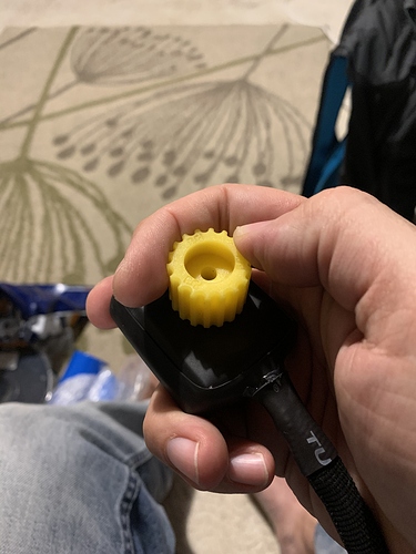

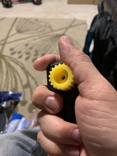

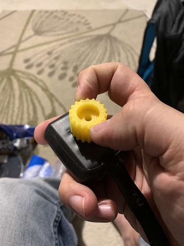

Also gives you options on how to hold it. Photos 2-7 below demonstrate full throttle to full brake.
Currently shortcoming is no tactile or visual identification of neutral throttle position.

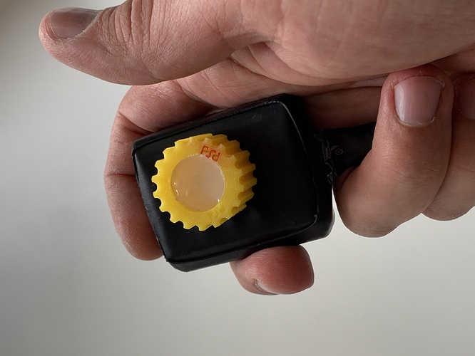

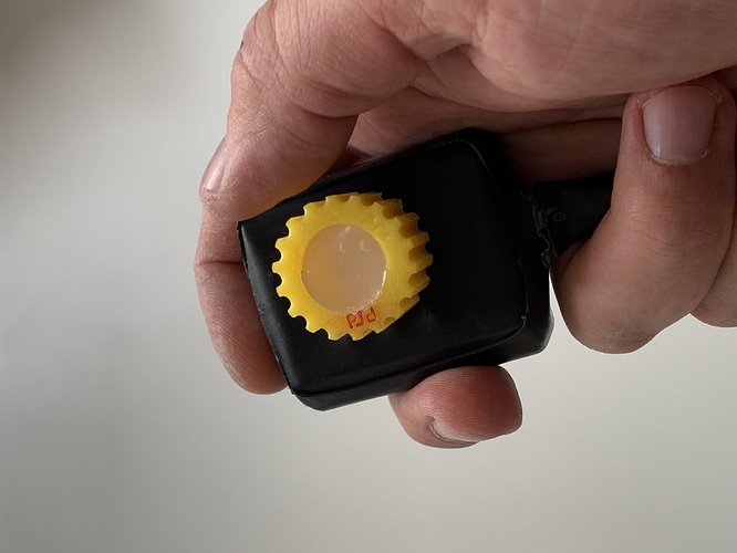

Now hot glued in and with red nail lacquered throttle position indicator. Shown top to bottom in full brake-, neutral-, and full throttle position.
I like the reliability and dependability over a wireless remote - no more signal cutouts or interference to worry about.
