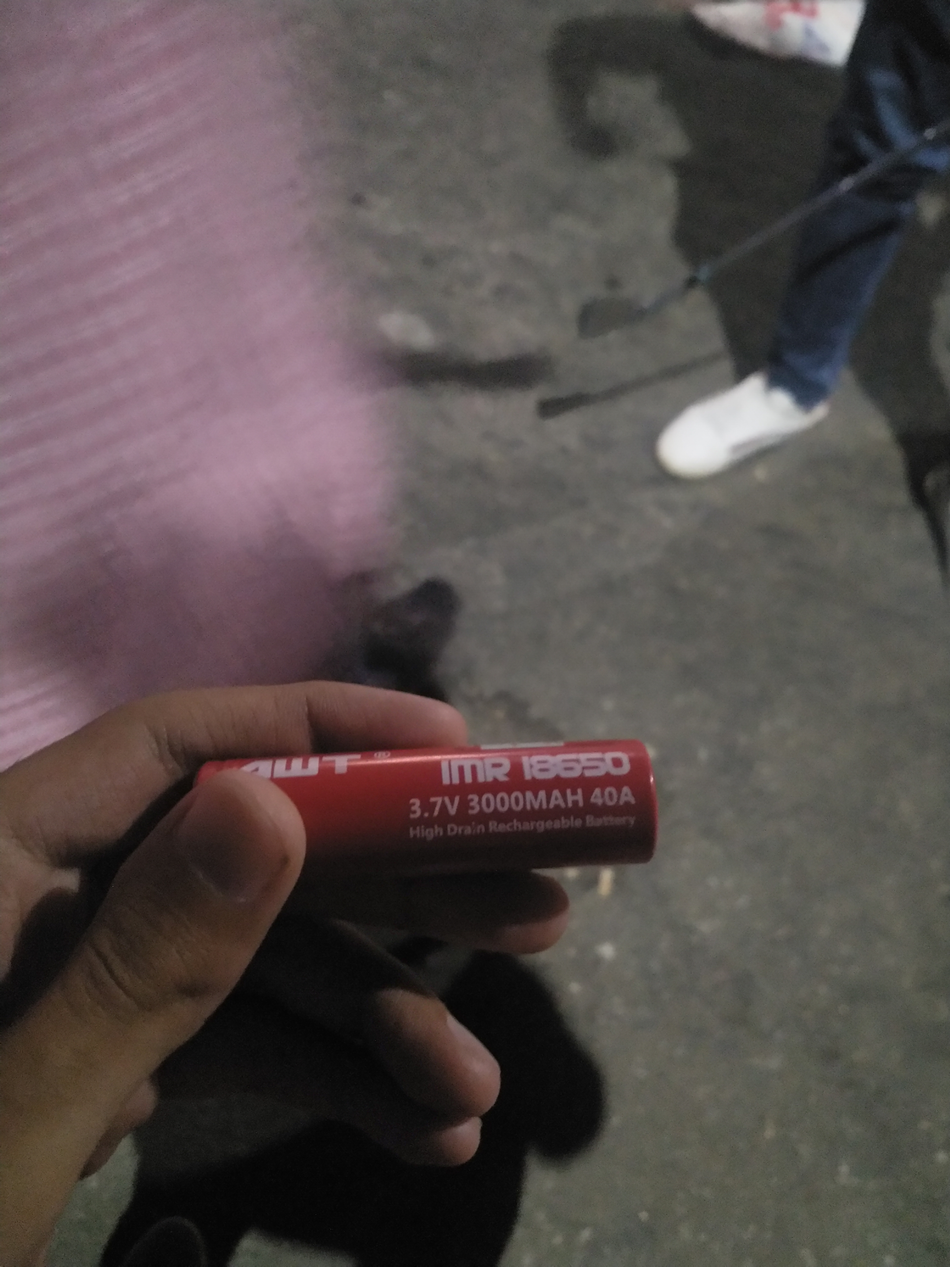

Is this a good cell to use to build a battery?
According to mooch:
Bottom Line: In my opinion, this is a confusingly labeled 3000mAh battery with only a 20A continuous discharge rating (CDR). It gets badly damaged from just one discharge at 35A and 40A. Its appearance is close to the HG2ās but its performance is just below it.
At 1.55x the price versus a 30q, Iād say no.
