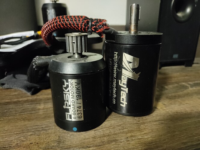

Hi everyone! I’ve been collecting parts for my second build and would like to share my vision. It’s a high torque carver with bindings.
Here’s what I’ve purchased so far:
Mbs Birds deck
Mbs F5 bindings
Matrix 2 trucks
12s8p enclosure
160x50 pneumatics
175x50 pneumatics
6396 Maytech 170 kv motors
66t & 62t wheel pulleys
Kinda looks like this:
Now I need the important stuff:
12s8p 18650 (P26)
180a <= esc (DV6Pro)
Remote (VX2)
Motor pulleys (18t)
I’m pretty ok with my expectations with this build but I would like to hear what others think. Any advice you guys can offer would be great.
