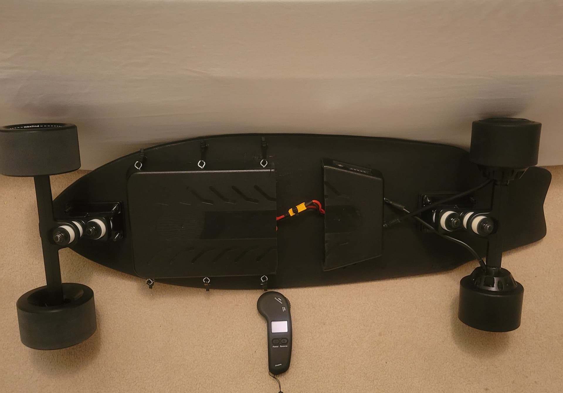

Hello, I hope I am in the right place. I just thought that I would log my first diy electric skateboard. Most of the parts were ordered from Amazon and other online retailers. This is a budget board, put together for cruising around campus and parks. This is my first attempt at this kind of project and wanted to share.
The deck is a 30" Surfskate inspired mini deck with a nice kick-tail. I am running 83mm- 485 watt hub motors. I took apart the hubs and replaced the cheap bearings with higher quality. The Esc is a 36 V dual motor with a Universal thumb-wheel remote. The battery is a Meepo V4/ V4s shuffle at 36v 10s2p. The trucks are dual kingpin with medium-soft bushings. The hubs are 83 mm with half inch riser pads to stabilize the 96mm front wheels from Maxfind.
I cut an plastic battery enclosure in half to mount the esc and figure out an enclosure for the Meepo battery. I decided to use foam, double sided tape and eye hooks for the enclosure. I fastened the eye hooks in the case and on the board with zip ties. Its not a permanent solution but it works for now.
Overall it was pretty straight forward build and I really like the Mini fish board design.
Future plans are to build a more enclosed enclosure but build it to include this 10s1p battery with a xt60 splitter. For now, I will be sticking with just the Meepo battery for testing.
Estimated 16-18 mph and a range on the single 10s2p of 11 miles. Thanks for checking it out!
Thats a cute lil campus cruiser. Sinple and clean, i like it!
A cheap but more secure way to attach the enclosure to the board would be to use some small angle brackets. I’d add three to each side on the battery cover in about the same spots you added the eye hooks. That way if the adhesive fails on the battery you can trust the enclosure to hold up the weight of the battery
For future reference, you have a ling-yi ESC. I’ve got one running currently and have the same exact remote as the meepo remote my ESC came with finally died on me. If you didn’t already know you can press the power button twice to switch to reverse and then the reverse button is actually the mode/ speed and brake setting button.

Hey I appreciate the info, I’ve been tinkering with the case to reinforce it but keep it removable if needed. This was just the first thing I came up. The remote did take a minute to figure out because it did not come with instructions. I had to adjust the wheel speed in a menu.

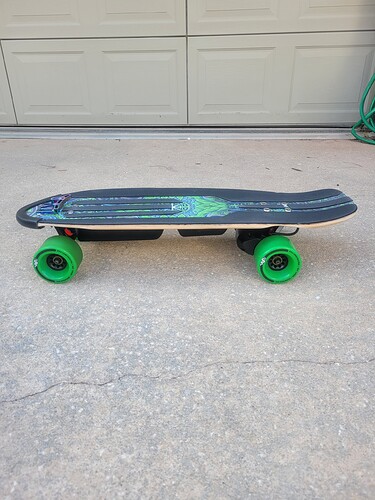

BIG UPDATE! Black friday was kind to me, I revamped this project entirely!
The biggest change I switched out the dual hub motors and installed a zealot s dual 875w belt drivetrain kit. I also had to swap out the esc but still able to use the same R3 remote. I got some 37t kegel style pulleys allowing me to use my 100mm 83a boa constrictor wheels. I also shortened the wheelbase by 1" due to torquing wheelies.
Next I switched out my dkp front trucks for new Caliber 3 184mm 50° raked trucks with Boa wheels and Onsra ceramic bearings.
This board is a little beast. The stability with the rkp Caliber trucks vs the dkp has improved vastly. Having all 4 Boa wheels compared to the Hub motors is night and day. The acceleration is butter smooth and the braking is almost extreme. The torque is insane at higher speeds but this is for cruising, not high speeds. The ride comfort/ board feel with the belt drive is so smooth compared to hub motors.
Looking at possibly getting larger front trucks but I will be be back if/when I update more.

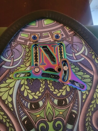

BIG UPDATE!!
My Momentum Hollow Wheel Comforts V2 just arrived and I am super stoked to test them out. These are the updated version with better grip and less wear, so we will see how they perform. To go with them, I purchased Evolve ceramic bearings in the oil slick. I also changed out the stock pulley bearings with high quality ceramics from Acer Racing. The ceramics might be over kill, I am just having fun with it.
I also added the Zealot S upgrade kit. Swapping out the stock esc, allows me to use the new Halo remote with fingerprint scan. The build quality is insane and feels much nicer with its metal housing and thumb wheel.
I’m overall very pleased with how this board is evolving. It’s way too fast and powerful but is perfect for me cruising the streets.
