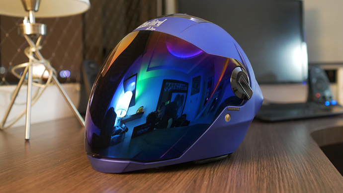

@eBoosted just posted this photo of a Steelbird SBA 2 and it’s like $70 which is ridiculously cheap, I have no idea why

Rated in some Indian certification for their motorcycle. Ernesto uses one and even had a pretty big crash with it. Who knows how well made they really are though

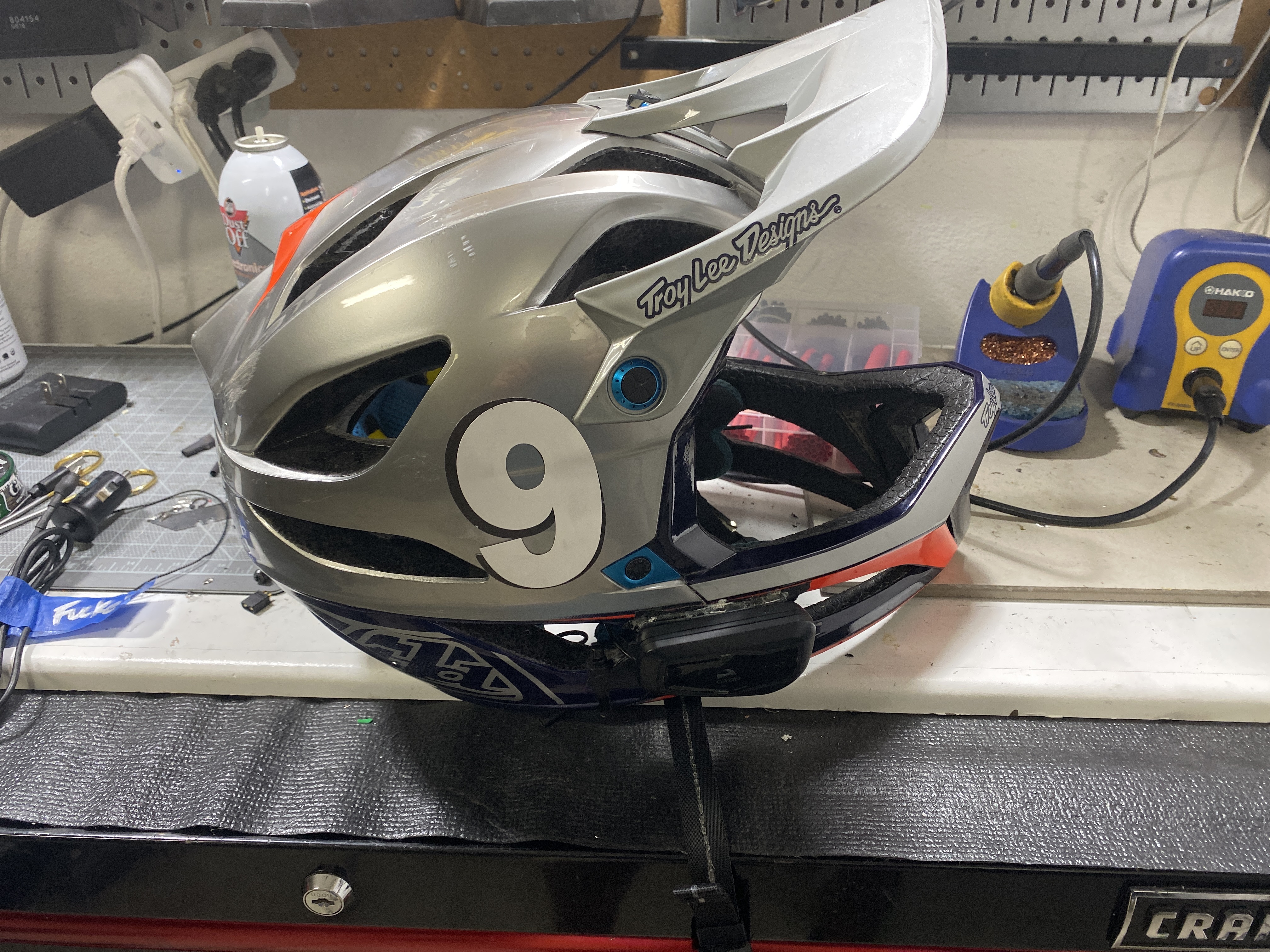

TLD makes some pretty reasonable helmets that were cheaper than ruroc. Also you don’t have to have aspirations to be a storm trooper to buy one.

If you’re going to get a full-face helmet, at least get the downhill mountain bike certification (Triple 8 Racer, TSG Pass, or Zero Gravity Vector if you can find one).

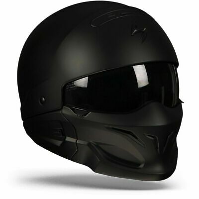

$17.99?!! insanely cheap price. Is this budget enough for anyone? Looks intimidating too!
I read that ISI certifications in india typically fall well well short of other international helmet standards
Exactly. When I click that link I see Shoei’s for $25. You don’t think that’s just a little sus?

Triple 8 Racer and TSG Pass have the same rating and appear to be as good.
