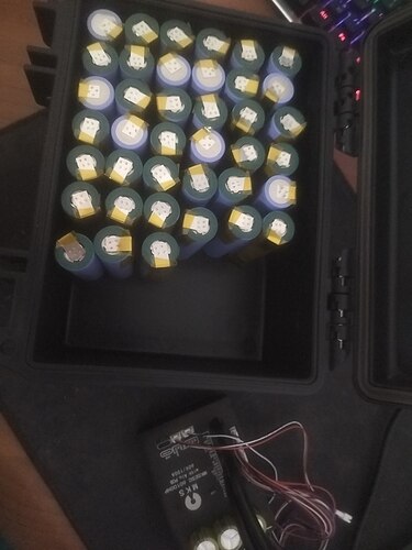

Hello everyone, I will share with you a budget esk8 build for $ 800.
:triangular_flag_on_post: MKS VESC 60100hp;
:triangular_flag_on_post: Battery 13S3P from cells. 21700 liashen lr2170la;
:triangular_flag_on_post: Motors: 6384 120KV;
:triangular_flag_on_post: Anti-spark: Mask;
:triangular_flag_on_post: Chain: 04c
:triangular_flag_on_post: Remote control: SRINTEND UNI1 V2;
Now I’m riding on a weak mode (L) of 60% power, for one motor: phase current 160a, absolute current 240a, battery current 80a, I use with phase filtration
