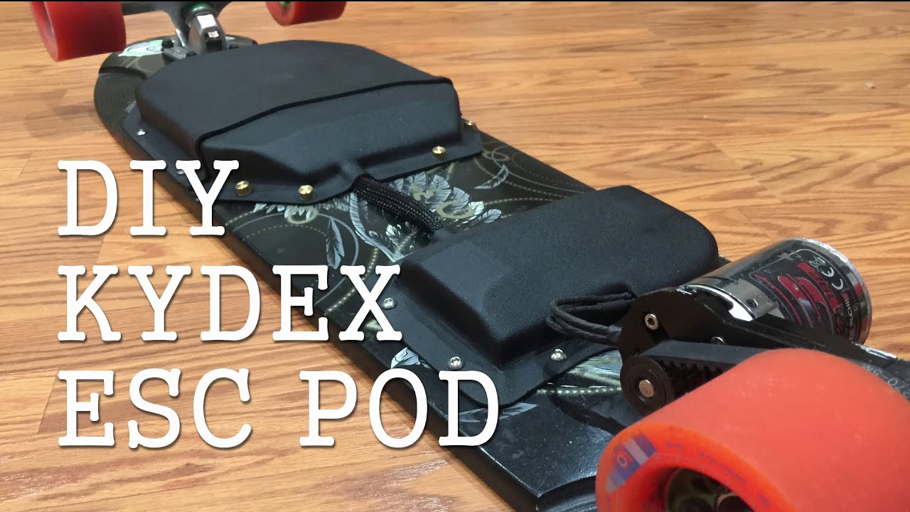

Battery [$60]
I will rather buy complete lipo pack than to build my own 18650 pack since I don’t have the skill. Having only 6 cells is not much, but it should work. Downside of the battery is that it is 45mm high and I’m afraid about the ground clearance.
Remote [$20]
The best choice without thinking, cheap, powerful and diy.
Drive train and enclosures [$0]
Will be 3d printing them. Motor mount and gears will be from thingiverse and enclosure will be my own design. Will update later.
