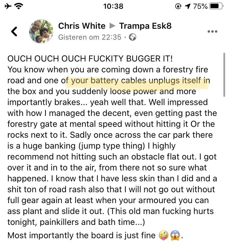

What he means is that free rolling with a dissconnected battery is fine…
Its the part where the battery is part of the circuit and you free roll and suddenly BMS disconnects the battery, boom → inductance of the wazoo generates a voltage spike, VESC dsn’t react in time → Poof.
Atleast thats my conclusion :man_shrugging:
Or when you touch the break slightly or give any input signal. If the VESC start switching the FETs it’s likely catastrophic. The voltage rise time is faster than the DRV reaction time.

It’s normal that you lose brakes if your battery cable disconnect during riding.

Doesn’t the vesc shut down when the BMS cuts out?
In which case it cannot accept any input signals such as braking?
Or does this happen in the milliseconds between the battery disconnecting and the vesc shutting down?

Maybe he didn’t brake in the moment he lost connection to his battery.
I am 100% sure that guys tried to brake. He even told he don’t had brakes. Then you have to try it :wink:
I am really thinking off testing all this on a new vesc. I really can’t understand you kill a vesc with such a things. Why do we ever need then over voltage setting in the esc tool?
As i said I do not know that context behind his message, but for me it reads that he lost power, so probably lost connection while accelerating or just holding the same speed. That he lost brakes as well he just realized after when he tried to brake but at this time the vescs already have been switched off.
