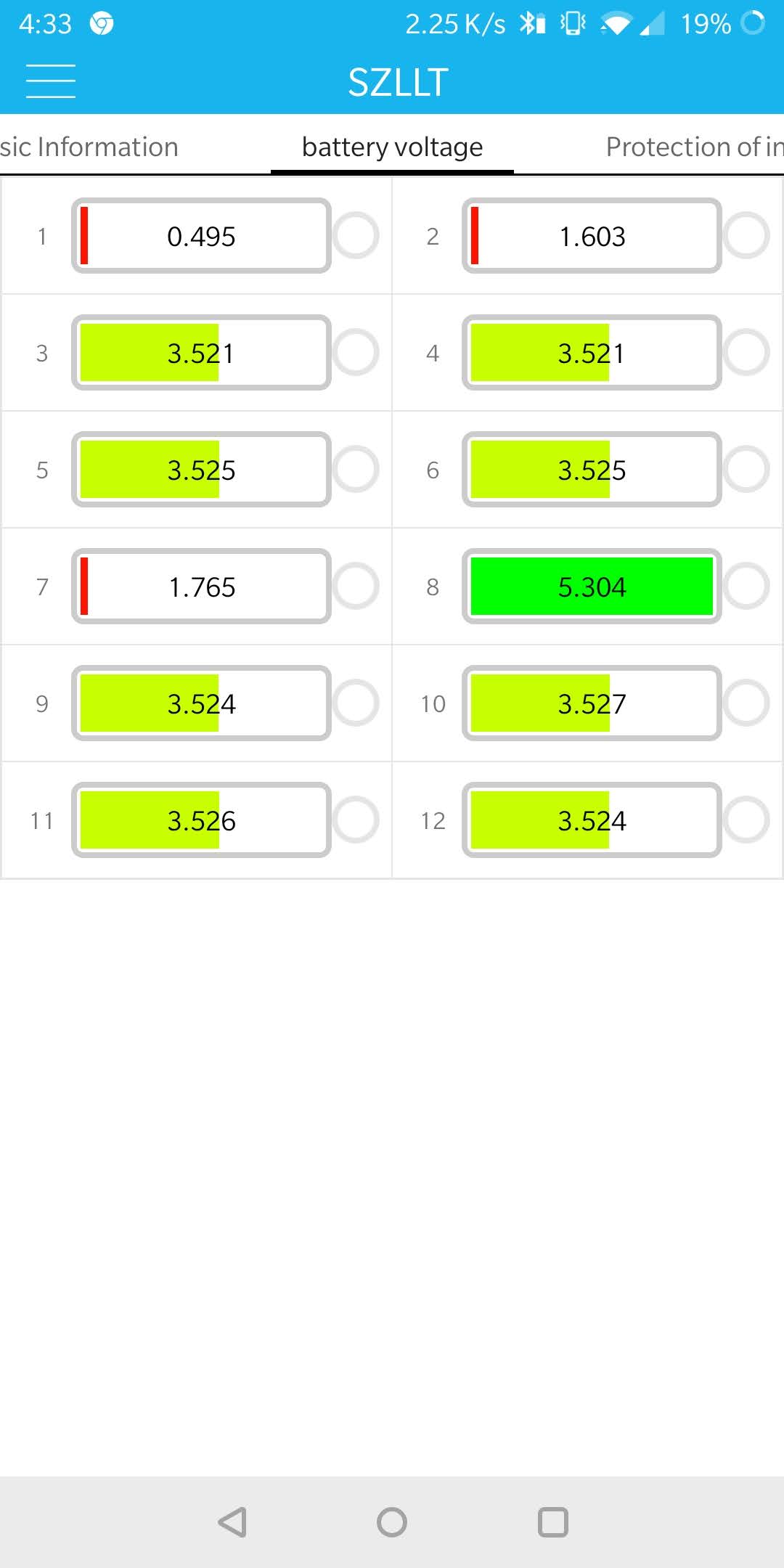

so, um… i think i broke my bms 1 day in… i dont know if its a setting or i just wired it wrong but its calming cells as low as 0.4v and as high as 5v, i have checked with a multi meter and they are 100% not that so i don’t know what its doing/ what i did wrong, any help much appreciated Tank
i am assuming i did something wrong but i cant see what
Is the B- wired correctly?
Do you have a picture of your wiring maybe?
This usually happens when b- isn’t connected

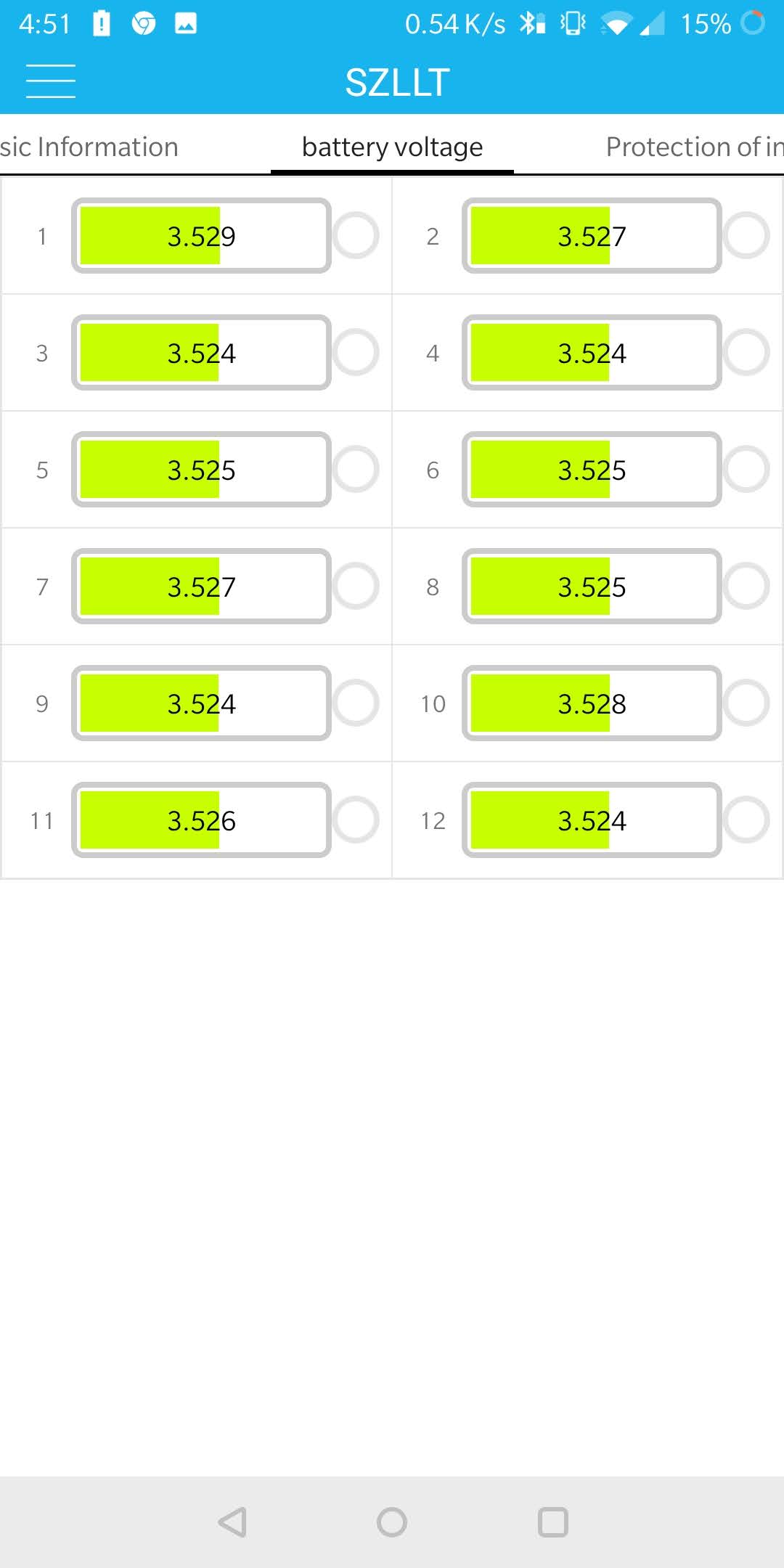

whelp i feel stupid. um thanks
wow that was my bad and incredibly stupid of me, any idea why it does this when its not connected?
No idea lol. Litteraly happened to me the other day…and i was like…Oooooooh no!!! But saw b- was disconnected, and everything was good after I connected it
yea odd, well thanks @Sebas and @Skyart love this forum any question and there’s an answer in under a minuet
ayyyy im glad its working again
I’ve literally been scratching my head ripping batteries down to check wiring, testing others swapping to another LLT everything. because I wired it like this, like a d140 oof (b- is linked internally) ah humility come at me.
