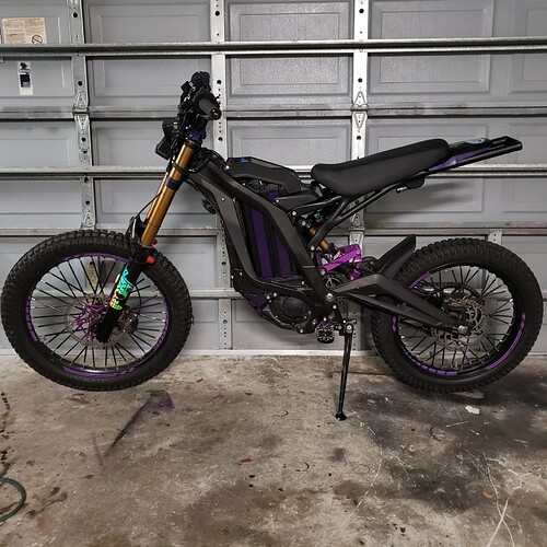

Shameless post since we’re on the topic:
Just got my new motor and controller going current settings peak at ~29kw :japanese_ogre:
Niiiiice. Which controller you running again? I lost our convo in another topic. I want to say tronic maybe?
My new set up is a fardriver 721000 Sotion motor running 400dc/900phase
Going to try 500/1000 soon
Nice! Been looking at the FarDrivers but there are so many damn models it’s a deep dive. What functionality are you getting out of the port? Biggest thing holding me back is the loss of turn signals, head lights, etc that the stock controller supports. I was considering even just keeping the old controller in the bike to handle the peripherals while using a beefier esc to just handle motor output.
I haven’t gone deep into controllers auxiliary functions. idk if FD supports that kinda stuff to be honest.
I would just make a separate harness for all that, I’ve done it before its a good amount of wiring but nothing crazy main thing is just getting the right kinda switches/controls for your handlebars. I also don’t run a screen, just a GPS speedo and my phone for any motor/batt stuff.
If you are keeping the stock onyx batt highest model I’d go with is the 72680. You can’t pull that much DC from the stock onyx batts even the bigger AH ones. 72680 will do 350DC/680Phase so well above what that onyx batt will pull, but gives you the option for more performance in the future. ALSO I’ve heard Kelly is coming out a controller that has field weakening finally and honestly Kelly’s work better with hubs than FD’s from what I’ve heard/seen. Might be a good route for you as well.
Well put, thanks for tall the info. I have no need for a screen on mine either, just trying to keep a few “street legal” bits but as you said, it’s just turn signals and headlights at that point. Nothing a new wiring harness can’t sort out. I saw the field weakening mentioned the other day from Kelly and am stoked to see how it goes. Was hoping to tear things down over the winter but I’ll be patient for now.
