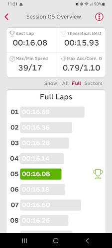

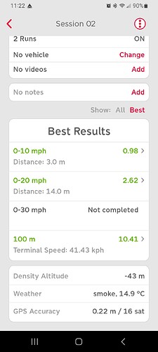

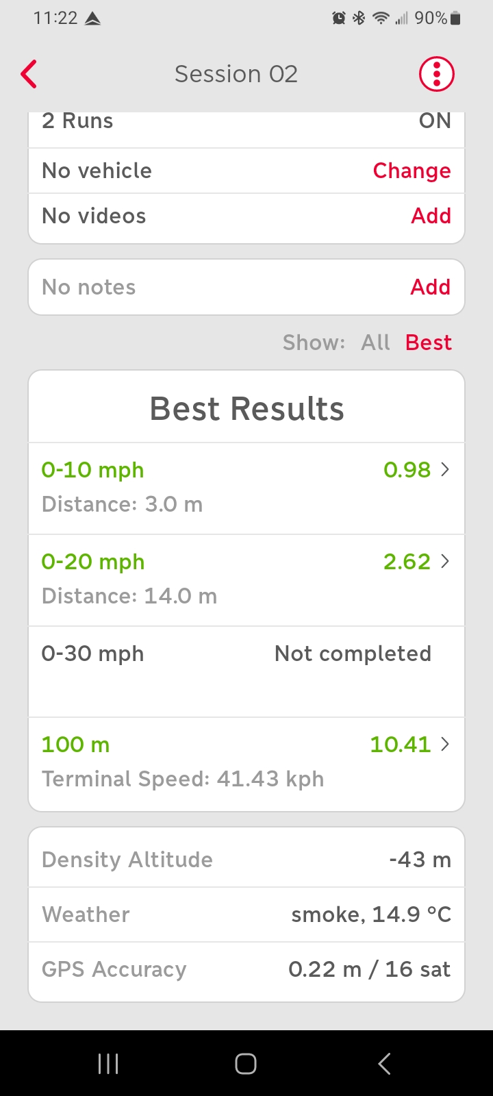

Got a racebox! I can finally quantify how slow this board is:
This is 575N thrust with a 100kg rider, geared for 40kph.
And here’s T-race, I’m a little faster heelside. I’m breifly hitting the machine’s top speed, but the bigger issue is that i don’t have the leverage to turn against the the tall standing platform of the board. My feet start lifting off the board before I reach the limit of the tires.

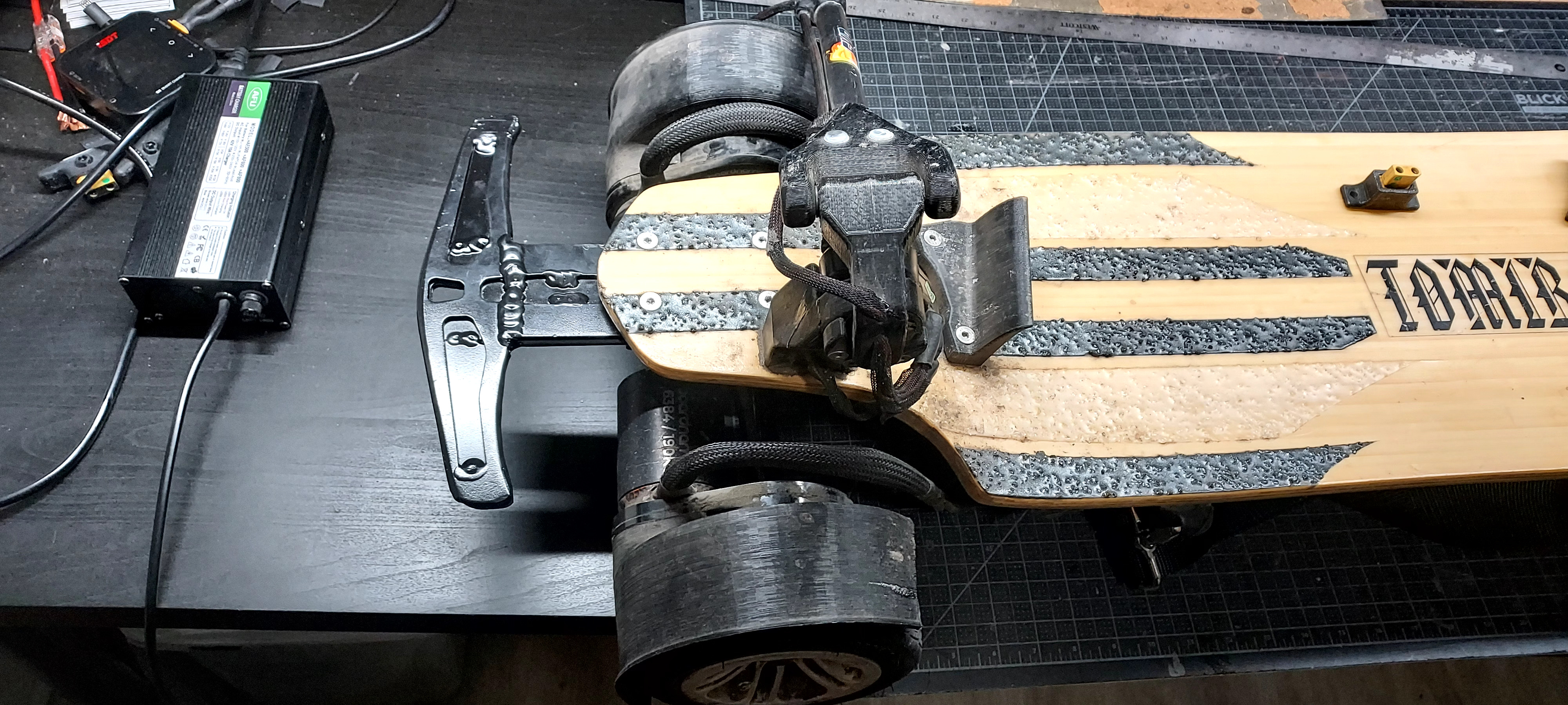

I swore off bindings for safety reasons, but I think I have a fix for it with my other build.
For your consideration: luggage handle riser.
I love this! Also a bit of a bumper
Yep, plus a little tow hook socket for future shenanigans
