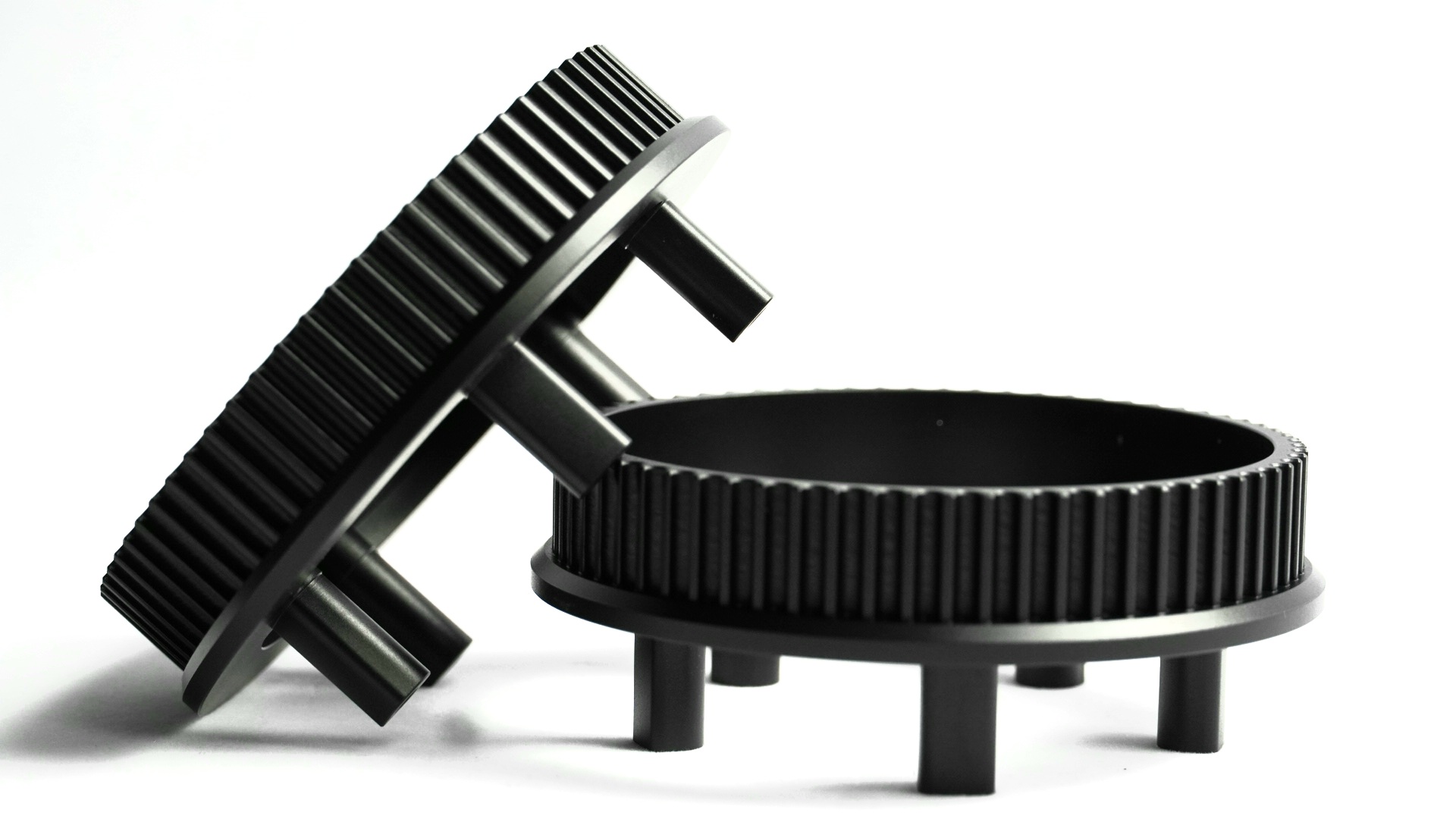

Hi I’m looking for som me bolt on 66T or so that are compatible with evolve 7” hubs.
I’m running 175x50 Sunmate tires, my trucks are Maker X 260mm TKP and the axels are 8mm and very short hence the need for bolt on pulleys.
If anyone can steer me in the right direction it would be much appreciated.

ah yes my mistake. could always make a 3d printed insert and convert it to bolt on
I’m not sure how this would work to be honest, I have very little room 39mm to be exact for the fitting of the wheel, I suppose I could get some longer axels it will probably be the way to go.

I actually just found these may be just what the doctor ordered. Then I also see his oil slick wheels that are tempting also.
What I linked is for a motor side pulley.and I didn’t understand what ur needing.
All good pal I probably didn’t explain well enough either.
