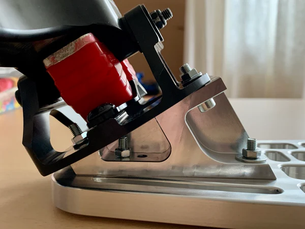

Testing the Singularity bushings from @RipTideSports and im gonna have to redesign the riser as this is untenable :laughing:.
Also adding some skid plates - the truck bed liner is good but im too mean to it
Held on with 3m extra heavy duty double sided tape and if that doesn’t work im gonna try some 3M 5200 marine adhesive but i want the tape to work as it’s way easier to mess with.
Gonna keep perfecting the shape but keep it a a flat sheet and not conforming to the enclosure edges as i want to send it to scs and get it cut from ti so i can throw sparks id i bottom out :grin: might add a little bend to the leading edge to help prevent peal off but only if it needs it

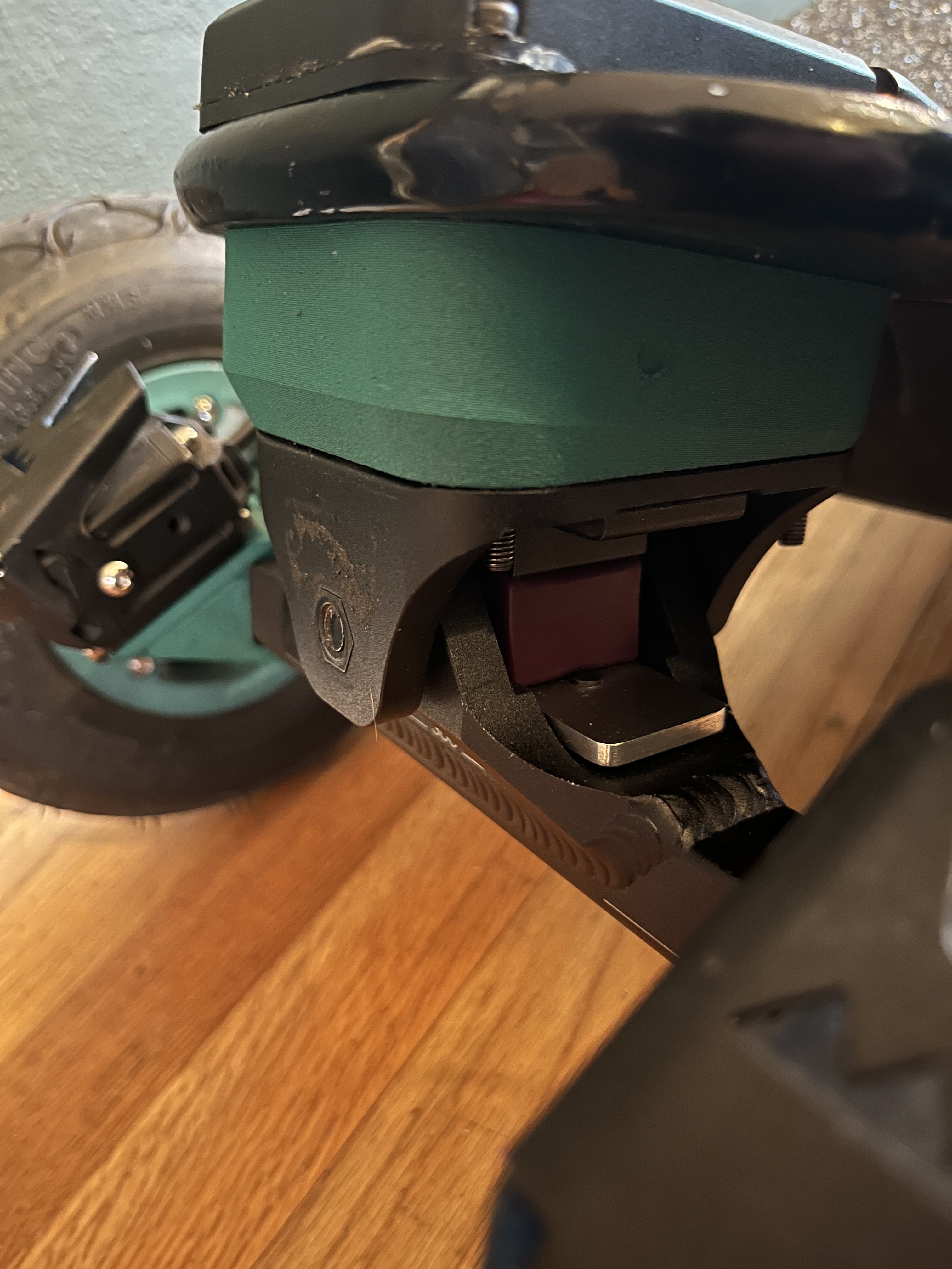

Integrated the wedges into the riser, this is absolutely the max possible without drilling the baseplate and using nylock nuts. Probably going to do that eventually but i need new bolts and to finish all the singularity trials.
I feel like that riser is asking for trouble. I could cut and belt sand a block of Alu to the right size and maybe mill out a chunk for weight. It would be ideal to have separate screws like the 3d servisas angled riser but that’s a whole lot harder to make, we can tap 2 sets of threads into the aluminium which is fine if they are really long or drill and tap for the outer holes and fasten normally the inner screws.

The screws are actually shorter on this version than my original but are at about the maximum safe length i feel. Any curb hit or solid knock and ive got to replace everything just for safety. Failure during use im not worried about but ya, a milled alu riser would be way better and make the whole assembly more stout. If you have access to a mill i could send you the step files? Otherwise i have an expensive guy local i was going to get a quote from. He does large volume stuff so not really set up to do single one off hyper nerd bs like i always ask him to do :rofl:. Center of the riser (mis point of the wedge) is 23mm front and back so my bolts are 42mm
Only hand machines not cnc I’m afraid, I’ll get back to you this Thursday I need to check if the mill is actually working. If it’s not I can drill and tap instead of slot and use nuts
The good thing about kid-in-school’s-metalwork-room is it will be the cheapest option but I can’t make it fit a baseplate perfectly and get wider by the deck like that.
Just made this to show what I mean idk if the dimensions are right that’s a 5 degree angle and 25mm at the tallest point. It would cost €23.5 of AliExpress 6061, shipping would be €17-€24 and you would have them around the end of May, I’m fine to make them before receiving payment me screwing it up is a risk. I won’t charge more than materials and shipping you are amazing for helping people troubleshoot and fix stuff on the forum.
That’s a great idea, but shipping to the west coast us seems a bit much. When i finish changing the angles every three days im gonna use your method and make something stronger. I think separating the riser from the wedge to keep the screws straight is a great idea.
i want a manageable break point in the system somewhere. If everything on the truck/riser/wedge assembly is stronger than the interface at the deck itself the failure will be the deck and that’s hard to replace. Also these printed risers hit a fence post at 30mph and failed in a limp home way and not dangerously.

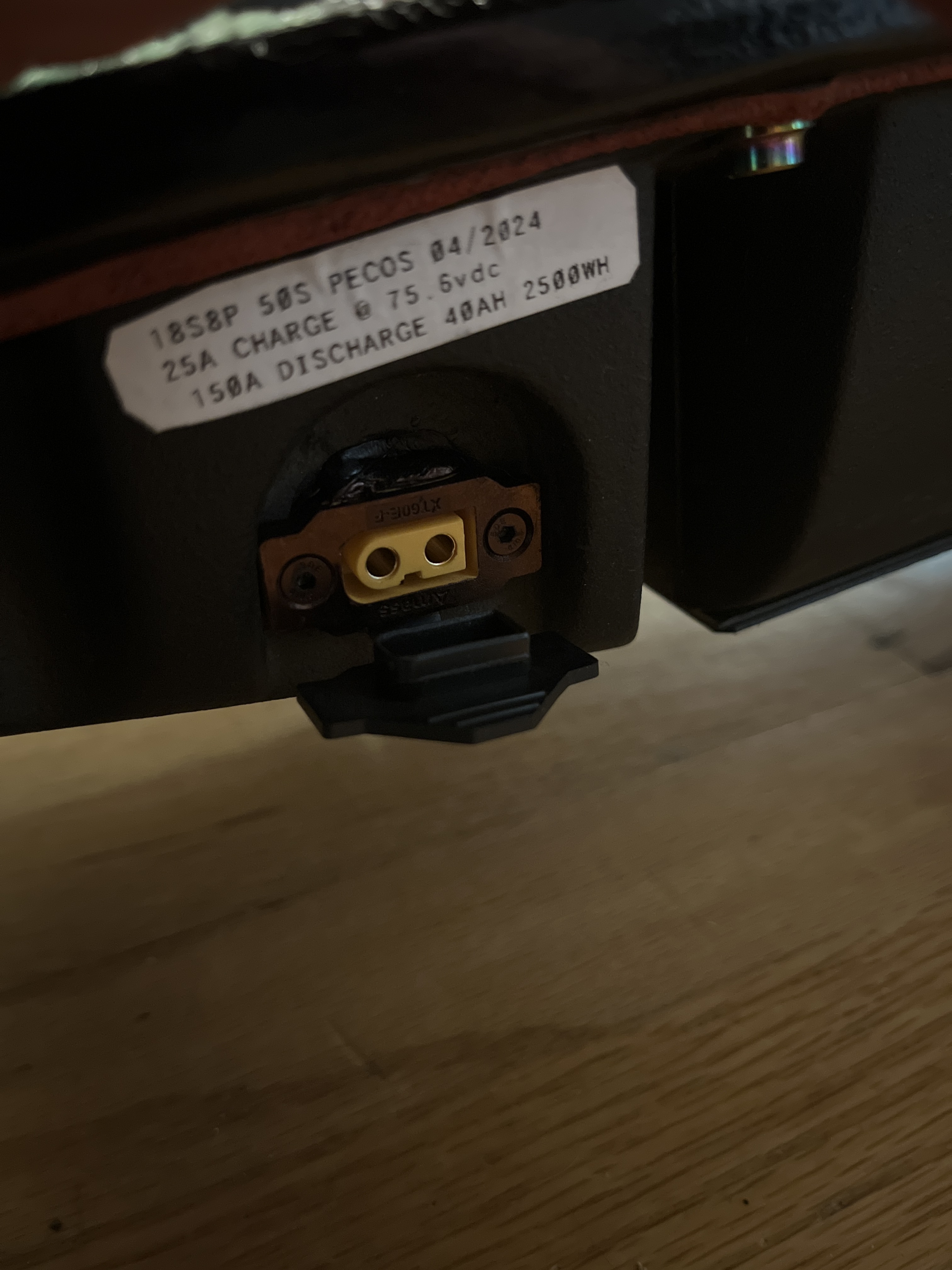

Pulled the LP20 charger port off and put in an xt60h because i just like them better

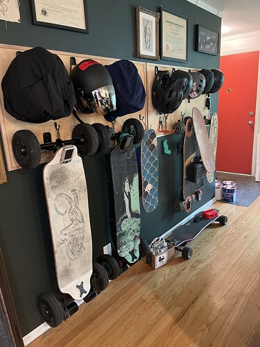

Also doubled my skate wall because the quiver grew… gonna have to make another build thread

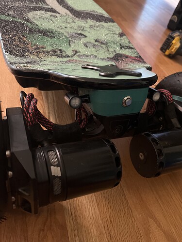

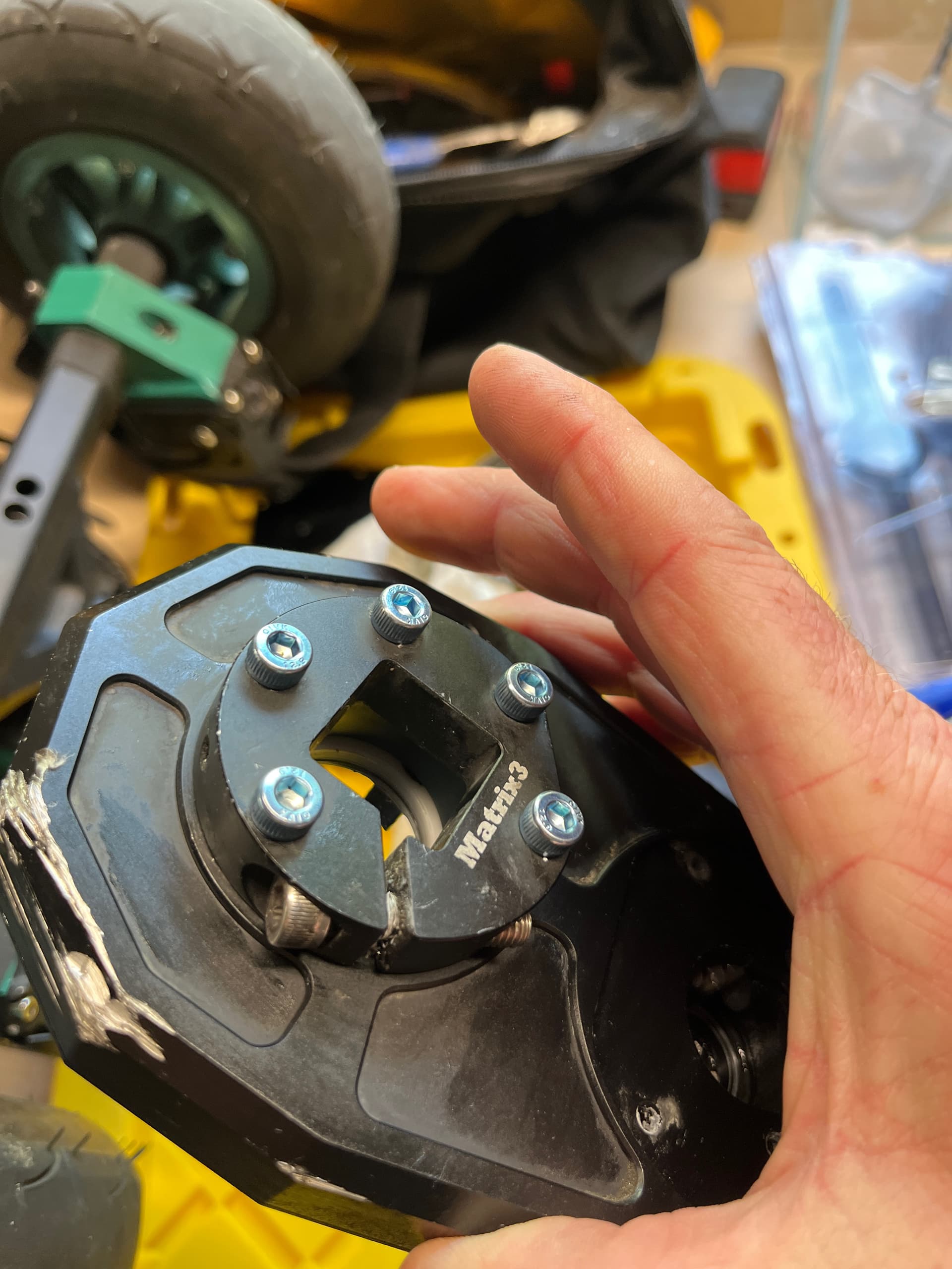

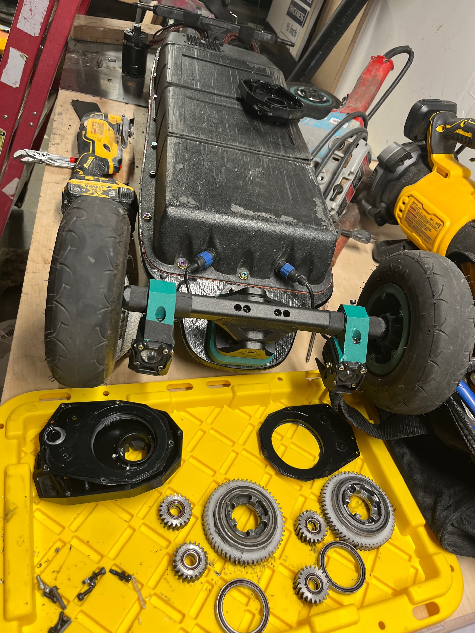

Absolutely trashed my gear drives, was racing a rar (dumb i know) on alki at about 35 - hit a massive tree root, got air (this boy don’t fly) landed on second root and banged the drives hard. This is what i suspect stripped some or all of the m4 bolts that connect the clamp to the drive. Got another 2 miles down the road towards home and the clamp completely disconnected from the drives and i took a superman fall at 12mph. Attempted a roadside repair but no luck. Uber of shame time but wife was up and happy to grab me.
All in all it wasn’t that bad. Got some shiny new m5 by 18mm to replace them. Original bolts were 16mm but had more room to engage further so i used 18mm but had to file the last thread off if them to make sure it didn’t interfere with the spur gear bearing. Gave the locktite a full 72hrs to cure and put it all back together

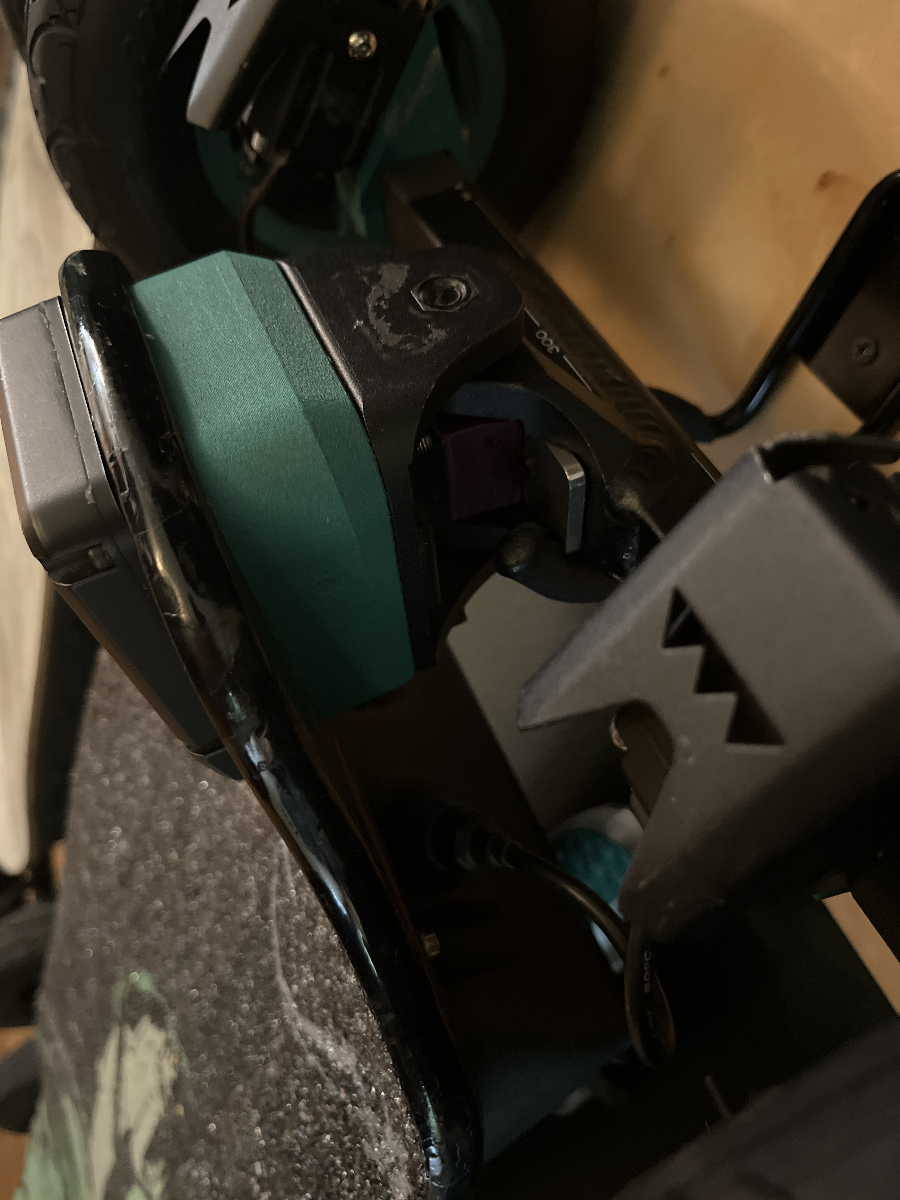

Also redid the light mounts as one had gotten loose from abuse. Was going to replace the sensors but got impatient and had loaned out my gear puller. Next time

So all back together…
