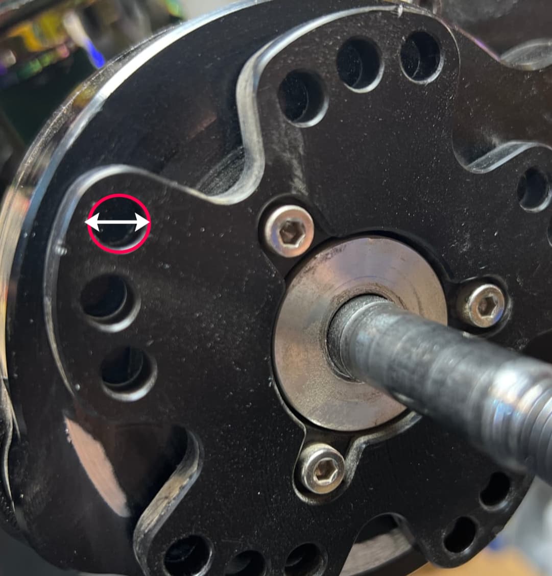

Can anyone give me this dimension?
Edit: it’s 5.5mm
Edit Edit: Kevball lied, they’re 6.3mm
The pegs are ¼” / 6.3mm diameter, 8.3mm long
@Boardnamics you dirty liar
:weary_face::weary_face::weary_face:
They’re nominally 6.5mm, with a LSL of 6.45mm

Hi, does anyone know if my plate is compatible with the mbs mounting pattern? I’m currently rocking trampa superstars, but I would love to get those wheels from LandSurf, which have mbs pattern. Thanks!
yes that mounting plate is compatible with the mbs pattern. they’re the holes farthest from center
I can confirm what ash said. I’ve got that same drive using hubs with an mbs pattern
