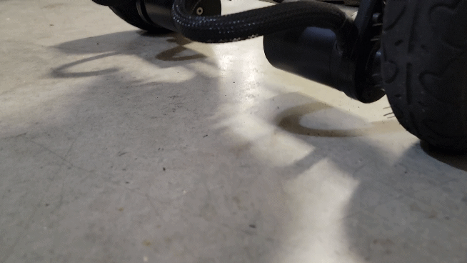

ah yeah, I see. Would be somewhat silly to do that on an MTB. To be specific it would be on a lacroix with 175’s SKPs
If you are running 200mm wheels, then the wheels are larger than the gear drives. There’s no situation (on flat ground) where you can hit your motors/drives.
Observe my shitty video skills:
20220714_172321_2
I was about to write the same. And nice video. Shows it clearly
I’ll be running 175’s so it will be very close. Thanks for the video!
if it’s any difference, running 175s with my evo & m1-ATs, i was able to drag around the board just fine… even easier now with 200s
