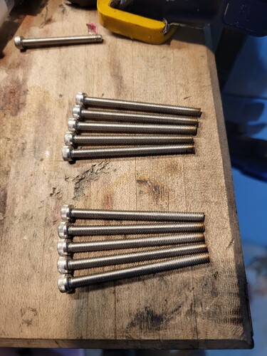

I think for phatladz it’s 50 but I could be wrong. I have megastars on right now just cause I didn’t have the right type of bolt for phatladz
Gotcha, I have to rockstars so I am now assuming they are different sizes depending on what wheel.
I appreciate it Paul.
I spent some time with the Dremel and now I have 55mm ish bolts.
so all good.
got the motor shafts cut down as well.
the 50 mm bolts did not stick out much past the nylok nuts.
this is the 55ish

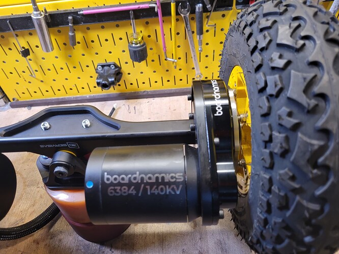

I think I will have to add speed rings to the spacer behind the wheel.
it is a pretty snug fit with the adapter.
so I am moving along.
trying to decide if I get lazy now or keep going tonight…
My adapters for Apex airs were too tight so I’m having to get them machined out wider.
Really? Maybe I got lucky but mine were perfect fit. Must be some variance on one side
