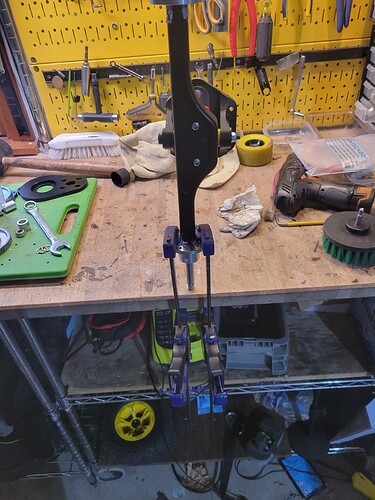

I did the inner spacer trick on the Airs like you suggested, it worked well for me to avoid the ugly extra axle length on the outside part. It made me sad as an engineer to decrease the contact surface but I think it still has more than enough (15 to 20mm at least)
and sure as shit I go and fuck up the very first step.
I love myself right now…
What happened lol it got stuck?
i didn’t put the plate on the axle before putting on the adapter.
that adapter is on there fucking right dude
not even sure how to get it off right now…
fml…
Oooof bro I’ve done that with moon drives on Matrix 2s before. Feel for ya
Put two pieces of plywood or similar material below the adapter so you dont scratch the adapter/truck, and use a rubber mallet to hammer the axle
Yep, that or an arbor press. I’m surprised it’s so tight on those precision trucks though. The Apex air adapter was a near-perfect slip fit

adapters and plates are on …
I could have also put a spacer behind the adapter to the axle…
but I dont think I am going to pull the adapters off again
just gonna put a spacer on the outside
this is what I am staring at currently…
and I think I might stop for the night.

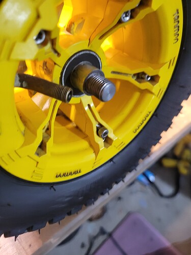

I need to cut the freaking motor shafts.
and 10 m4 bolts.
I need 55 mm and have 50 and 60…
If you talking about for the wheels I thought they were m4x45 (not sure now). If that’s the case I have a ton extra I’ll give you
