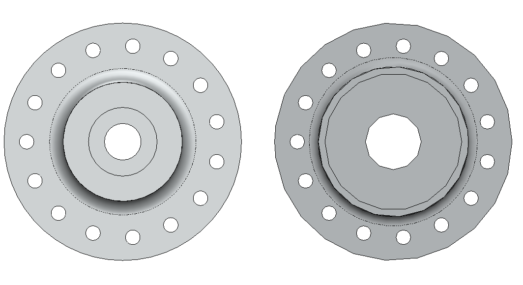

Just wanna drop this info for everyone who has a M1 AT, now currently we now because of the current hub plate design for the AT gd some ppl have been havin the hub plate break on them but others arent experiencing any issues. Thats because the mbs rim hole mounts on the hub plate metal thats surrounding it is to thin by comparison to the trampa superstar hub mount holes so basically if u ride with mbs wheel hubs u will have a good chance at potentially breaking the hub plate mount holes for mbs hubs but if u use trampa superstar hubs ur completely fine until Kevin changes the hub plate for the revised plate hes working on.
I haven’t had any troubles yet on mbs rims. Still going strong
Thats good id definitely would say try not to jump on it like at all or ram over a big bump or pothole goin 25+ as precaution.
I’ve been jumping plenty on mine with MBS rims, no issues so far.

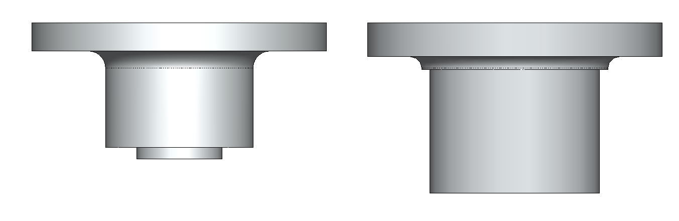

m1 vs m1-at hanger pressfit
Lost me on the 2nd half
