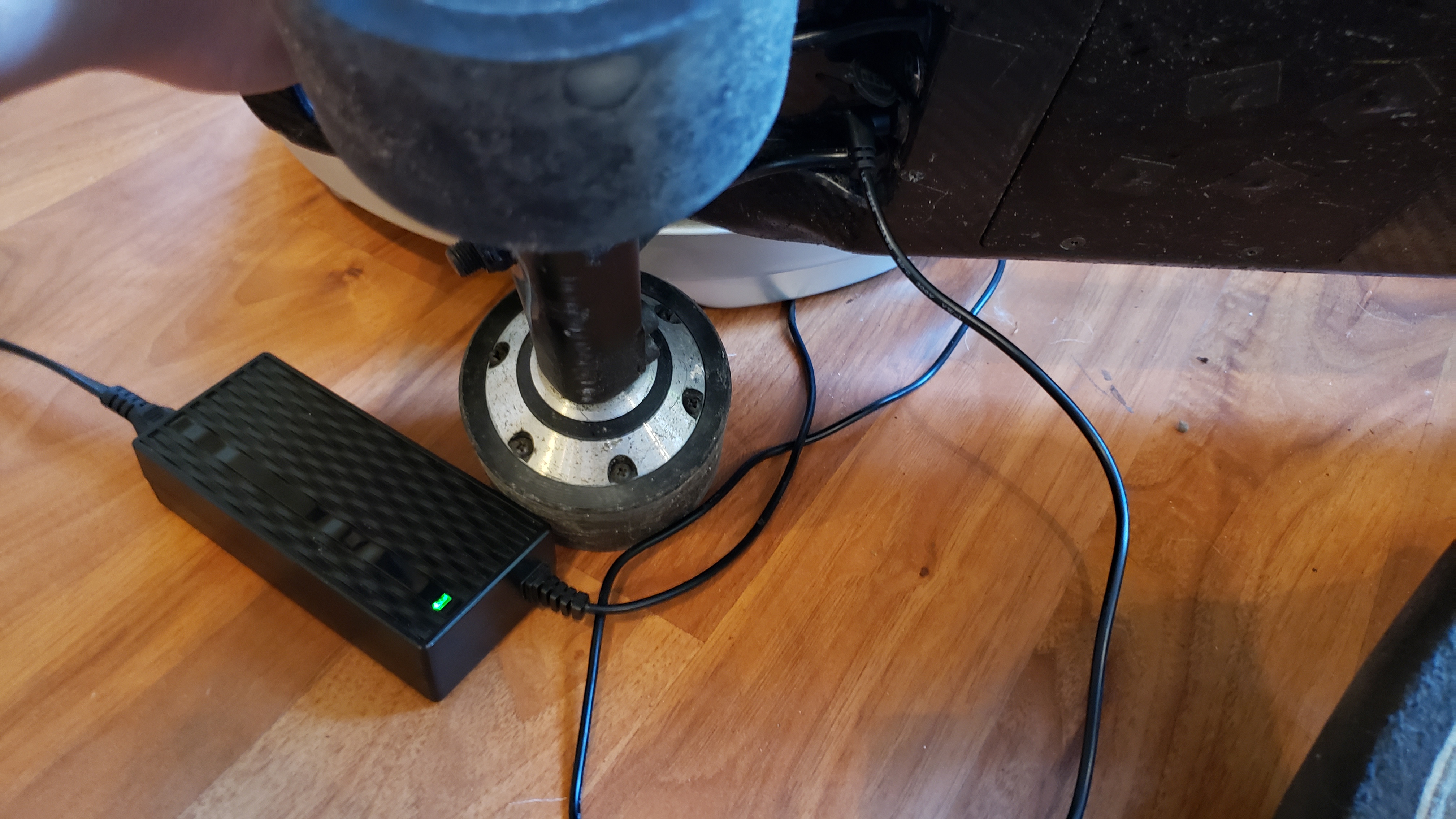

So, just bought a few new components, everything worked fine but now I am unable to get the board to turn on.
I bought an ESC from ownboard and a new pair of hubs and dropped it into a Halo Board deck enclosure and connected to the existing battery. Everything was working great for the past 20 miles and today nothing.
Here is the setup
The first thing that was odd was that I went to charge the battery (which was probably 20%) and within 10min the battery indicator turned green. Weird because normally take a few hours to charge. Upon further inspection, the battery indicator on the charger is green and every ~1-3 min it turned red for 1sec and turns back green.
Now, the power button - tried turning it on with charger disconnected, nothing. After plugging the charger in and trying the power button again, I get a brief blink out of the power button and then goes dark again.
My guesses -
  • battery may have been pushed harder then usual. torque was fine at end of ride last night, but after switching the new esc and hub a few days ago my reactions was that I was getting a lot more range then before (the old halo esc would just start beeping when battery was low and would stop giving power to hub, probably to prevent battery to go below a certain level)
  • it was a bit wet last night, something could have gotten moisture, but doubt it’s the ESC as this ownboard ESC is wrapped up pretty well).
  • power button is bad? I still get a blink out of it, so some connection is happening.
Any help would be appreciated.

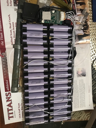

Grab your trusty voltmeter and start checking at the battery.
Sounds like BMS issue. You’ll have to tear into the battery to diagnose the pack
:beer:
Sounds good, I give it a day to make sure there isn’t moisture shorting something out and if nothing changes by Saturday I’ll open that sucker up.
Thanks for the help
Ok so I didn’t touch the board for another day and still have the same issue.
Opening the sucker up.
I tried to test every cell in there and getting 3.8v - 3.9v on every cell. Seems OK?
The whole pack is giving ~37v out.
So now, I’m clueless as to what to check next. Not sure how to test the BMS and also not sure why I am getting zero response out of the board if my battery pack is giving out 37v as above.
Any recommendation on what I should do next?
Can you test your esc with a different battery?
Actually figured it out tonight. One of the connections from a cell block feeding the BMS somehow got disconnected. Sodered it back and voila, worked again.

The battery pack as a whole charged and discharged as expected now. Think the battery pack is saved!
