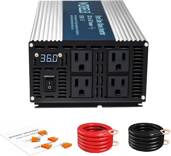

Has anyone made a circuit board or found a product that you can plug your board battery’s XT90 into and it is able to up it to 120V for charging laptops and the sort as a backup power source? I’m in SC about to get hit by the crazy ice storm so this is on the mind. If there is something I might be investing in the future. Thanks in advance!
I’ve put thought into this and it seems like there’s two options.
Step your boards voltage down to 12V or 24V then use an inverter for a car/RV. You’ll need ~42A @ 12V to get 500W for example. That’s a lot of current to convert
Use a high voltage inverter but those are rare, expensive, and big
Jumping off this and leaving out the AC Inverter usage, for charging a laptop type stuff, DC usage, would just having the right step-down converter for whatever voltage you need per device be enough to use the board as a big battery bank ? Or would the power be too dirty/other problems for that usage?
This would work fine. If you don’t need AC then all this becomes almost trivial.
Cool, I was picturing doing a 5V one in a box with a buck converter and one of those little usb c port breakout boards

I know it would be a lot of energy lost as heat, but would you just need a heavy duty buck converter to get it down to 12 or 24V before using the RV inverter? Also would the buck converter be able to compensate and maintain 12/24V as the battery drains? If it’s not a crazy task I may try to put one of these together in the future just as a backup option.
Yes this would be critical and a default feature of a buck converter

You can find power inverters intended for solar panels, and so have a wider input range. This one runs from 30V-45V DC, which covers a 10s pack, for example. You would install a parallel port in the side of your enclosure and bring the brick in a backpack with you.
