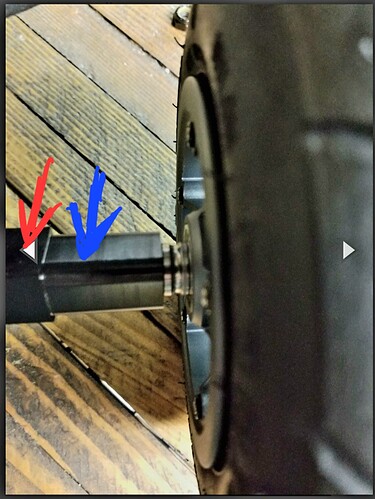

@Boardnamics can you tell me the size of the profile of these 2 different areas?
Is there any chance of making a hangar clamp / motor mount clamp for the larger size of the hangar?
I’ve got a special project im working on.
It goes from a 21mm square down to a 20mm square with 6mm radius.

Best bet is to use a Matrix III clamp and make a sleeve

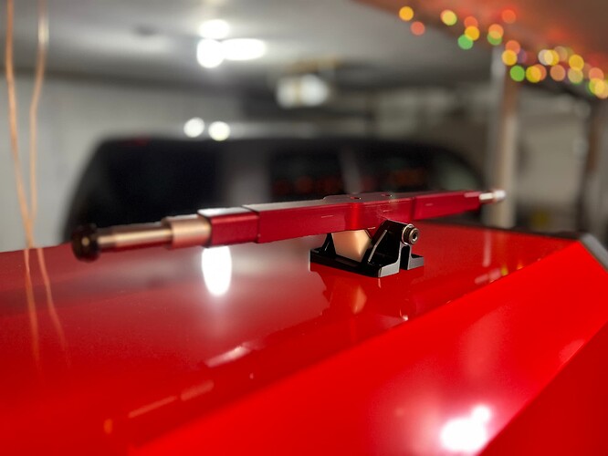

Beautiful pics @AlexB :fire:

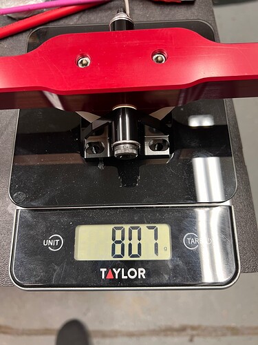

How much does a BN310 weigh?
Damn, not bad at all. Nice work mr @Boardnamics
