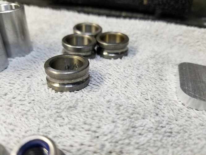

Next up is to try and figure out what the heck to do for axles spacers. The provided aluminum sleeves are too long and don’t leave enough thread purchase:
The weird grooved spacer (4 are provided) are too small:
If you stack the grooved spacers, it’s almost perfect:
The stacked spacers are ~15.8mm wide. So I’m thinking that a 16mm spacer might be perfect. Anyone have some suggestions for where to buy some 12mm axle spacers?
that’s the size you’re looking for. Kinda costly, but they’re quality. Just picked up ~10 for my various boards that have been using stacked washers and whatnot.
