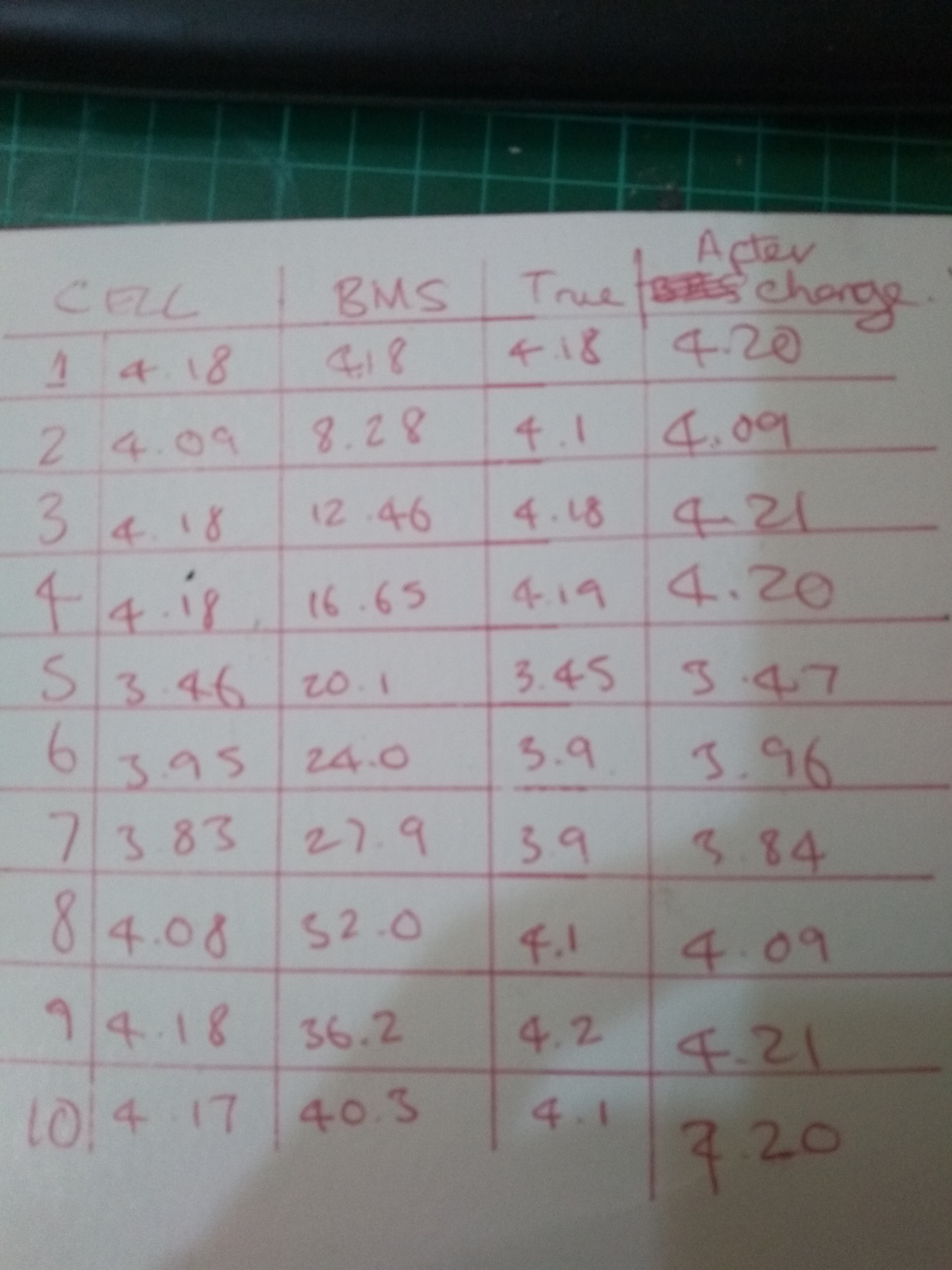

About a month ago I accidently switch the balancing leads for 2 of my P groups on my 10s4p battery. This discharged one P group to an unrecoverable level so I replaced that P group which was all fine and dandy accept my BMS will not charge the battery anymore. I have tried two different BMS’s. A besttech HCX-D223V1, and one of these off eBay.
The behaviour of both BMS’s was the same, I’ve also tried two different chargers ( both designed for hoverboards) and replaced the charge port and rewired everything for the new BMS as it’s now charge only. The behaviour I am experiencing is that it will charge for 5 minutes and then, I assume, stop charging indicated by the green light on the charger.
I’ve measured the p pack voltages at the cell level and at the BMS connection and they are the same indicating to me that the BMS is seeing the right voltage. I also tried leaving it ‘on charge’ with the charger displaying it’s green light and recorded the cell voltages at cell level again to check if it did anything and it appears not. Here is my table of results:
Cell col is initial voltage at cell level.
BMS col is voltage from the balance leads.
True col is voltage from balance leads adjusted for individual cell ( for example bms10 - bms9 = True10).
After charge is the voltage measured at cell level after ~3 hours on charge.
As far as I am aware the disparity in voltage level is exactly the scenario a BMS is used to rectify. I thought that maybe the cells are too out of balance for it to work but I couldn’t find any information to suggest there was a limit on this.
Does anyone have any idea’s about what I am missing here?
your cells are really far off.
try to charge the individual p-packs one by one up tp 4.20V than discharge them till 3.6V or something around there and see if the BMS will work than and how much your packs get out of blance during the charge/discharge cycle.
The p group with 3.5V could have a bad cell in it.
Some BMS just balance during the time of charge. as soon as the charger switch off the bms stop balancing as well.
means as soon as your pack get more then 0.2V isch drift inbetween the p groups the bms will not manage to balance the groups out.
P group 5 is the new group, which is why it has such a high disparity. As the battery is a year old I doubt my packs will maintain a 0.02v difference concidering p group 5 is brand new…
you can´t just slap in a new p group on storage charge voltage to a near fully charged pack and hope the bms will manage.
charge you p groups individually as I said till they have the same voltage. After that the bms should be able to balance the pack in future if there is no other issue in the old cells.

Yeah I would suggest them being between 0.1v of each other if possible, it would probably manage that just fine but some of the differences are quite a bit, and since there are differences across the board, if it could balance it, it would take quite some time.
I’ll stick all the p groups below 4.09 on a charger this evening and see how it goes.
Rember you need a cc cv charger some so called cheep China ones do not do this and just switch of if the current draw drops off below a certain point not alowing the BMS to work properly
With large differences it can take days to balance a battery as thay work by adding a tiny load to the highest voltage p group. others work by only looking at the voltage difference in the p group next to it so you end up with a cascade effect across the battery as it discharged the higher p group as it charging. Some will only discharge a couple of p groups at a time. There are some of types iv come across so fare.
