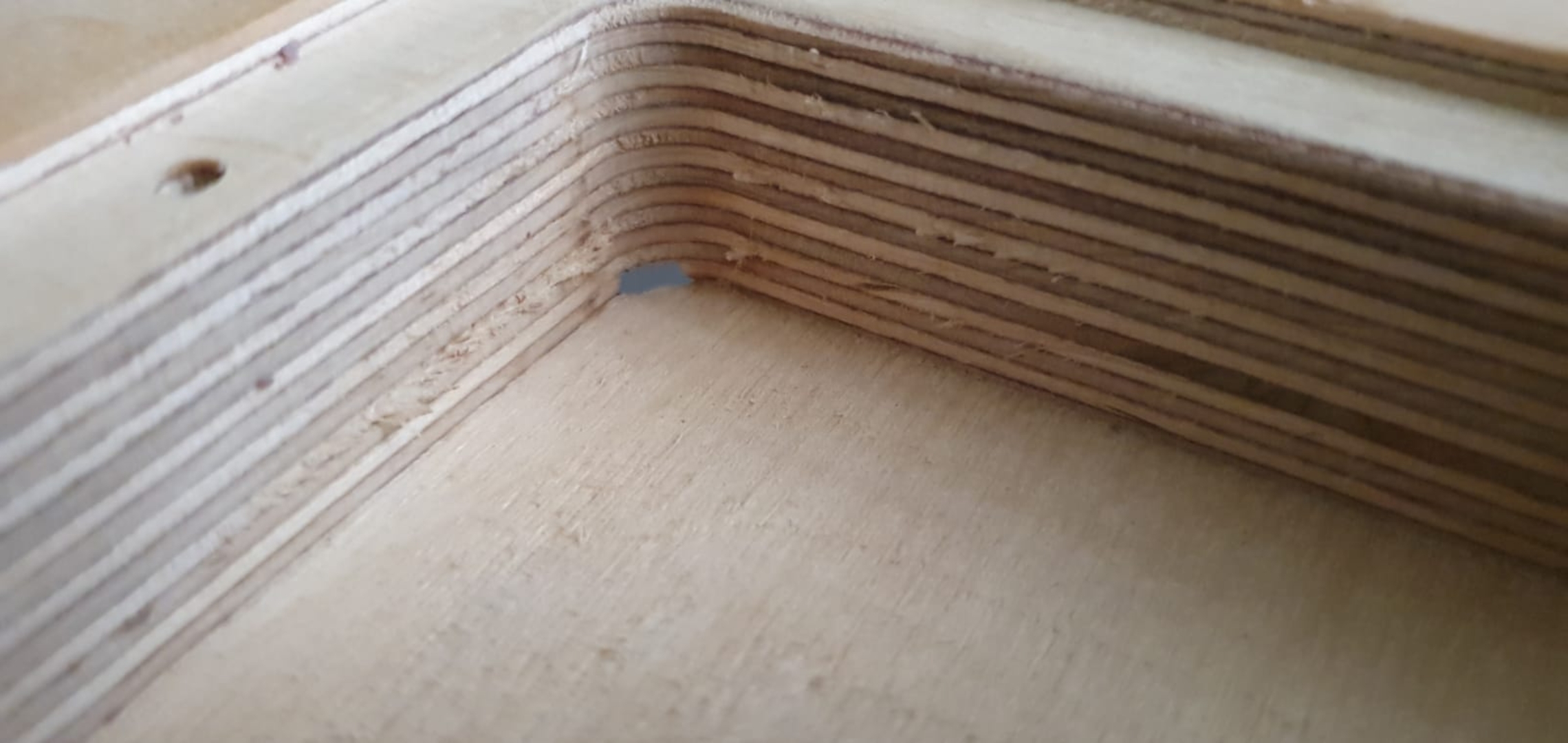

Some pics of the deck.
Comparison on the Chonk deck that I was working on last year
From the looks of it, it seems the defects are some misaligned holes drilled, and a couple holes where the cavity of the deck meets the wheel well.
The way its built, seems to be machined from a thick piece of Baltic Birch, and then two layers of Maple veneer on the bottom, and one layer on top.
To work! First I gotta fiberglass the holes and fill them up. More to come soon.

Some work on the deck. I fiberglassed the two holes and filled many other defects. Did some extra sanding on all edges and wheel wells.
Then its primer time. I did think of leaving the wood bare and just hit it with clear coat but, old habits die hard I guess
Truck bedliner goes on, I’ll lightly sand and spray my color tomorrow. Not sure what color to go with yet.
