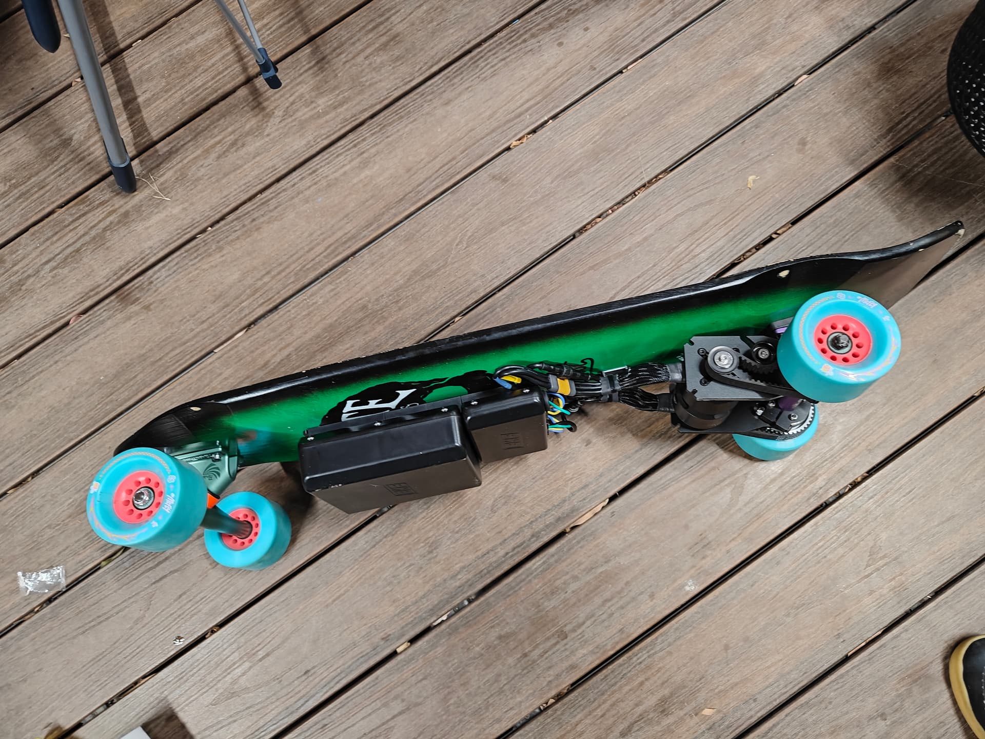

BKB Build with a Jet Vulcan 2016 DH Deck
The BKB kit was super easy to install. Just wondering how to configure it for pulley teeth, speed, etc etc.
This is really sweet.
What esc is in here?

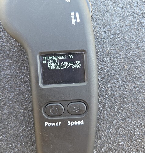

Are you asking how to change the pulleys? First step is to go to this page, put in the deets from your board, and play with the number of teeth on the motor pulley to figure out which size you want.
Oh nah, I know how to physically change pulleys. Just settings on the remote.
I had a gps speed on my phone and used it to match the speed on the remote.
There only thing that changes is the “wheel speed” setting.
Not seeing anything for pulley sizes or wheel sizes like on my other boards
LingYi
I think you should reach out to bkb to see if the lingyi can be adjusted like that.
I am really not sure.
@SternWake dont you use this esc? :grinning:
None of my Lingyi’s ESC nor remote have looked like that.
It’s a BKB specific set made by LingYi
