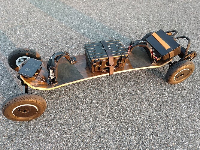

I had seen that in the past, but I want to avoid having anything under the bottom of the deck, where it could get ripped or damaged from curbs or debris.
Seems like you’ve painted yourself into a corner a bit with this requirement. Enough Velcro / dual lock to be secure is too much to remove easily. Straps are the only solution that might be strong and quick to swap - you could permanently mount a bracket to the top of your deck to avoid threading it underneath.
As far as the battery goes, you’d be better off solving the spontaneous fire concern with a high quality battery and good, supportive padding. If the battery has already burned through / smoked through the enclosure, you’re not going to want your hands anywhere near it. People tend to overestimate the amount of time they have to respond to a fire.
Here’s another crazy thought. How about Snowboard quick release bindings? Like some low profile plate type with some old boots. Carefully remove latching component or hacksaw bottom of boot off and attach to battery box?
More charging adventures. After blowing up my first BMS due to likely plugging the batteries into the balance leads in the wrong order, I got a second BMS. I’m a little worried about plugging everything in correctly when charging on the go, so I’m now thinking about leaving the BMS in the battery box rather than being attached to the charger. Problem is there’s not really any space for it, as the middle is where the wiring goes, and the batteries reach to almost the top of the box, and the foam squishes it down pretty tightly. If I remove the egg foam in the lid, it can barely clear, but then nothing holds the batteries in place. Would there be any issues with stacking the BMS on top like this? Maybe I can stick it under the foam in the lid?
Either way balance wires are going to be a bit of a rats nest, which isn’t ideal but is hard to control when everything is designed to be removable (For context I would normally still use a 1A balance charger because I don’t need quick charging all the time, and I’d like to extend battery life). An additional slow 12S charger would solve this problem, but that’s currently not budgeted. Can the LLT BMS limit charge amps through the app? I don’t believe it can but that would solve this problem too.
Overall I do like having the box removable, makes it super easy to just pull it off the board and charge it wherever, and not be limited by having to drag the board to an outlet, especially indoors.

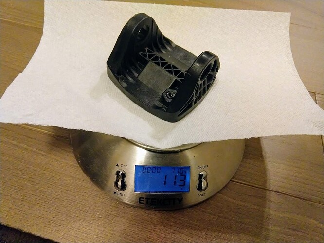

Another minor update time. Took advantage of the Black Friday sale to upgrade the plastic Matrix baseplates to the metal ones. The footprint is way larger which is good, and they also happen to be exactly twice as heavy, which was more than I had anticipated. All in all it added an extra half pound to the board, which is probably worth it for the extra durability. I wasn’t sure whether the shock pad was necessary, but I put it on anyways since it came with the baseplate and protects the deck I guess.

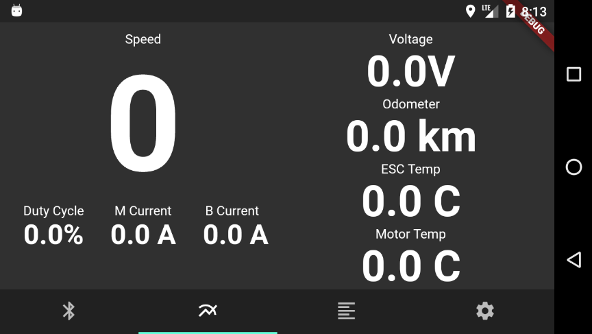

Final change was to the phone display itself. I found the original design still a bit too small to read while standing, so I made everything larger. I removed the title bar to gain some vertical space, and simplified the right hand side by moving stats I don’t need to under the display so I was left with 4 large numbers instead of 8 smaller numbers. It’s a little easier to see now, and less cluttered for easier glancing.
Finally, it turns out that shaking the phone would trigger the debug log, which ended up happening a lot when the phone was mounted to the deck. Shoutout to @skate420 for identifying the root cause! I fixed that, and now it works perfectly. I’m still running into voltage discrepancies as the battery drains compared to my voltage alarm (4.2V is 4.2V, but it shows 3.9V when it’s 3.8V, and 3.7V when it’s 3.6V?), but it’s not too difficult to account for that. I’ll need to run more testing to figure out whether that’s an early uBox thing or a rounding/measurement thing.

Lots of minor updates to the board. Here is the board in its current state:

I also made a couple of minor updates on my Freesk8 dashboard. I removed the smoothing function on the voltage readout in an effort to make it more accurate, and it is to a point. I still seems to be overestimating voltage under 3.7V, so I need to look more into it. The other thing is I flipped duty cycle and speed. Since my top speed is fairly low, it was more important for me to know how much I have left than my actual speed, and it has been way more useful as a proxy.
