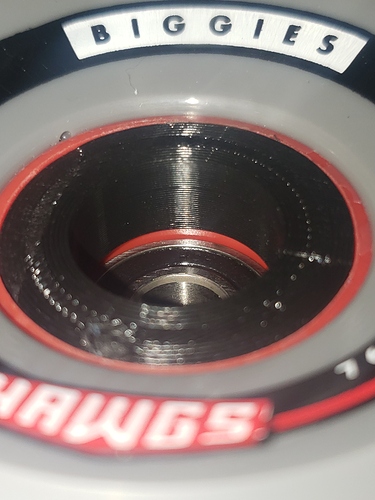

The plan is to have 4 of those prongs and then 4 screws to make it bolt on. The screws have to be m3 so I might have to make it 8 screws 2 each hole for the added strength.
Fits perfectly with the awkward curve of the biggie cores.

The actual design looks like this.
Those look a little short, honeslty. The more surface area in contact, the less wear and tear on the wheel core. Of course without being excessive, like the photo above it :rofl:
Yeah, but I also have to be mindful of CNC limitation.
I can make them a little longer but not by much.
The plan is the spokes take the load from the pulley rotating and the screws hold it in from backing out

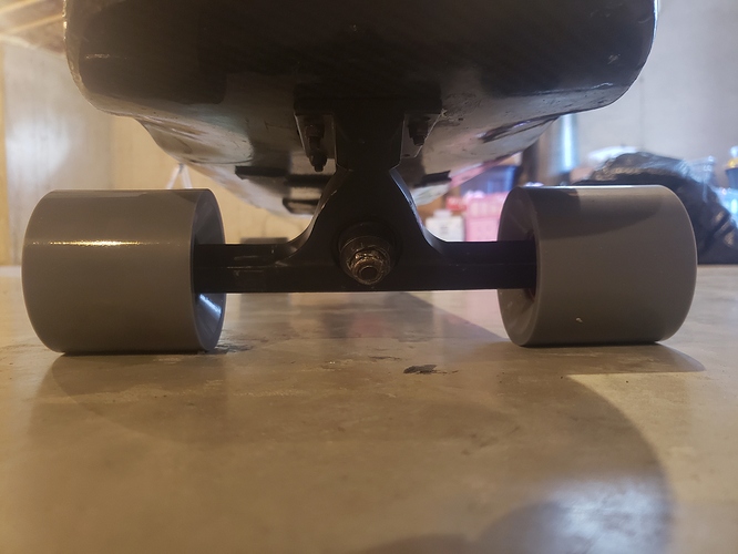

Been breaking the wheels in, mabye about 15 miles on them so far and Im really loving them on this set up.
Caliber 2 RKP rear with SR TKPs 50mm axels front
The wheels are perfect for this set up as they grip well but slide out easily with no need to force it even tho there 76a.
This is the most chunking I got and that was because I hit a rough patch way too early into breaking them in
