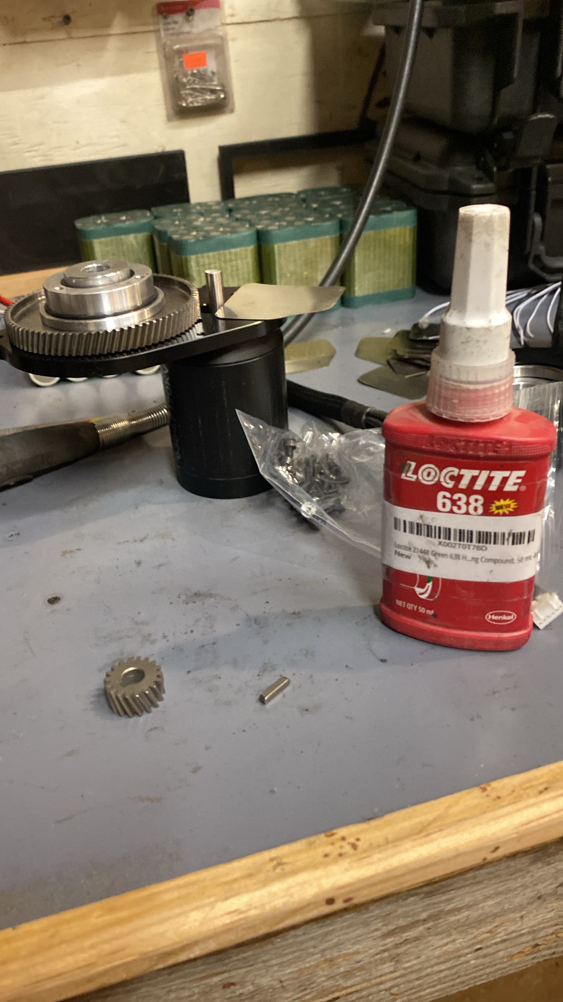

Could you mail me some of that 638 in a ziploc bag? I’m a little strapped for cash this month.
If he doesn’t I can send you a bottle if you need it

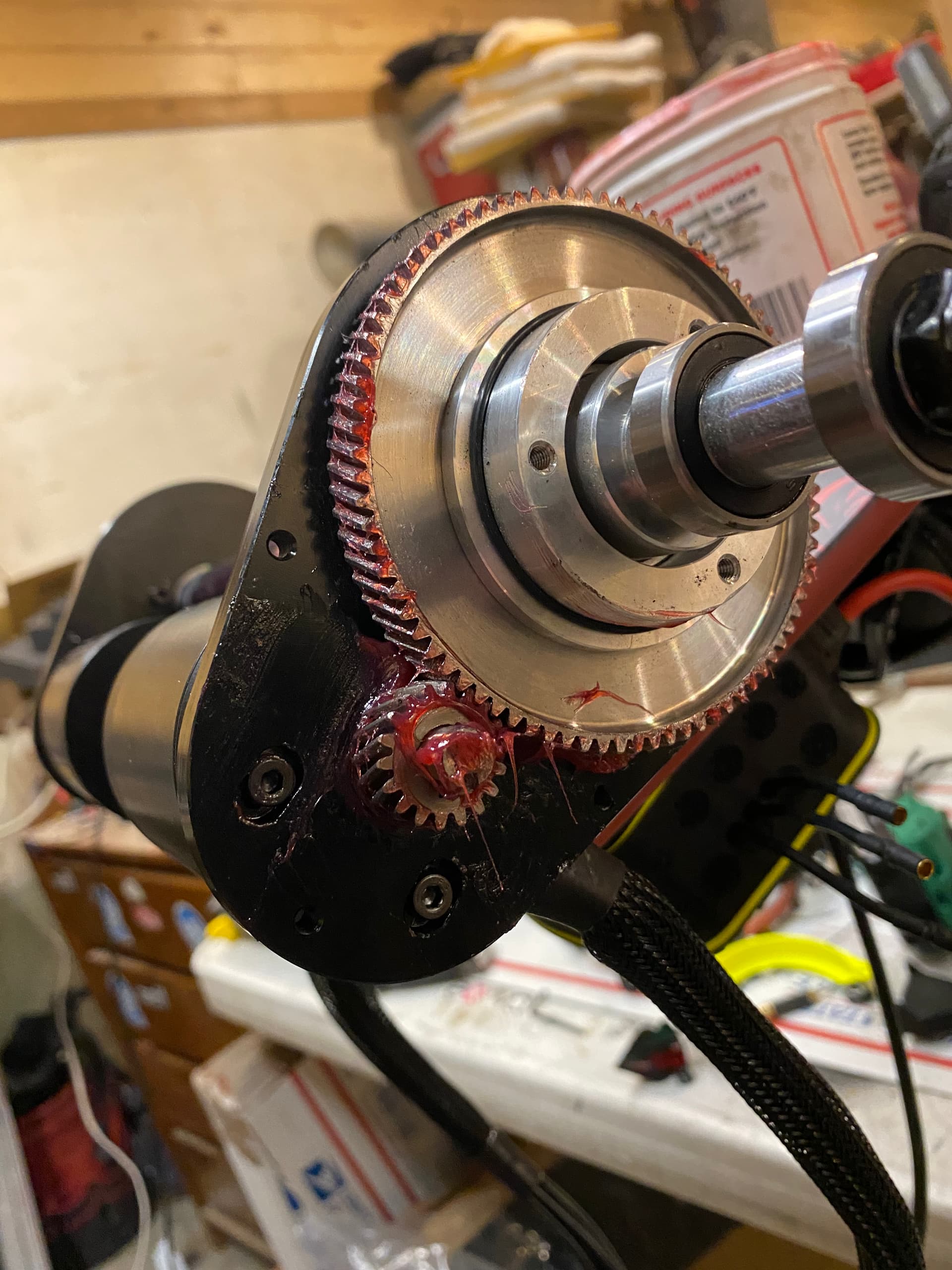

One would think that the @Boardnamics branded motors would have the appropriate shaft size to be directly compatible with the BN gear drives. Is that not the case? Am I missing something?
You truly are the nicest guy in esk8, Bao :heart: I was just making a dumb joke haha. This is why I shouldnt be allowed near a computer, ever.
This was the case on his previous batch of branded motors, yes.
On this current batch of branded motors, for a number of reasons, Kevin didnt get the shafts cut.
As a general rule? Yeah :wink:
Dude when I bought it it was the only size I could find… :joy: I might be able to send you some in an old vape juice bottle. Apparently it’s the absence of air that activated this stuff…
It used to be so but I imagine he had problems with belt drives or it cost more to have them made shorter. His parts are super inexpensive.
Quit flirting with Bao… he’s mine.
Not a chance. He was mine first, and always. I’m never giving him up, no matter how many batteries he buys from you :rofl:
As others said, not anymore. Also if you don’t want to cut them yourself, you can have him cut them before sending to you
And yes, very inexpensive

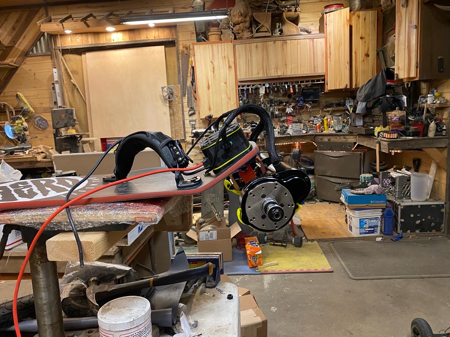

How much louder are steel/steel helical compared to steel/POM? Also the weight difference should be noticeable?
More quiet than moon drives. And yeah a tad heavier. BN is a much easier install.

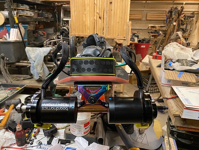

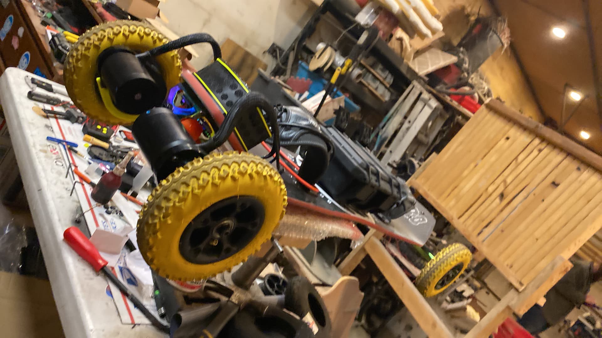

Also this bro build is almost done and is for sell… I haven’t mounted the battery box yet incase someone wants a bigger battery.

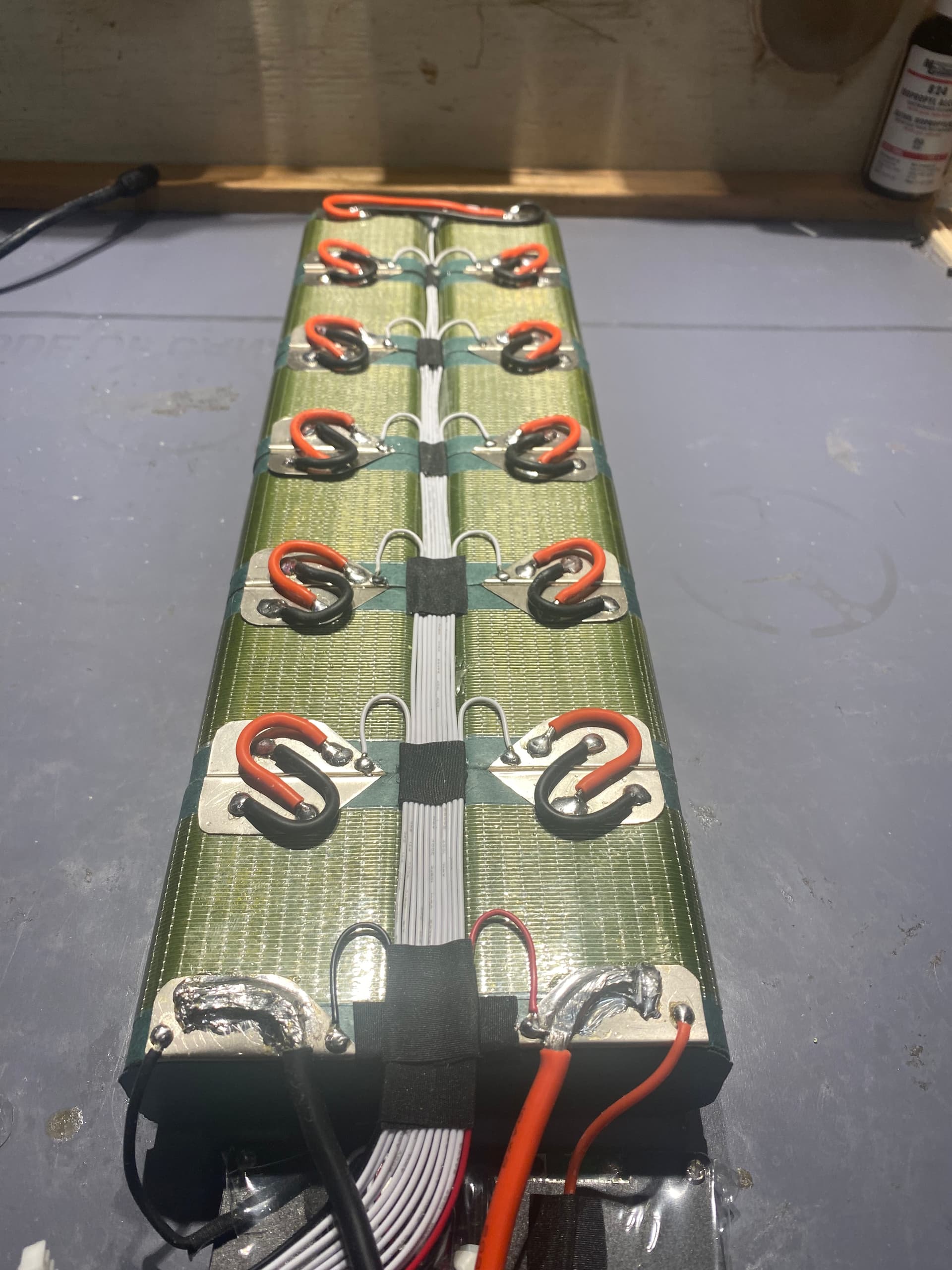

Currently 12s4p p42a
Matrix 2s oilslicks
BN gears with 4.60 gearing and 170kv motors
Dual Foc boxes
Hoyt puck in a poast case
Five star wheels.
4a charger
New gen Bro deck.
All parts are brand new.
$2349.99
