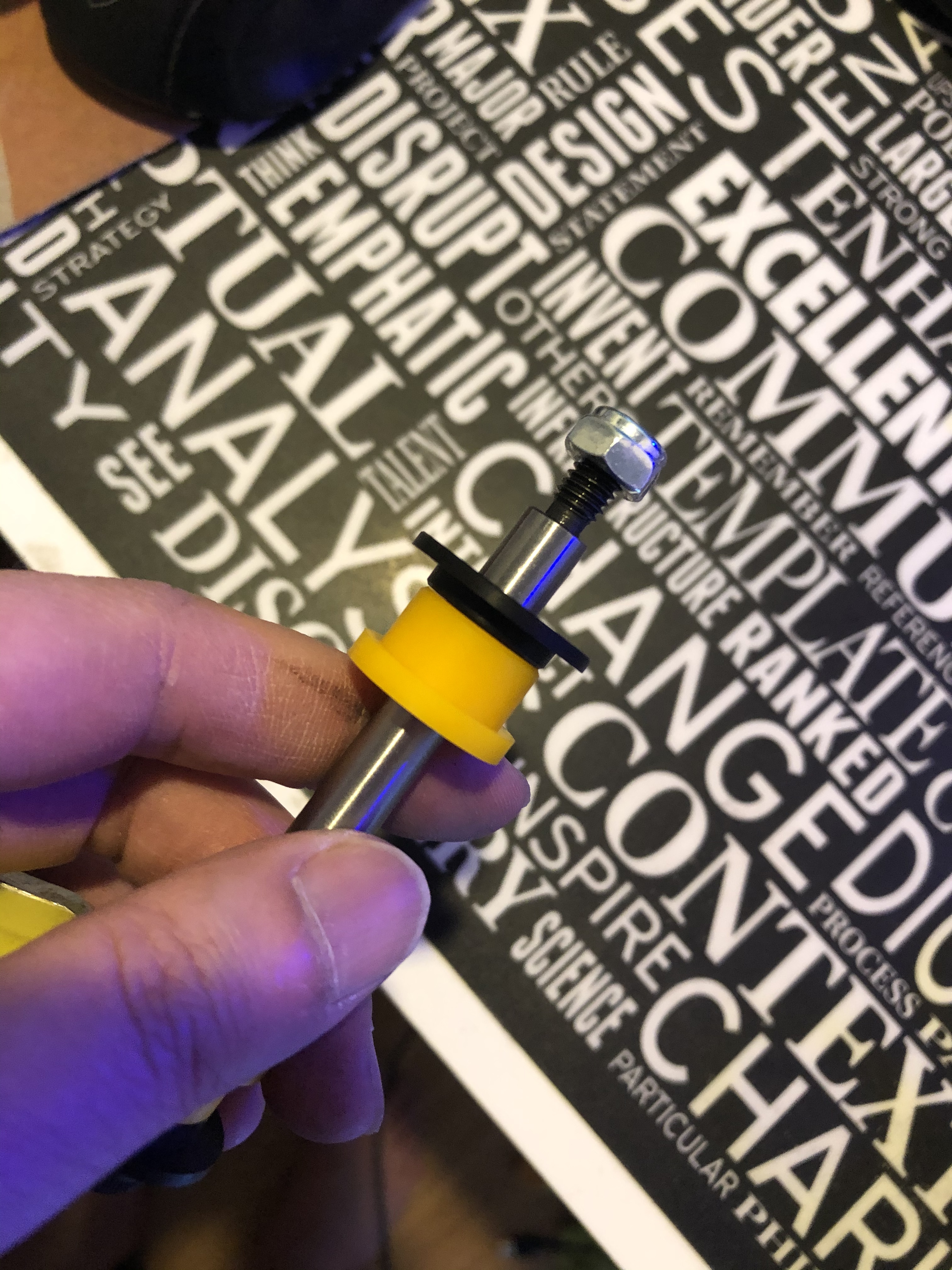

A good example of the “attention to detail” @3DServisas put into the drives. The included bushings are a 4 piece set and solves the metal to metal contact issue mbs metal base had in the past. Required? Probably not. Bloody nice to have? Hell ya.
