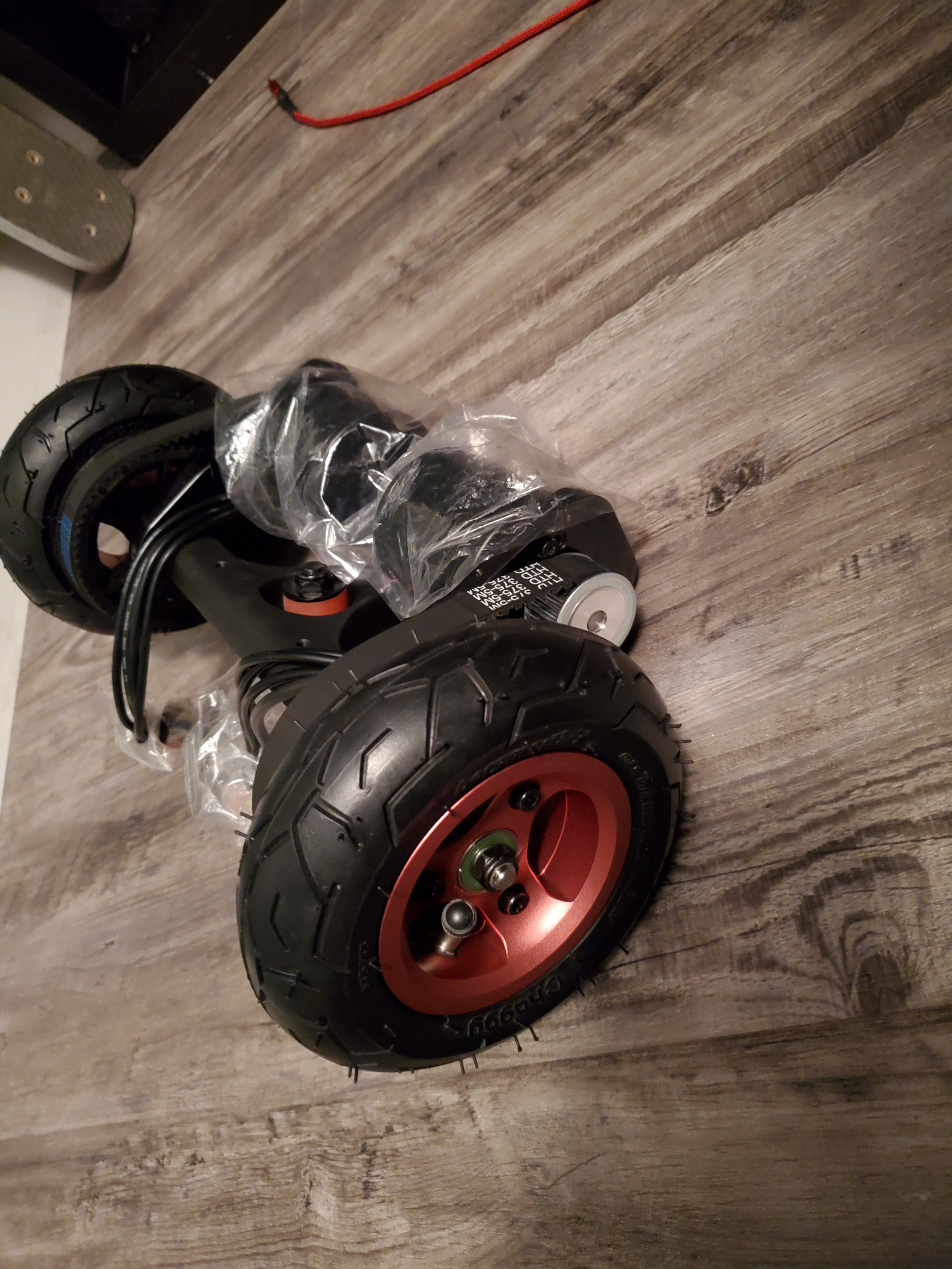

Alright I’mma document my first build here to keep me honest. My first diy that I worked on was the silver dollar (thanks for the name btw @CiscoV) but honestly @Winfly did most of the heavy lifting and I just ride it. So here we go.
Parts List
• Century 40 deck
• Eboosted century 40 enclosure
• Hyperion 40t 12s4p
• OSRR dong remote
• Haggy AT kit with 20t motor pulley/ Kahua Trucks
• Focbox Unity

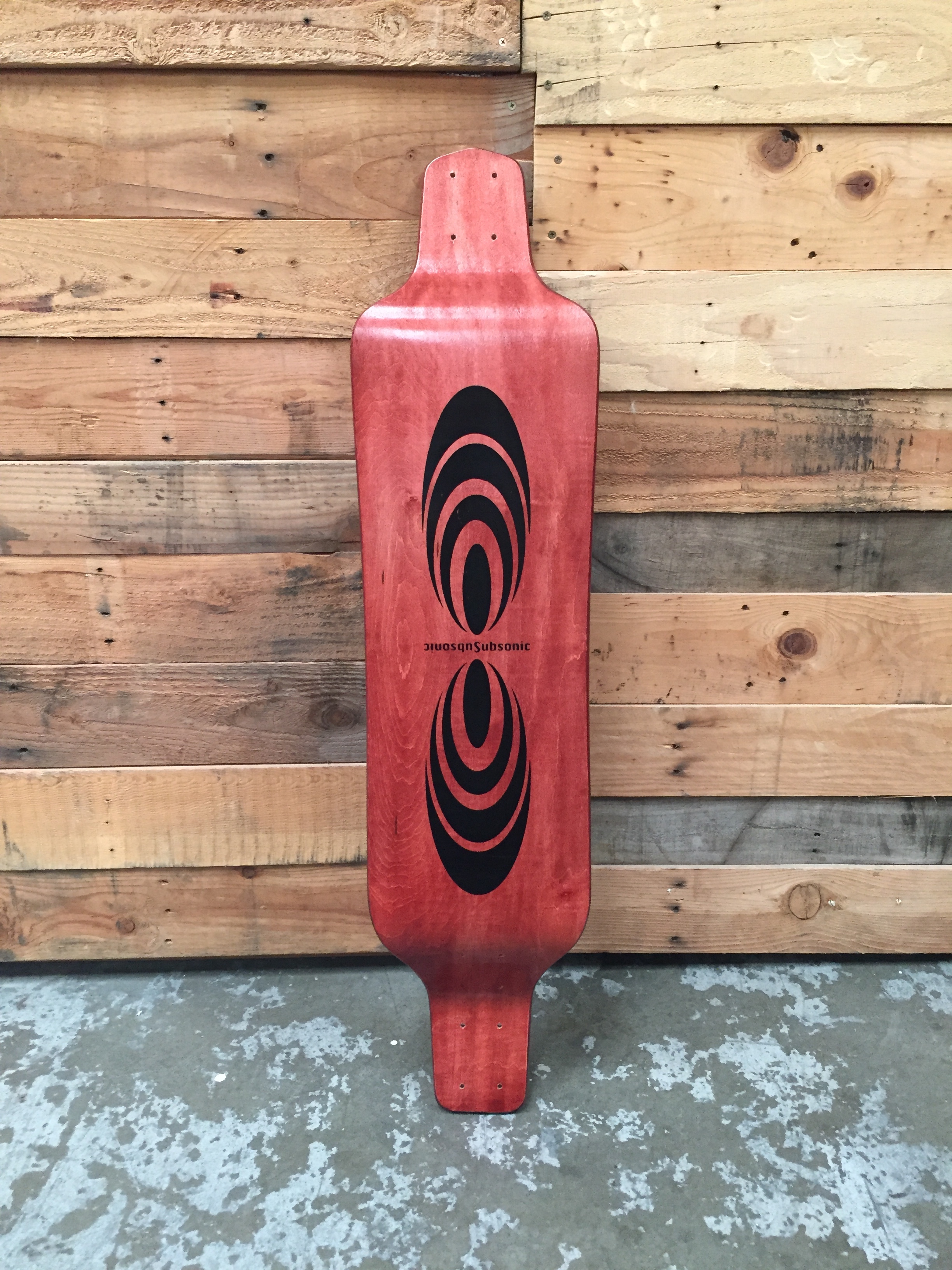

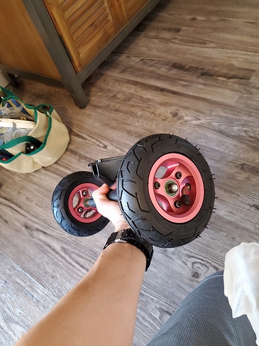

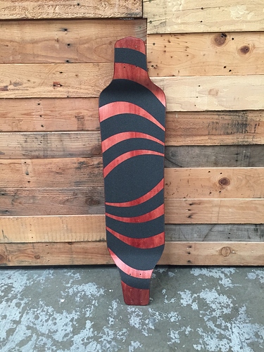

The parts I’m waiting on are the OSRR, 20t motor pulley from Dicky, Battery from Hyperion (Should be any day now🤞) and a new deck which is being stained at Subsonic. I drilled my OG deck to hell so I figured this would be a good opportunity to get the deck all burgandy to match the haggys. Here’s some pics of the parts before I start assembling everything in a week or two

If you do wanna go 20t tho you have to get some expensive ass super low profile screws for the motors

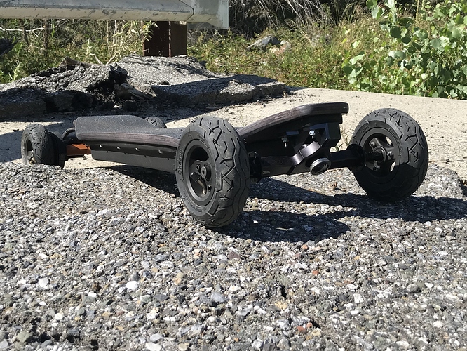

I suggest you make new baseplate holes towards the end of nose and tail, the overall look would be sweeter and you will have more room for motors.
I’d also suggest you mount the motors outwards, I used it inwards for several months and thought it was good, however, when I switched them to the rears the clearance was nothing but great! I’m now able to run for every path without rubing my motor mounts and the motors haven’t got a single scratch ever since
For sure, outward is always better. Especially with rough roads.
I’m pretty hype to finally have a remote that has dual purposes
Yeah. However, you might need special longer motor mounts as they need to clear the Surfrodz baseplates with the motors

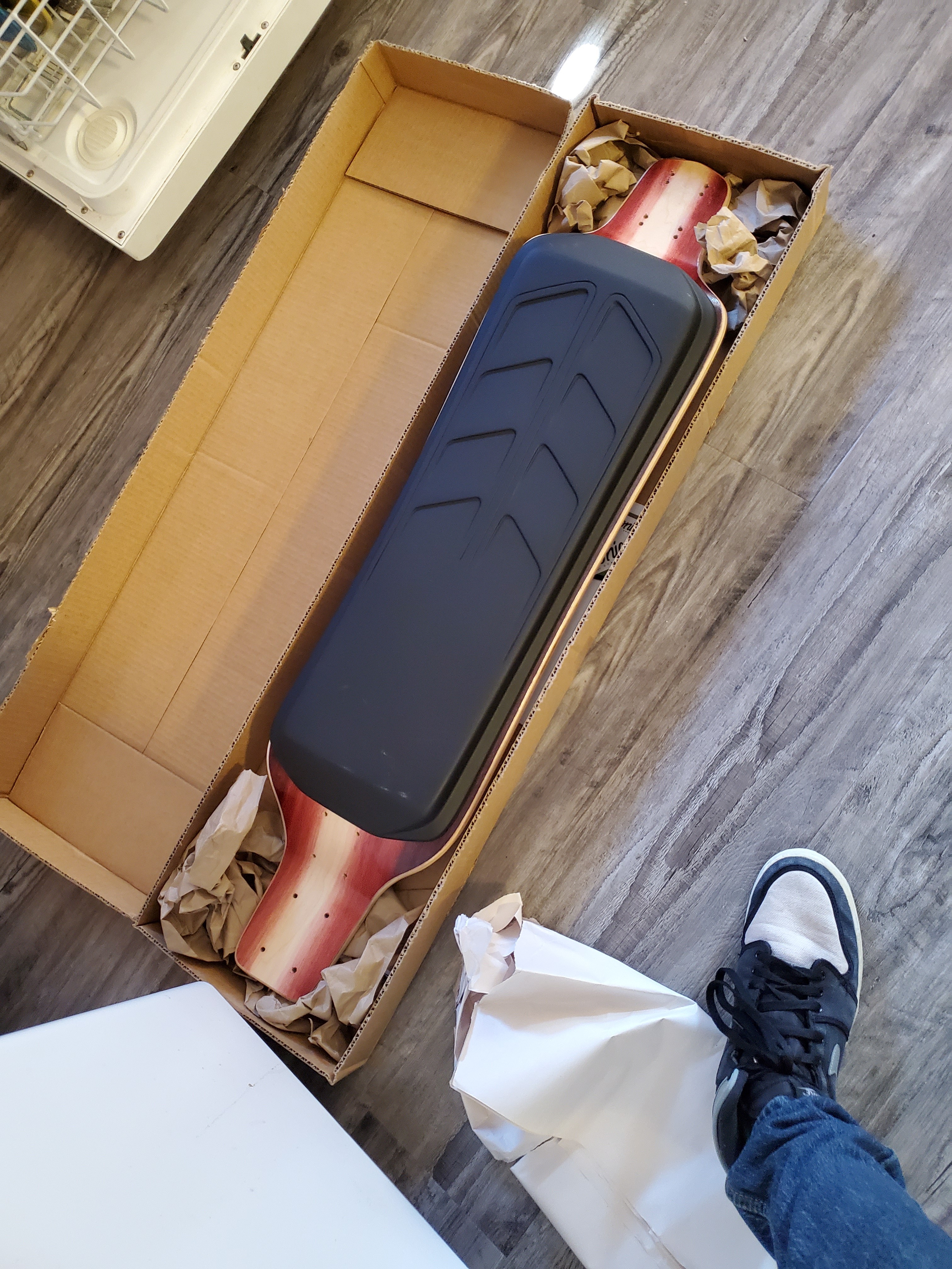

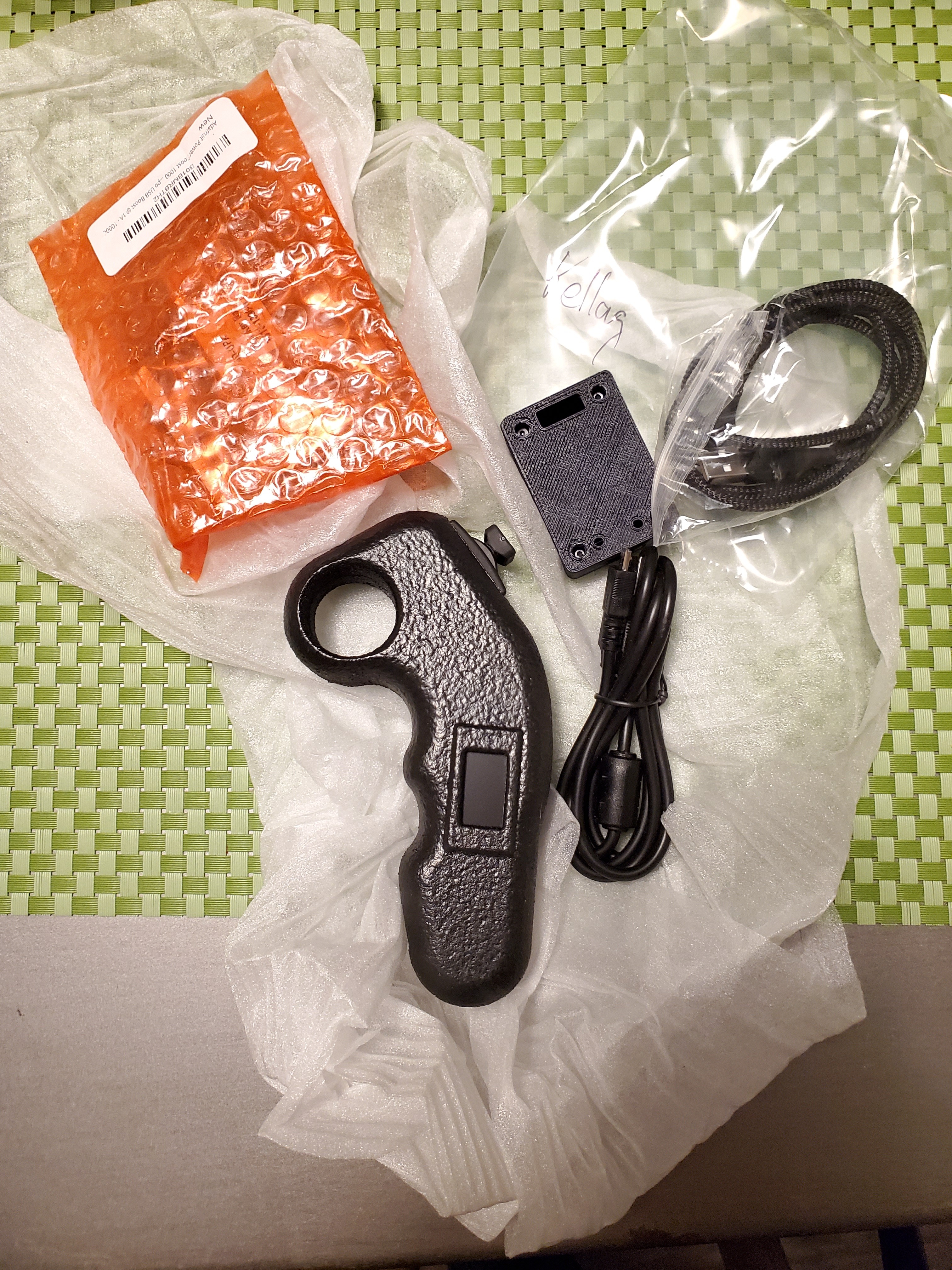

Just a couple quick updates to the thread, I have almost all parts in house now just waiting on the pack from @hyperion1 (cool dude btw) and the stained deck from subsonic.
Just got the OSRR in and I got some 5.5 to 3.5 bullets from @ZachTetra.
Also just swapped the 15t motor pulley on the haggy kit with a 20t for an estimated 39mph top end. I love @haggyboard.timo and he keeps sending me tubes lol, much love.

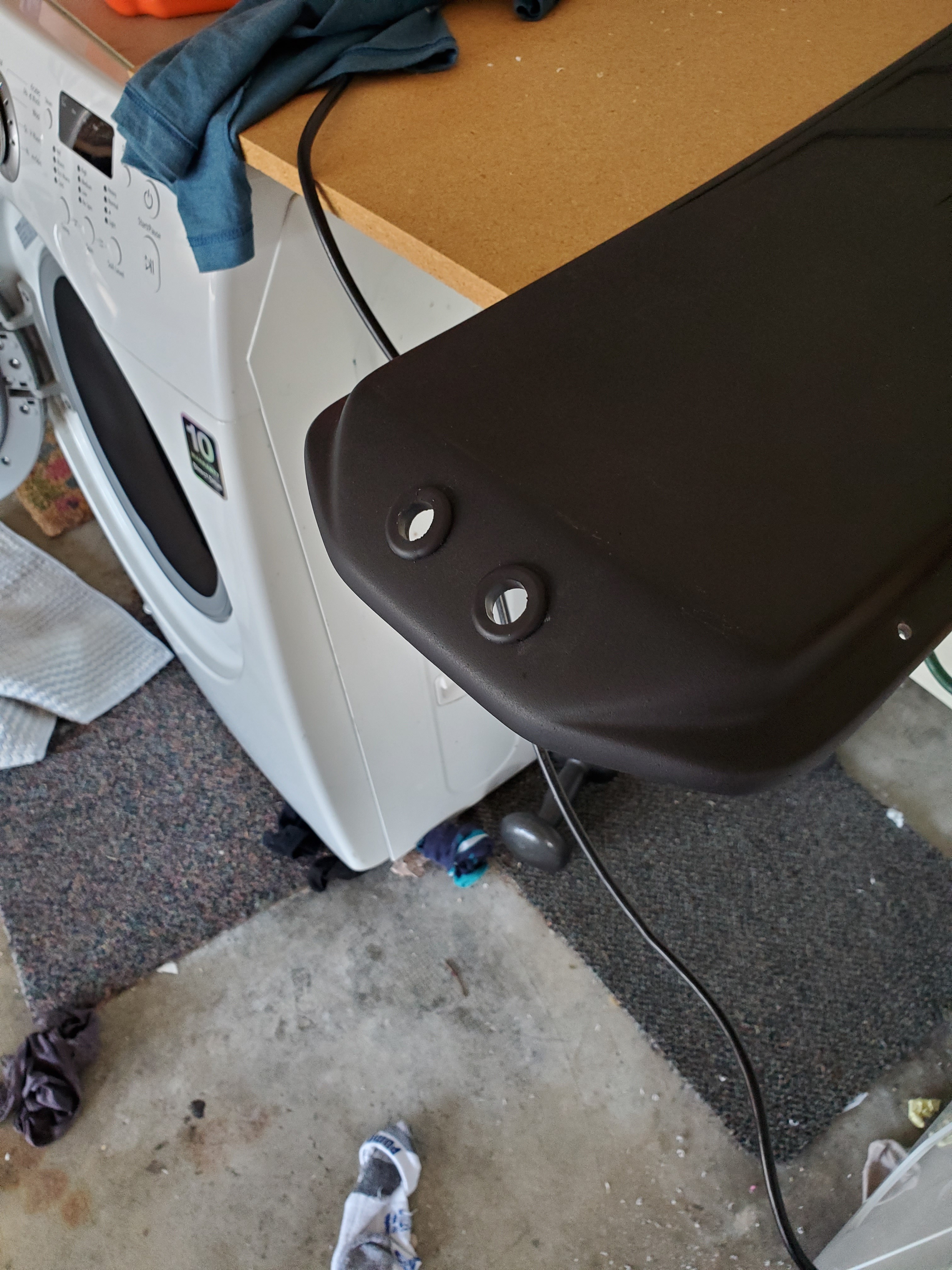

Lastly I just drilled two holes in the enclosure and put grommets in so the wires can slip in nice and easy no lube required. So that’s all for now. Build should be done very soon🤞
nice build you got here. I plan to do something very similar but with an evo… But Lube?!? Why the fuck do you need lube!! My daddy always told me “If it don’t fit, just add spit”. Worked for me so far
Deck from subsonic is done, last piece of the puzzle is the battery from @hyperion1 which looks to be done too :slight_smile:
