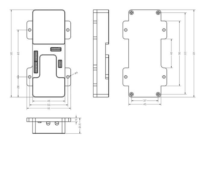

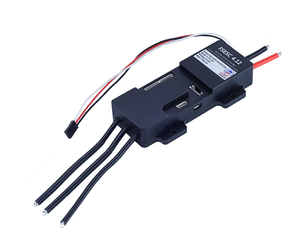

Can I pleas get some advice how to best waterproof my esc. It’s a flipshit FESC 4.12
with the aluminium case. :smiley: Should I do a conformal coating first or just plug all my connections in and seal it in clear heat shrink and silicone the ends before hating it up?
A lot depends on whether you need to mount it to something that will help keep it from overheating (if you’re using it hard enough for that).

I used to waterproof ESCs with conformal coating, but my advice now is “don’t”.
That’s because I discovered butyl rope… you can make the enclosure crazy water tight using that stuff and then not worry about water inside, if you do it right. Often putting a thin sheet of rubber on top of the enclosure (sealed with butyl rope) before affixing it to the board works really well, and then the wood/enclosure interface doesn’t matter at all and needs zero waterproofing or gasketing. Also be careful running wires out of the enclosure: in general, I just don’t do it. At all. I epoxy a connector through the enclosure and then plug into it on the water side. (on the outside)
