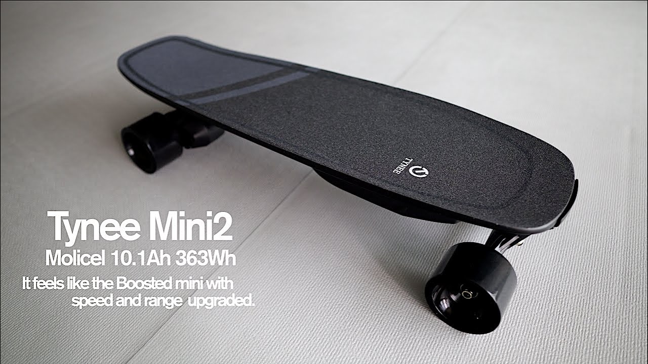

Can I ask why you didn’t mention any of the lies about battery capacity and the fact that while they’re technically using molicel cells, they’re an old and low performance model?
Had to chuckle a bit
So is this what they said they use on the 216 Wh board? https://www.molicel.com/wp-content/uploads/DM_INR18650A-V4-80078.pdf
Yup those are the ones
Due to our feedback they removed the AH on their website. We were like wtf because their reasoning was in their previous board it was 10s 8.4ah, so for the 12s mini 2 they just did 8.4 x 1.2 = 10.1ah for a 10s equivalent. (I did have this part in the script but since they changed it, it wasn’t necessary anymore)
As for the batty cell type tho, imo using either p42a or M42a won’t be a massive different because the hobbywing ESC model they have can’t even suck that much power. So I thought giving the range is a better metric.
I was watching this guy do a teardown on the tynee mini and it clearly shows m42 20700 jingnoo new energy pack but claimed 10ah. Then he replied saying he got it wrong and it was m50 cells or something? Someone is up to onsra tricks lol. Pretty sure my jingnoo 6ah pack had fake 30q cells at 4.4ah. print was all wrong. So god knows whats really in these cell wise.
Yeah that “10.1Ah” is as I said above; to compare a 12S pack to a 10S pack using just Ah they multiply the 8.4 X 1.2 to get their 10.1. But obviously it’s nonsense, just don’t compare using Ah or rely on the consumer to know how voltage works. Use Wh FFS
But TBF the numbers do check out for M42, aside from marketing BS
