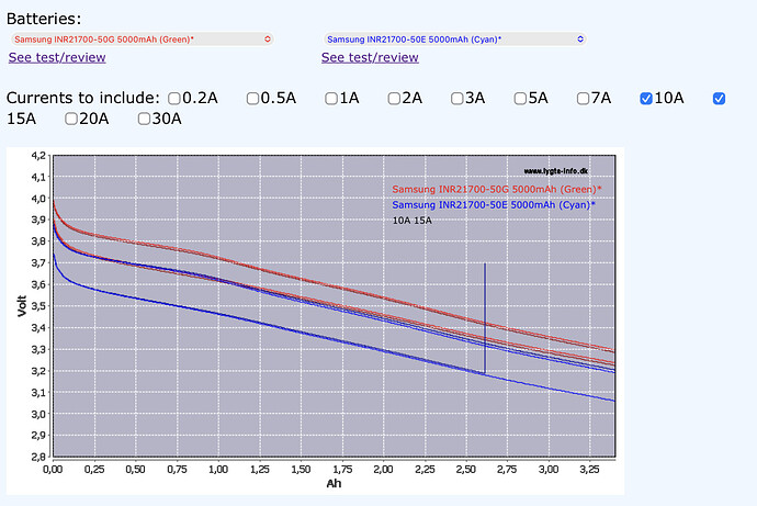

I think the Samsung 50G is a pretty good cell.
If it is 5p or more, it is worth considering.
According to this month’s price list for Queen Battery, the 50S is still expensive. Still, it was $ 10 in February.
LOL…definitely better than the 50E (in that graph). I assume that’s the 50E1?
In my informal testing the 50G performed worse than the M50LT, N21700CG-50, M50A, and LR2170SD though. Is the 50G actually in stock anywhere now?
If it was available at a lower cost then IMO it definitely could be an option for cost-sensitive applications. Are you using the 50G now?
Yea, the 50S is crazy expensive and will probably remain that way. The M50LT gives it a good run for the money but will probably be just as hard to find.
