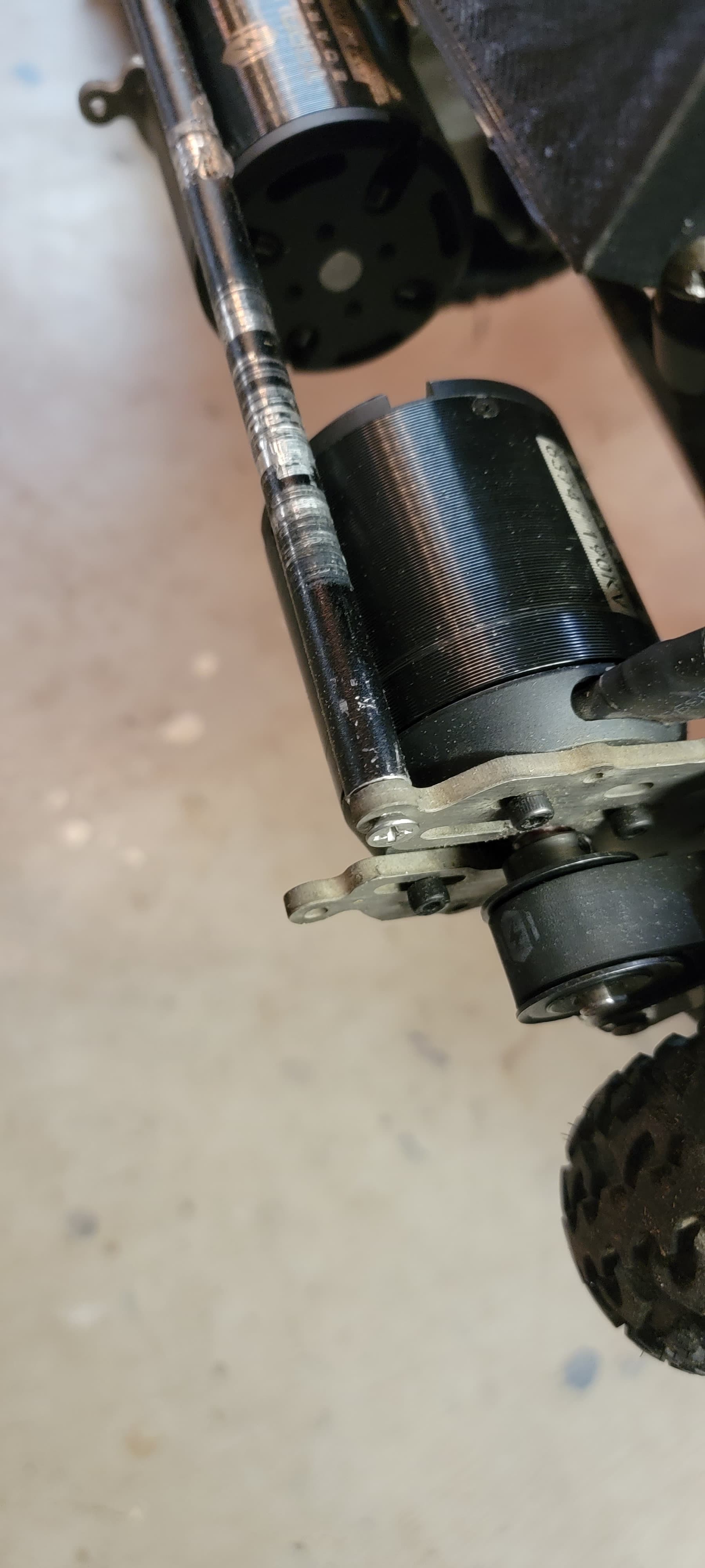

Belt Skip - how to avoid?
since ur motor is already at the very front that it can’t go any further, loosen the idler, put belt and wheel back on, then push the idler closer then tighten it. should fix ur skipping issue
Gonna try this now, thanks for the suggestion

Interesting. Normally I would say larger motor pulley & wider belts & run the tension as loose as possible without ever having skips.
But Idk something feels off. Like motor mount flexing under load. Wheel pulley being off center.

I had a weird issue with my Turnigy SK8 motors that drove me crazy for a few days. One of my belts was skipping nonstop even though the tension was good and the motor pulleys were brand new…turns out one of the bearings on the motor was completely destroyed and the bell had almost 3mm of lateral play. Under heavy braking the motor axle would get closer to the wheel pulley causing the slips. Replacing the bearing and making sure the bell had no play fixed it!

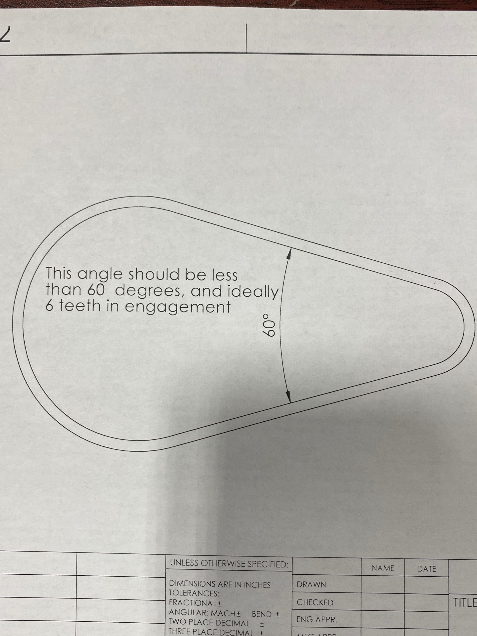

Check this

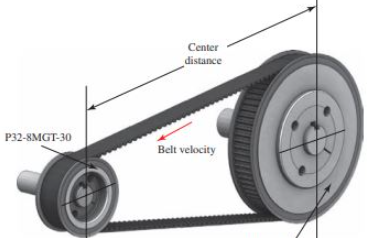

I think your center distance is way to short.
In high torque applications it becomes important.
I know theres a forumla somewhere to calculate optimal center distance but I cant seem to find it.
Don’t tensioners make it as if he had a bigger center distance? By decreasing the angle the belt comes toward and from the motor pulley, thus increasing contact points acting on the belt. I could be wrong, that’s just my “understanding”.
This is pretty much correct.
Ideal center distance will be a function of the diameters of the two pulleys
This is a good calculator where you can plug in pulley sizes and center distance, and it will tell you how many teeth on the motor pulley are in mesh.
I find that on the motor pulley, 5 teeth or less it will skip over 50A. 7 teeth or more is good for 80A+. 6 teeth is borderline. Depending on belt quality, tension and pulley condition, sometimes it works, sometimes it skips.

Adding an idler is less for belt tension and more to increase motor pulley tooth mesh allowing you to run a smaller motor pulley.

I solved my belt skipping. Added a crossbar and a crossbar for the idlers to keep them horizontal on the belt. Thanks for everyones suggestions
