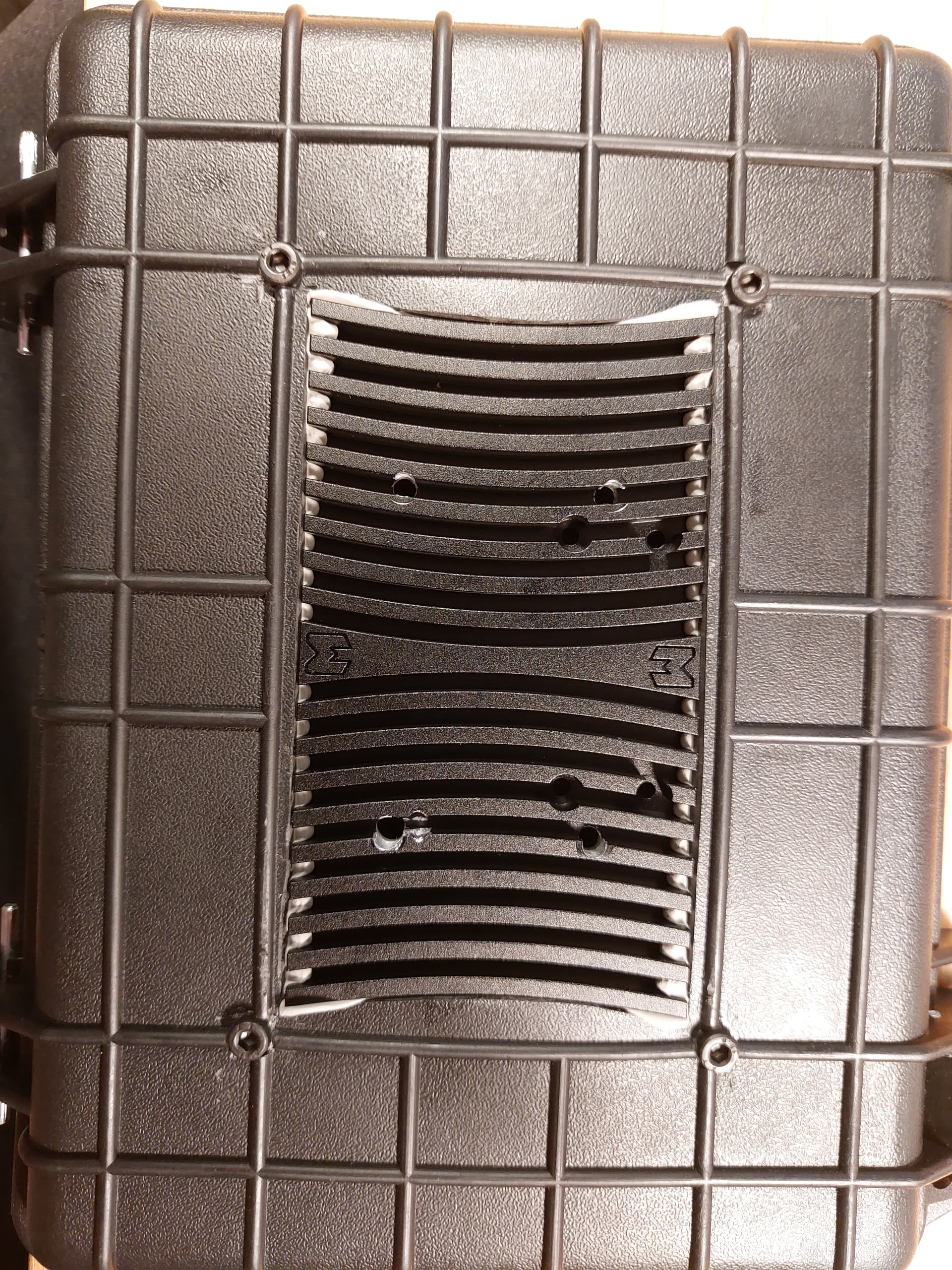

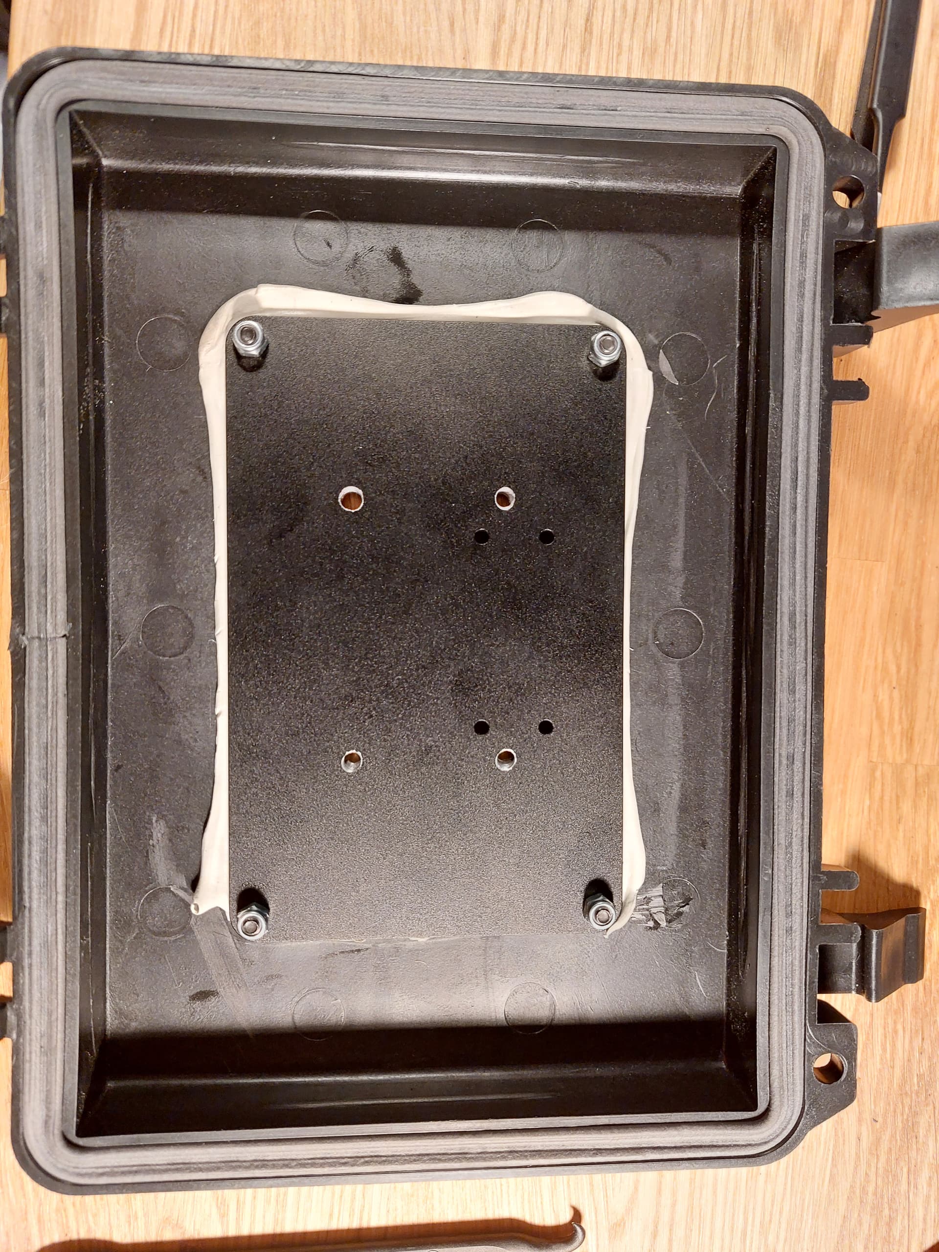

So I have a couple waterproofing questions:

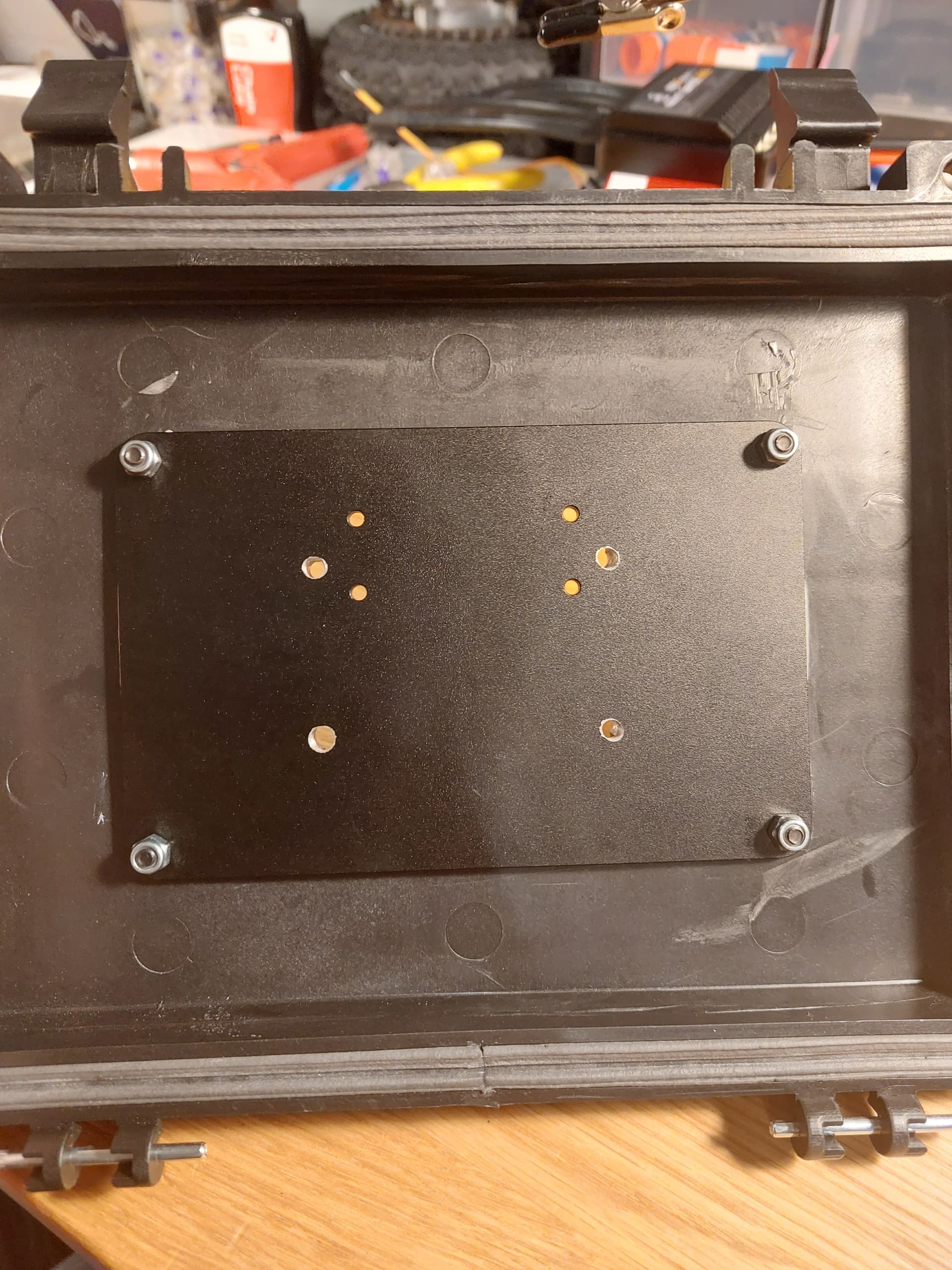

First, I just installed a heatsink into the top of my pelican case lid, put butyl tape around the edges and bolts. Issue I see at the moment is that once I install my ESC there will be the exposed mounting holes from being able to mount another type of ESC. Should I just put a very thin line of butyl tape around the edge of the ESC and call it good? Or will that affect the ability for the ESC to make contact with the thermal paste?

Personally, I’d just fill the holes with some extra epoxy after using epoxy to attach the case and heat sink. Although the enclosure I’m using is cheap enough that I don’t mind destroying it if I ever need the VESC in a different enclosure. If you need the other holes, you can drill out the epoxy from them carefully.
Filling the holes will ever so slightly reduce how well it can cool but I doubt you will notice a difference. Another thing you can do is coat the VESC in conformal coating. Adds extra water proofing but you can still solder it off. Just don’t breathe in the smoke when it burns off unless you hate your lungs.

I would put a grub screw and some Loctite in the extra holes if they’re threaded.
Think I’m gonna end up going with this idea. I think I may have some lying around. Shouldn’t need to worry about the ones threading into the ESC if I use loctite on those as well.
