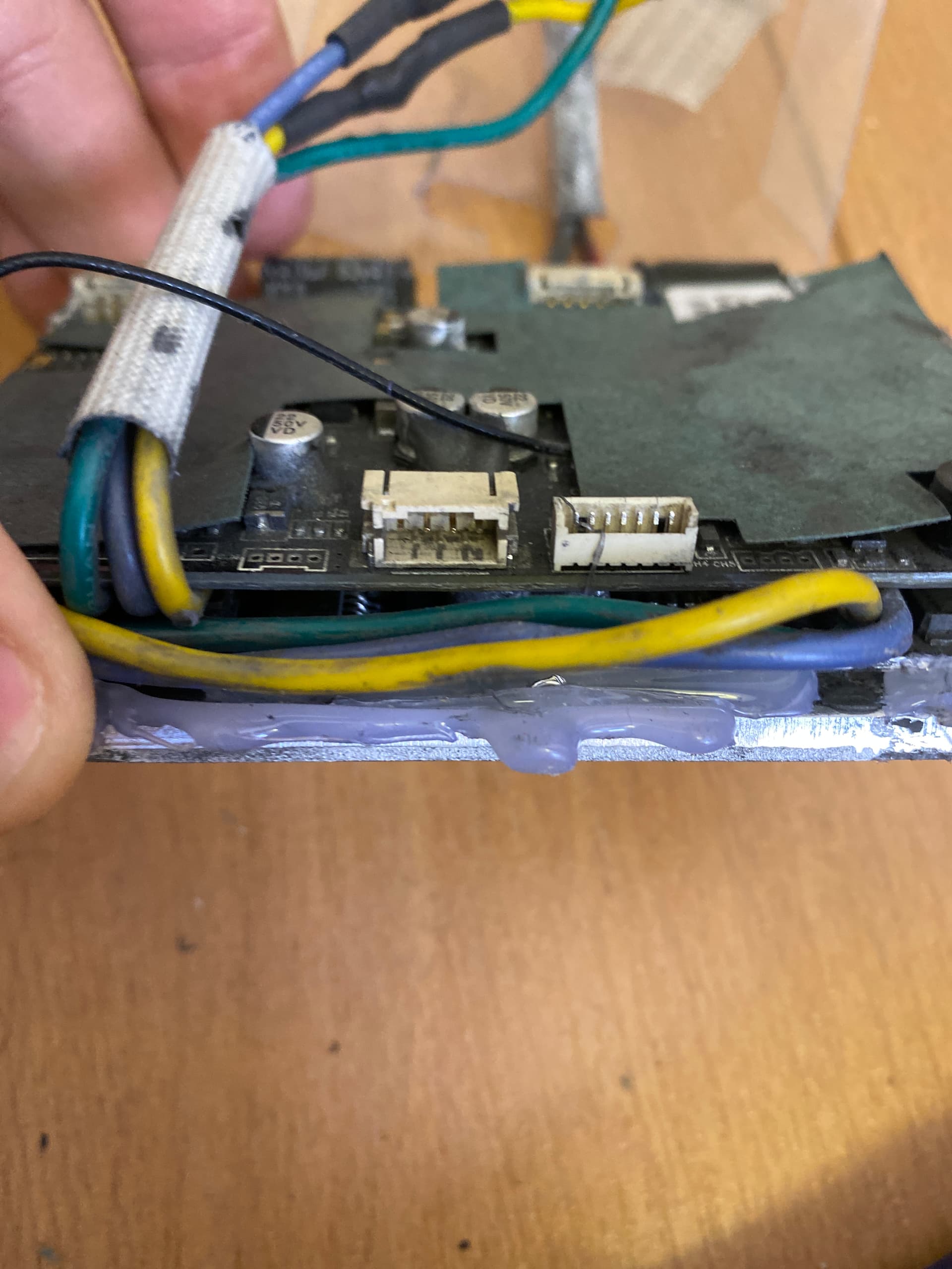

Does anyone know where I can buy this 4 pin header from
It’s for generic esc power buttons
Anyone know which jst and where I can order from in the uk
Caliper the pin to pin distance and you have your answer
My calipers broke
I tested and a davega header fits in it so I thinks it’s 4 pin jst 2.0
Anyone know a place in the uk where I can order a 4 pin header jst 2.0 for pcb (pins coming off the bottom for soldering)
This site has a lot

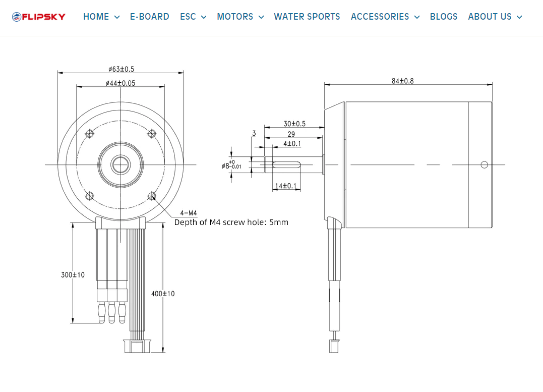

anyone know the distance between the mounting bolts on standard outrunners (flipsky 6384 or something)
try looking on the flipsky page :new_moon_with_face:
It doesn’t show between each bolt
It just shows the diameter of the circle
they are all @ 90 degrees, now u can do the math to know the bolt distance
edit: actually u only need to know radius to know the bolt distance :joy:
Yep just did the math
31mm or so
Perfect
Thank you
I’m lazy, is that bolt to bolt diagonally, bolt to bolt across or bolt to center?
It’s the square made between each bolt
The sides of each are 31.something mm
Thanks, I’m currently trying to model this myself in onshape, it’s a weird cad software.
